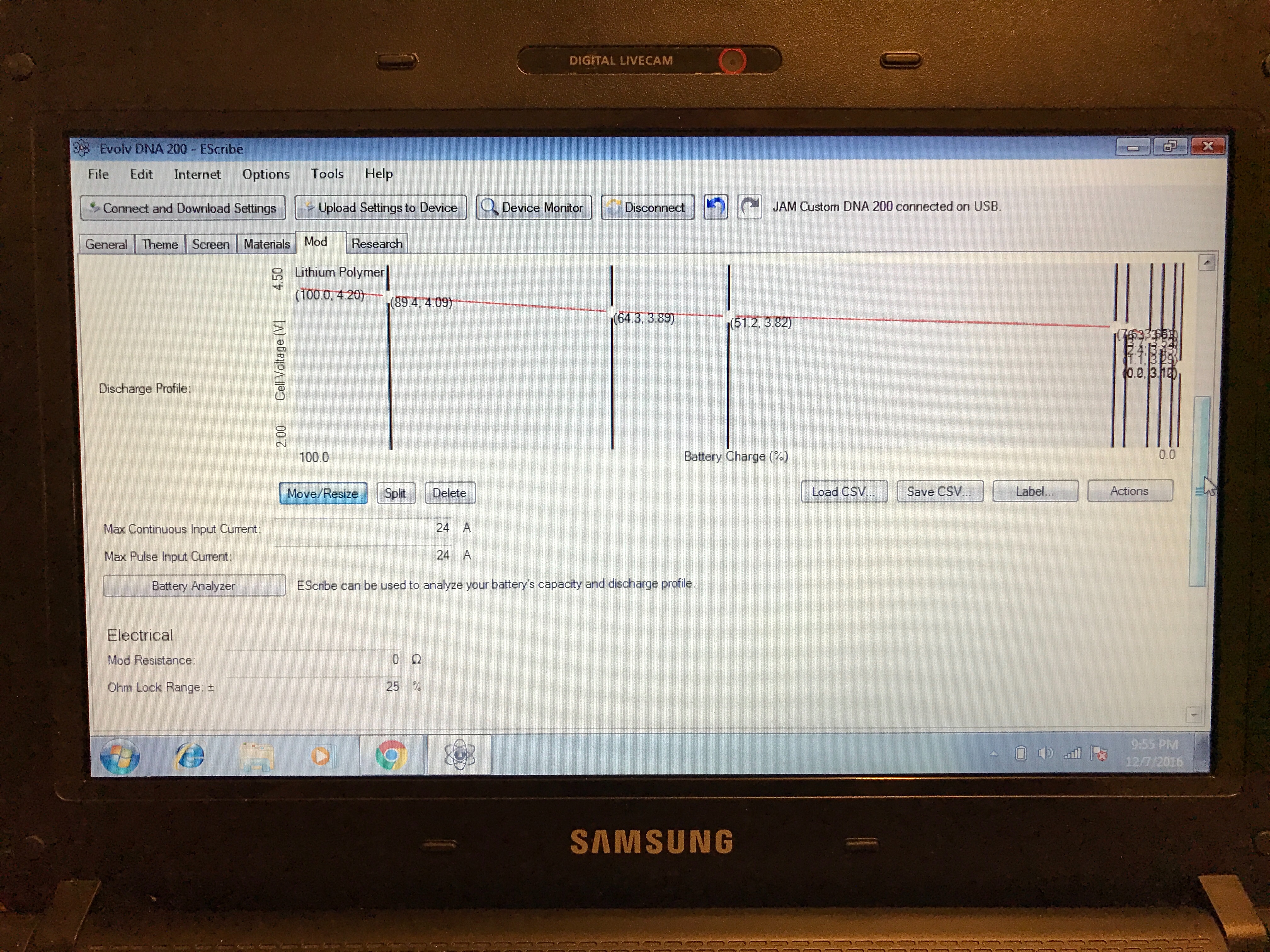

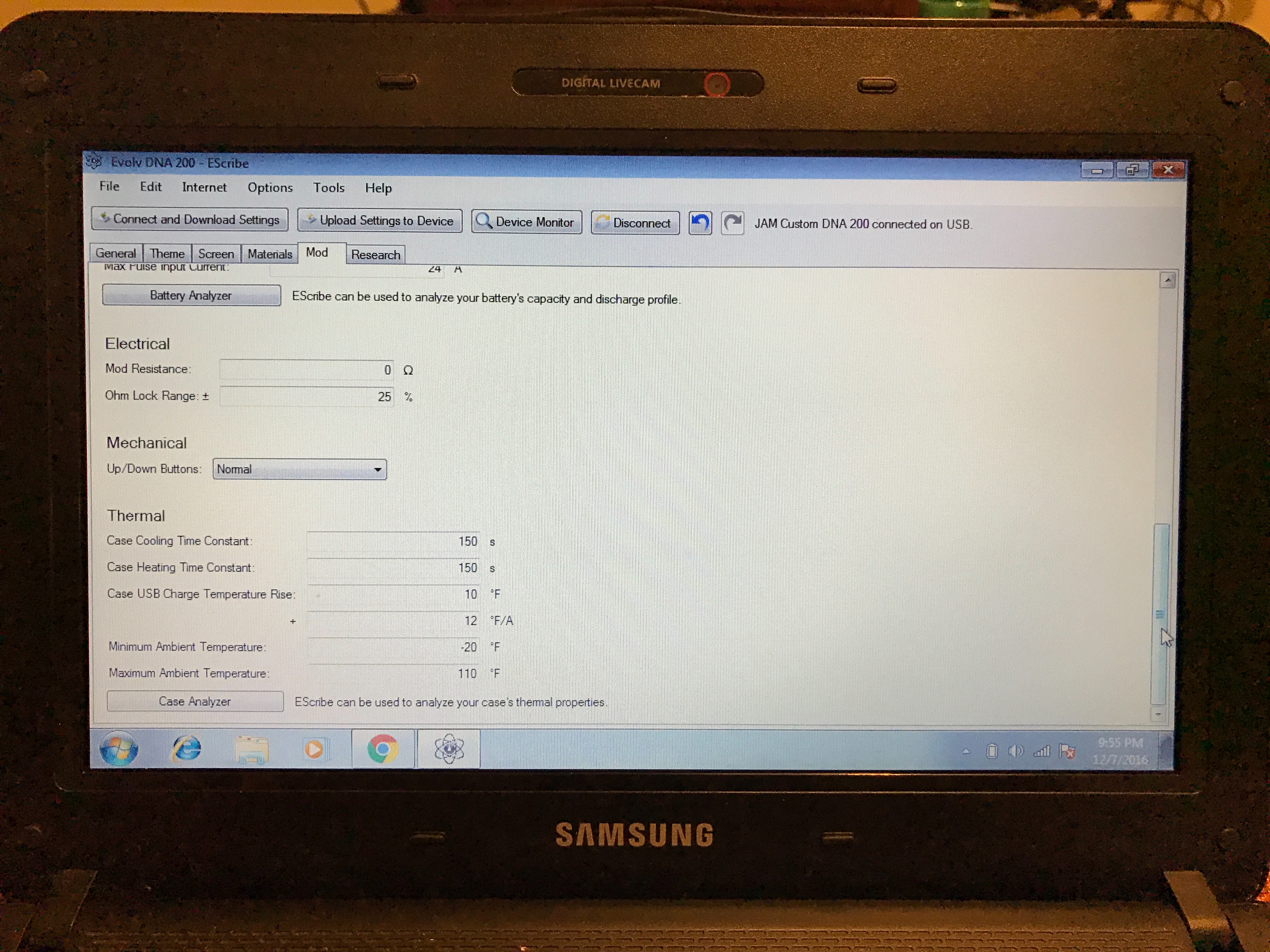

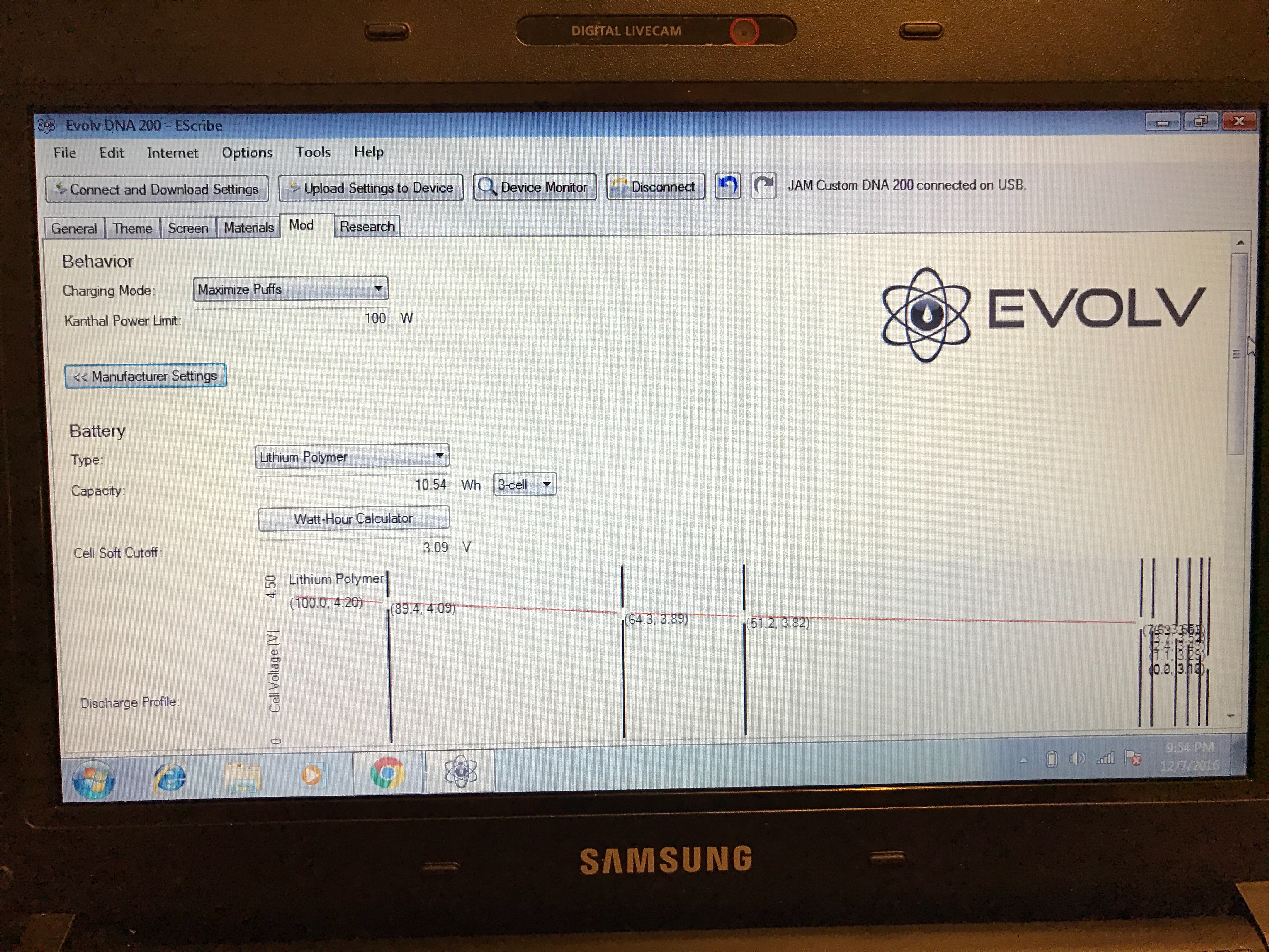

jamtwo Posted December 8, 2016 Author Report Posted December 8, 2016 Thanks for the help, here are a few pictures from the Mod tab (sorry for the multiple pictures, I use a Mac normally so I use a crappy netbook for my Escribe lol). The only thing I changed when I hooked it up besides themes was the what hour calculator, I changed it from 1300mAh to 950mAh.
retird Posted December 8, 2016 Report Posted December 8, 2016 You might try changing the Watt hours to about 9.0 watt/hours. This should help with the battery barâs relative reading.Nothing to do with the battery bar but these thoughts may give better performance and accuracy. Noticed you have the Evolv default values for the rest of the settings. If you want you could run the Case Analyzer and also measure the modâs internal resistance and set the Mod Resistance.

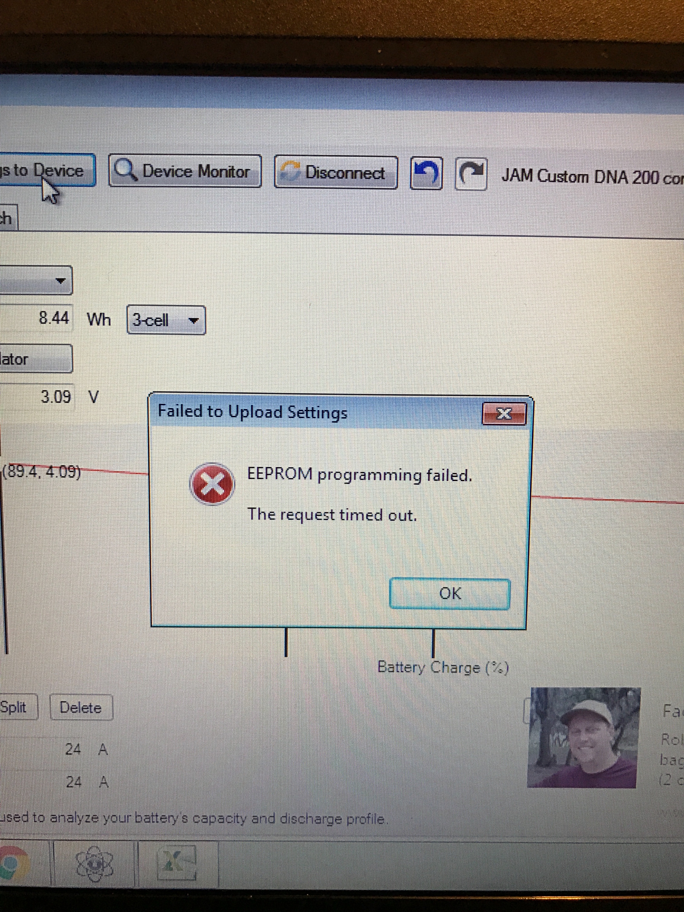

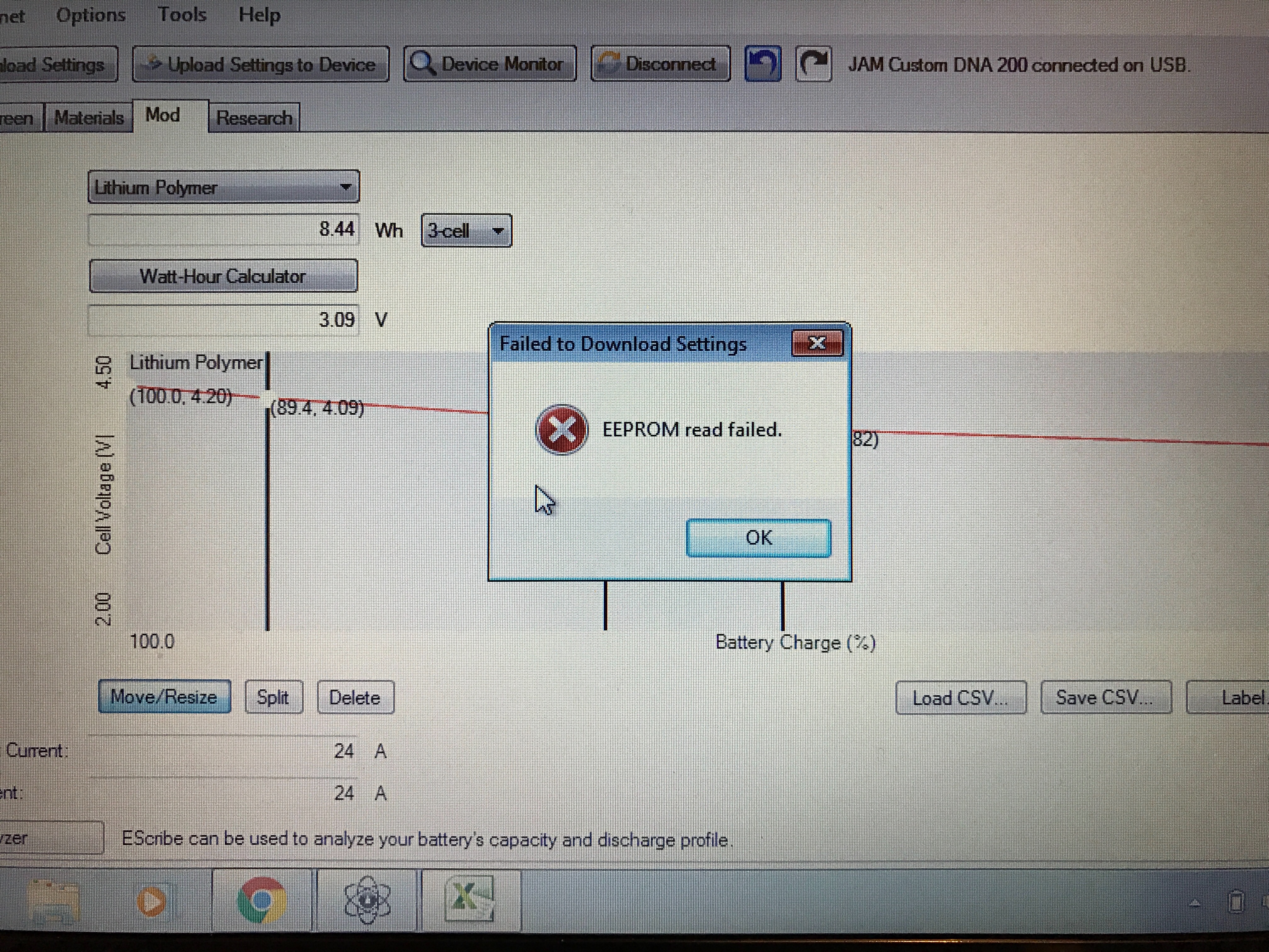

jamtwo Posted December 8, 2016 Author Report Posted December 8, 2016 So, I tried loading a battery csv file for the battery I have installed, and it continuously failed, I then changed my Wh settings, went to upload the settings and now I'm having some issues. Getting these errors. Any ideas?
