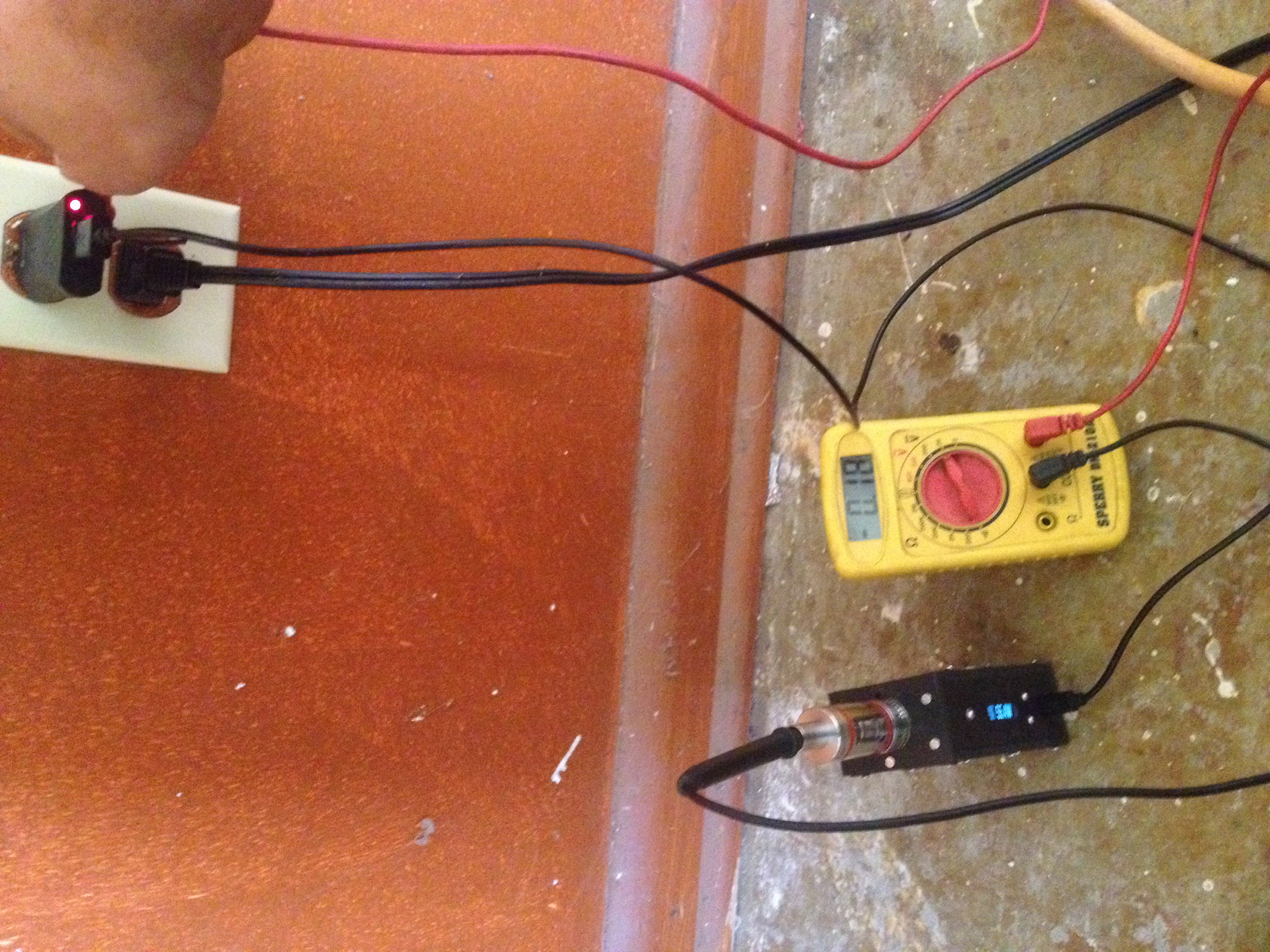

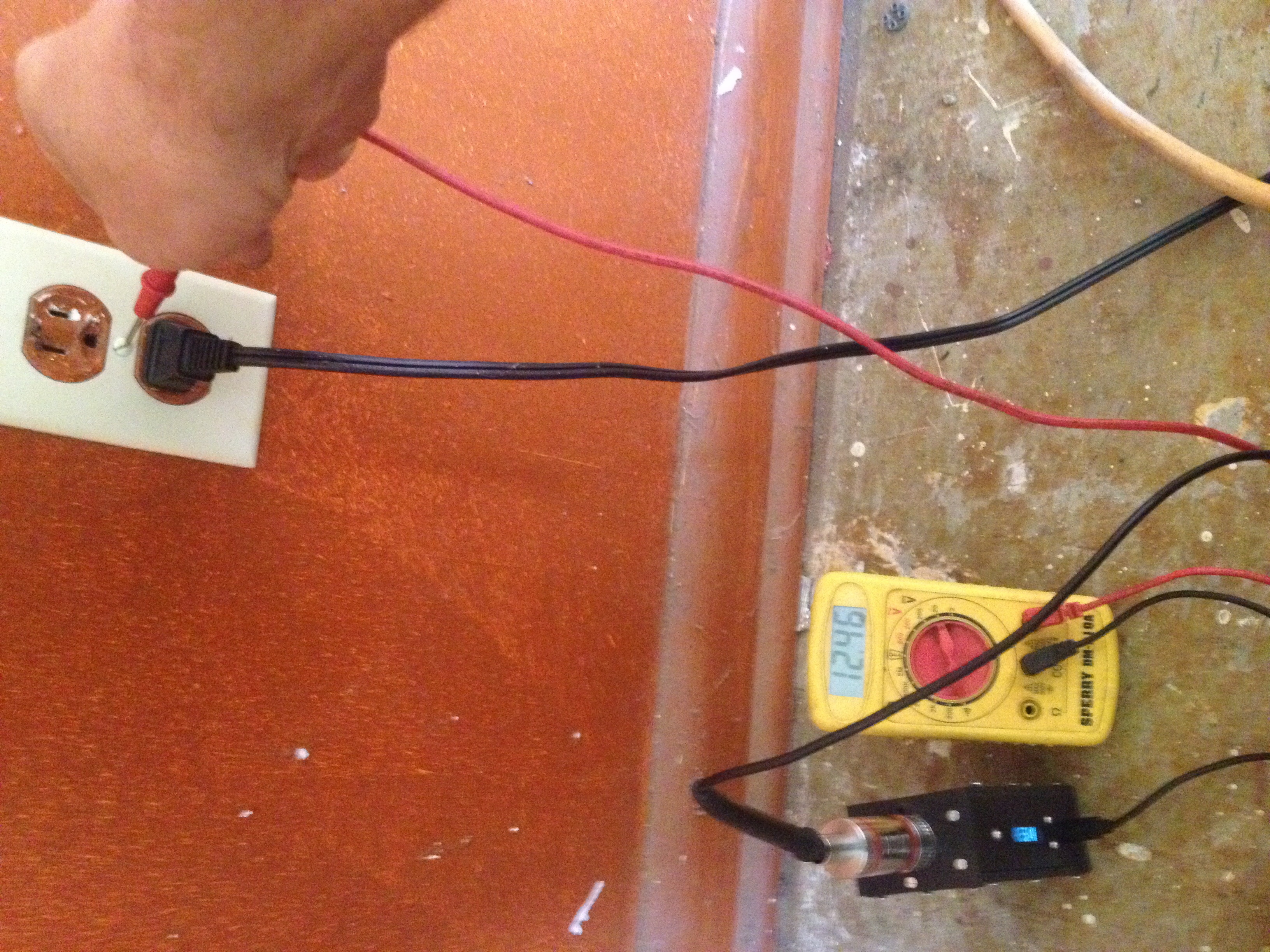

Guest Posted August 22, 2015 Report Posted August 22, 2015 I don't know if this is worth anything but I had some voltage leak when I lightly had my lips on my drip tip it's only a light leakage I had it connected to my PC but when I brought the mod inside from the shop I couldn't feel it I plugged it in to charge and still couldn't feel it it was odd. Buy the way it's in a ABS box
blueridgedog Posted August 22, 2015 Report Posted August 22, 2015 Laguz75 said:I don't know if this is worth anything but I had some voltage leak when I lightly had my lips on my drip tip it's only a light leakage I had it connected to my PC but when I brought the mod inside from the shop I couldn't feel it I plugged it in to charge and still couldn't feel it it was odd. Buy the way it's in a ABS box Vaping or not vaping during the leak?
Guest Posted August 22, 2015 Report Posted August 22, 2015 Not vaping, but I can't tell if there's leakage when I'm vaping I did have the device connected to escribe, Sunday evening I'll try to connect it to my PC and see if it leaks. Like I said, charging from the wall I don't feel it, vaping it not being charged there's no leakage it was odd
Guest Posted August 23, 2015 Report Posted August 23, 2015 I've tracked it to my laptop, that's what's causing the voltage leak, it will leak with the data and nondata usb cables. And it doesn't leak on the wall charger.
blueridgedog Posted August 23, 2015 Report Posted August 23, 2015 Curious if it changes if you ground your laptop.
Guest Posted August 24, 2015 Report Posted August 24, 2015 I'll try plugging my DNA 25 in and see if there's leakage, but why is there 12 volts leaking and not your avg USB 5v leaking. I figured it out it's when my laptop is being charged, when it's running on it's batteries there's no leakage.
