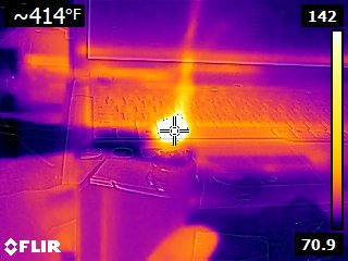

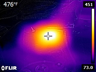

Swerved Posted December 30, 2016 Report Share Posted December 30, 2016 So I was reading over the problems everyone has with SS316L and temp control. I too have noticed that with the temperature set at say, 450F it seems to be a cool and airy vape, like it's not hot enough. So I decided to check it out with my handy little FLiR gun... It seemed to be lower than the set point at first (this was @450F) but I soon realized that it the vapor will throw it off if it's in the area of the focal point... So I set it @ 475F and got close up to the coil, so the vapor wouldn't throw it off... Seemed pretty close then. Oddly enough, at 475 it's a cool vape (IMHO) and that I now see why some folks have theirs set at 500 and above.Haven't tried Ti yet or anything else. Link to comment Share on other sites More sharing options...
VapingBad Posted December 31, 2016 Report Share Posted December 31, 2016 Very impressive results, it is average temp across the coil. SS is the most challenging so your results would only get better, if you are of a mind to play about it may be interesting to see if coils dimensions or resistance have much effect, but only if you want to. What I think is one of the most important things is how stable it sits at a temperature as wire grades could vary in TCR.As for seeming cool, it could be you got used to a mod that regulates less smoothly and/or you need more contact area between the coils and wick (6 turns at 450 F make more vapour than 5), it could also be airflow or wicking, but you would probably spotted those straight away.Interesting post Swerved Link to comment Share on other sites More sharing options...
