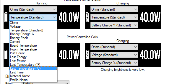

Dan Simion Posted December 7, 2016 Report Posted December 7, 2016 Just got the lost Vape now, struggling to change the display of room temperature and board temperature from Fahrenheit to Celsius on the mod... any clues? Thanks in advance
Wayneo Posted December 8, 2016 Report Posted December 8, 2016 @Dan thanks for making this fun, and welcome to the board.Cool, I love clue games. Here are 3. Are ya ready? The answer you are looking for is in the manual (250 datasheet, which you should read)It's on a Page # higher than 3, and less than 5. https://downloads.evolvapor.com/dna250.pdfIt might just be, ............... (no using the dictionary), the penultimate paragraph.Your turn to guess. Nice mod.
Dan Simion Posted December 8, 2016 Report Posted December 8, 2016 Well thanks Wayneo but as earlier stated not the coil temp that bothers me, the small readings next to the battery icon on the left, room temperature and board temperature during charging, they still remain in Fahrenheit no matter what...any clue to this issue? Can't find any answer in the manual...
r5ta Posted December 8, 2016 Report Posted December 8, 2016 scroll down past 200f to get it into celsius for temp readout and for the ''small readings'' choose them from the drop-down menu
Dan Simion Posted December 8, 2016 Report Posted December 8, 2016 Yeah I have scrolled down, but for the small ones if room temperature or board temperature is selected it will only display in Fahrenheit... only last temperature has the option of F/C...
r5ta Posted December 8, 2016 Report Posted December 8, 2016 As far as I'm aware the options I stated are the only ones that can be changed to celsius
Dan Simion Posted December 8, 2016 Report Posted December 8, 2016 Yeah, should not be so difficult to program the unit to Celsius... where can I address the issue? Maybe they can fix it on next download...
retird Posted December 8, 2016 Report Posted December 8, 2016 As you probably know in EScribe Device Monitor you see Board and Room Temperature in Celsius....but you want it on the device display..... so....You could offer your thoughts under the "Suggestions" heading at Evolv Help Desk "ticket process".... here is a link....https://helpdesk.evolvapor.com/index.php?a=addAlso James from Evolv reads some posts here and he may well have read yours.... 1
