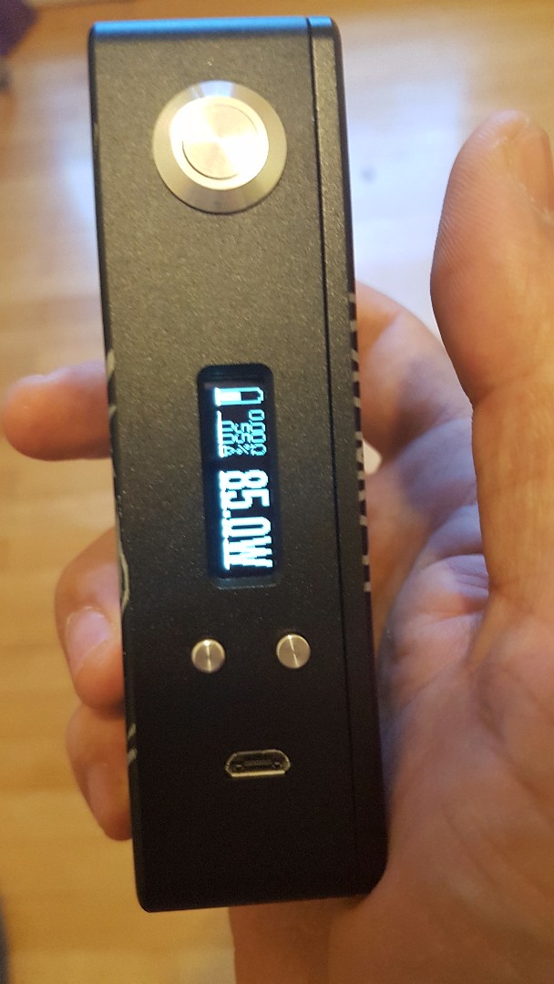

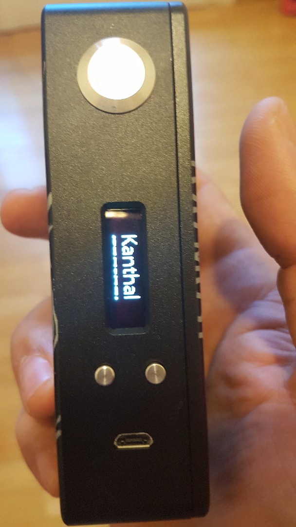

Hello all. So here's my case.A relative of mine living in the US was travelling to Europe (Greece in particular),so i grabbed the chance and ordered a mad modder dna 250 2250mah box.About a month later (late December 2016) i had it in my hands.Worked great until today.Suddenly the bottom of the screen has lines/dots,looks like mors code.These lines/dots are all more luminous than the rest of the screen.I am attaching 2 pics. Ps. Since i live in Europe,it would be a pain to send it back,so any idea/solution that i could pull off would be really welcome. Thanks

hum.....  any suggestion except doing a soft or hard reboot (save .ecig file first) would involve opening up the device (voiding the warranty). The issue could be as easy as replacing the display, making sure the ribbon connector is properly engaged, checking the ribbon cable for damage by being to close to the fire button, and etc.  It might be good to contact MAD Modder first and explain the issue.  They may guide you a bit and/or ask you send the device to them for warranty.  I just read their warranty and got their contact link. Here is their warranty info and contact link:

Thanks for the quick reply.I have already contacted mad modder about my issue,he said that it appears to be a defective screen and to send it back for replacement.I asked him if he will cover the postal charge from USA to Greece and I'm waiting for a reply.For me to send it back,will cost something like 60 bucks :-((

@morphflow if you find it's not worth it after speaking with Madmodder, order yourself a replacement screen ($12 USD here), and try to do it yourself. Screen replacement, after getting to the board itself, is at most a generous 1 minute job. Lift tab, pull out old screen's wire, insert new cable, push tab down, reassemble mod. Or find a hobby/electronics repair that would do that for you locally.
