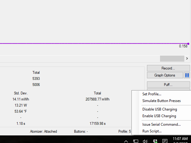

Posted
dwcraig1 said:
In the lower right hand corner of Device Monitor in EScribe there is the "Diagnostics" tab, there you will find "Reset USB current limit".
That option isn't available on the 75...
Posted
@sams......if you watch your battery line, in Escribe's device monitor, you should see the voltage "blip" (move slightly up, around 0.01v's) if you click between "enable and disable USB charging." this should tell you whether or not the charging IC is activating or not. or find and inline USB meter like i have. that's a sure fire way to tell if you're drawing any current.
if you select this option this will also turn OFF you USB charging capabilities.
