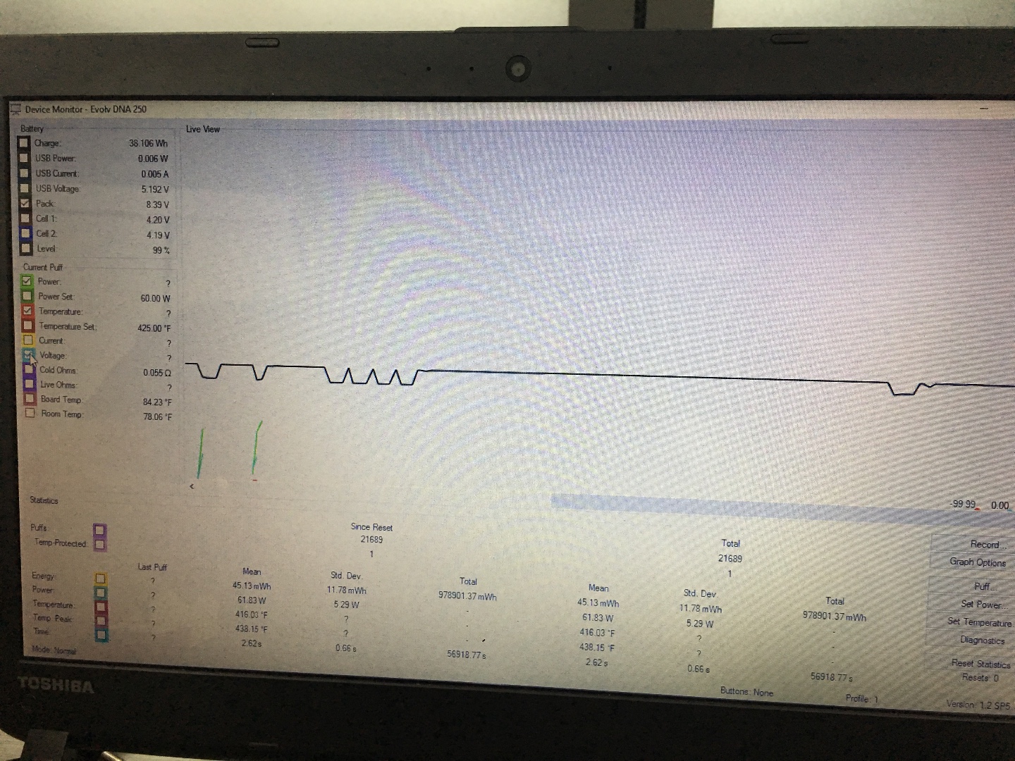

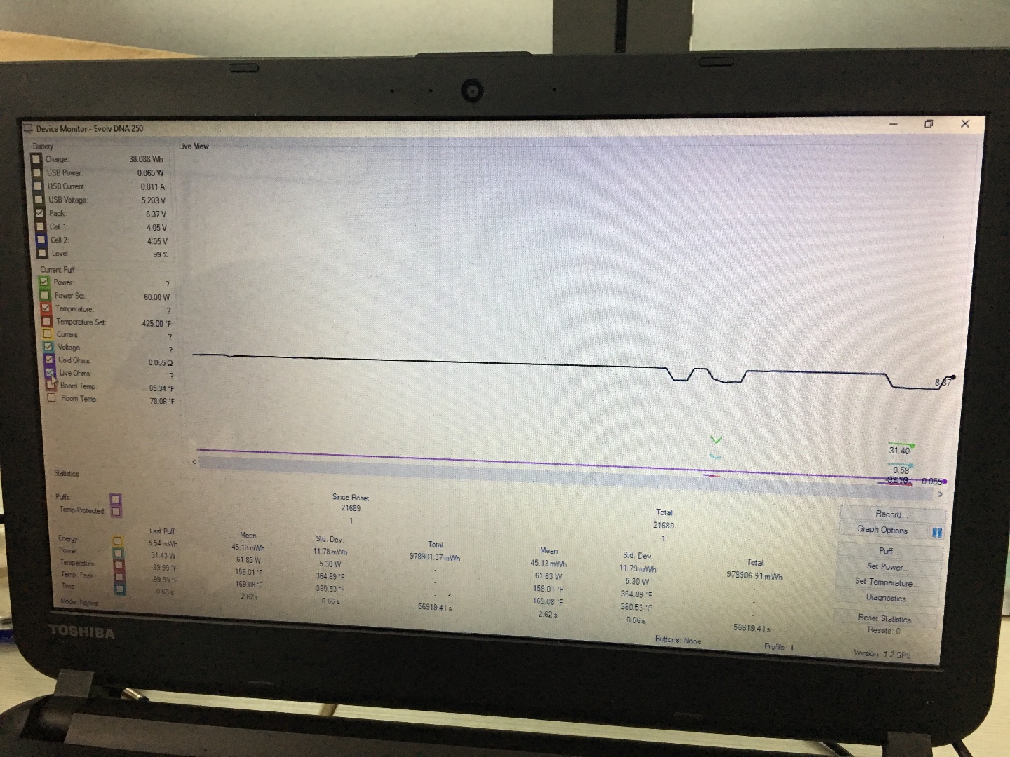

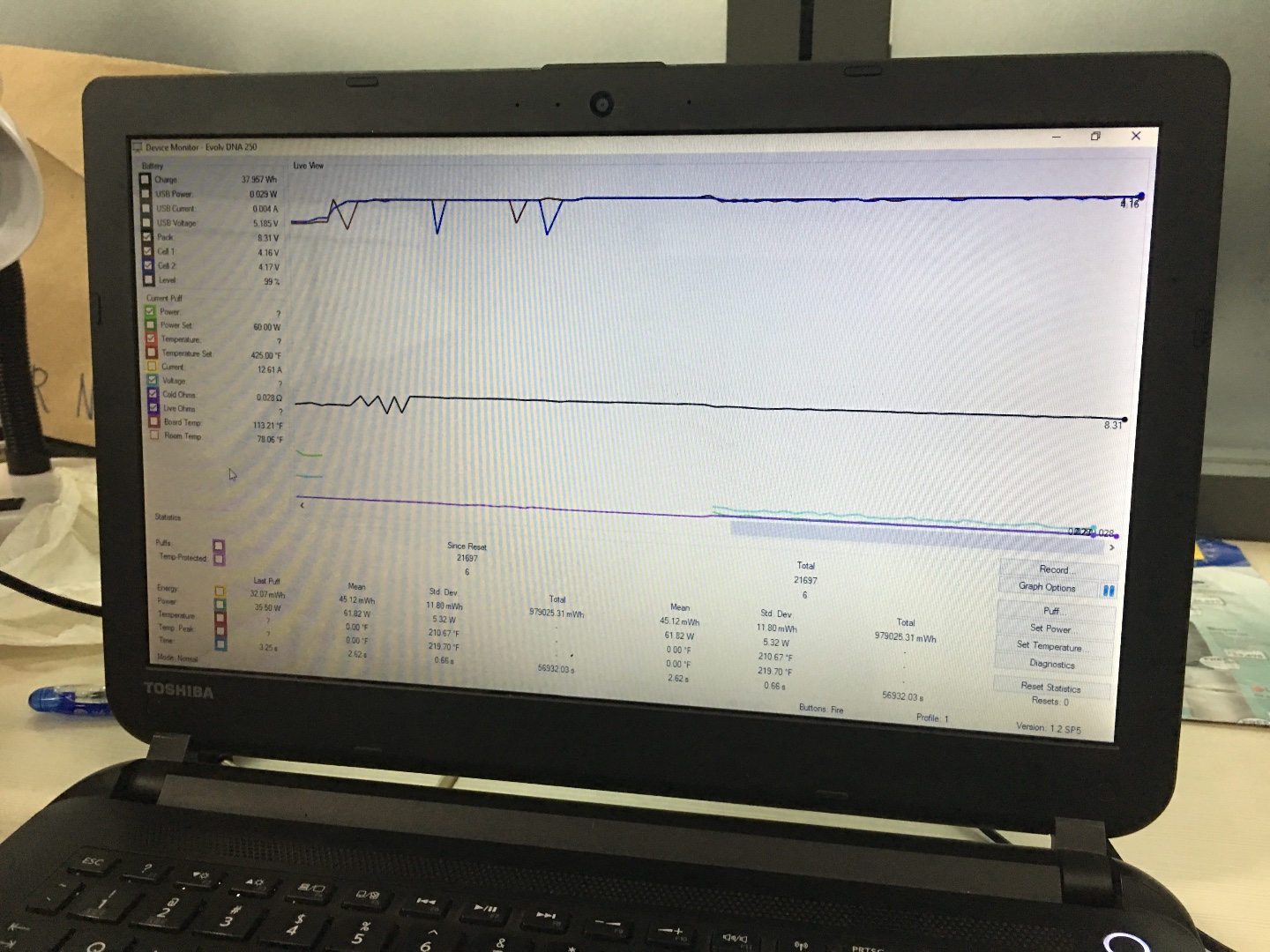

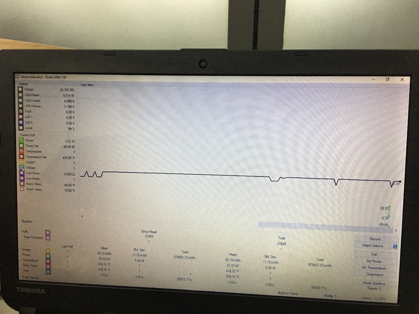

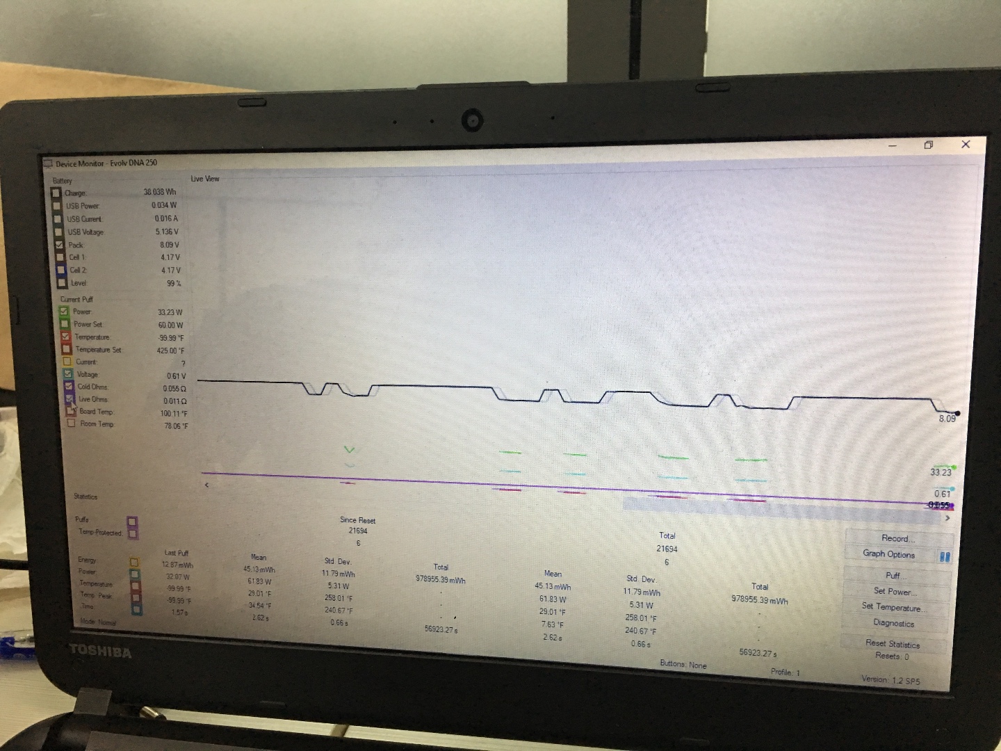

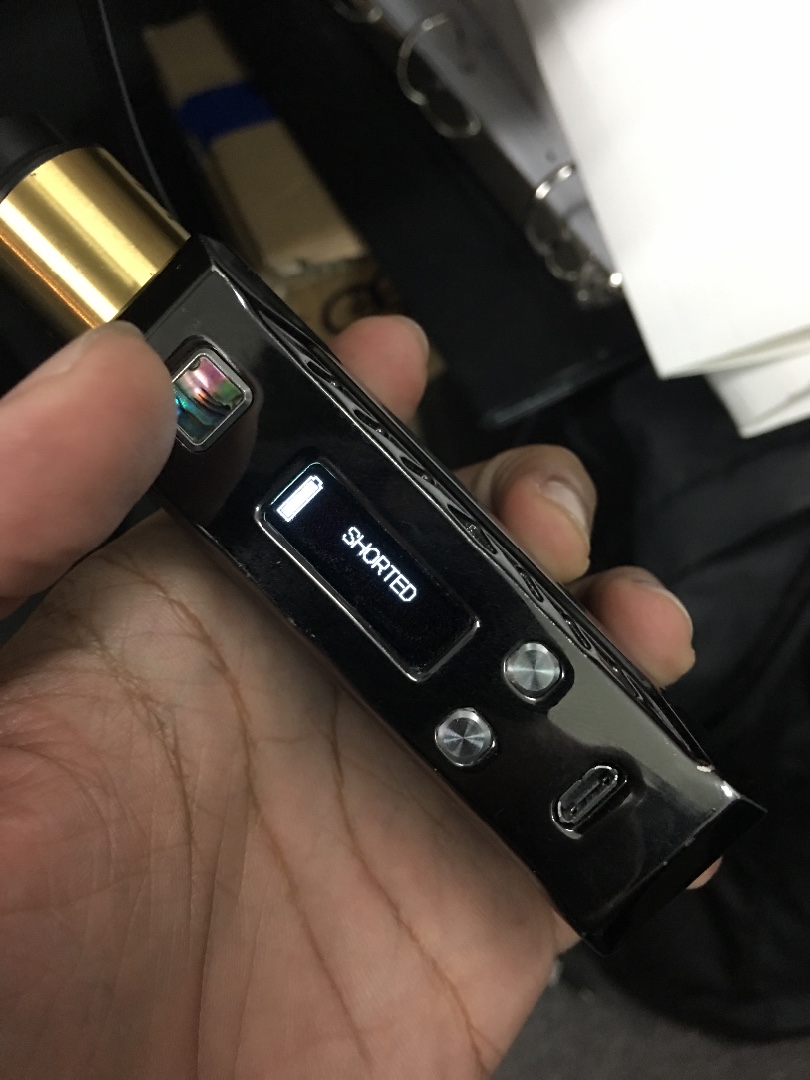

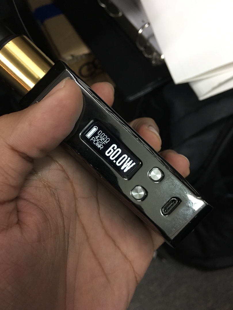

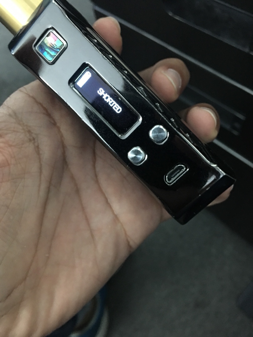

gabbcruz11 Posted February 25, 2017 Author Report Posted February 25, 2017 Guys what should I do my vape showing on the screen "SHORTED" I already clean the 510 connector but still showing SHORTED. Is there any suggestions that will make it work? I'm using a finder167 by thinkvape dna250 and been using it for a months ago. Thanks.

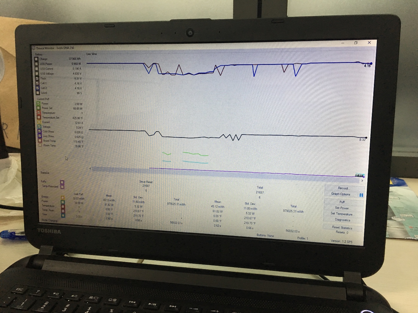

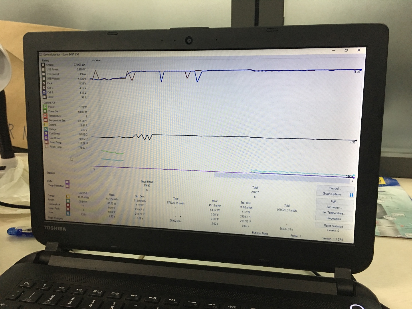

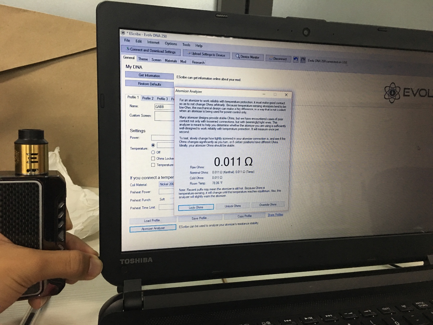

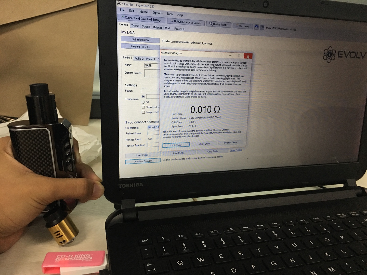

Spector NS5 RD Posted February 25, 2017 Report Posted February 25, 2017 try a hard reboot from EScribe first. if that doesn't do it, try re-flashing the current firmware. if that still doesn't fix it, take a look in atomizer analyzer and take note of any resistance readings with no atty on and with a few different ones on. this will determine if it's atomizer side short or not. it displays shorted with or without an atty? if you want, post a screenshot of device monitor with the battery option boxes ticked and cold, live ohms boxes ticked. try firing an atty and post those screenshots.i'm deleting your duplicate thread.
gabbcruz11 Posted February 25, 2017 Author Report Posted February 25, 2017 It display with an atty. i tried using another different atty but still the display says "shorted". I will try the hard reboot and will update you if it work or no. Thank you very much I appreciate your advise.

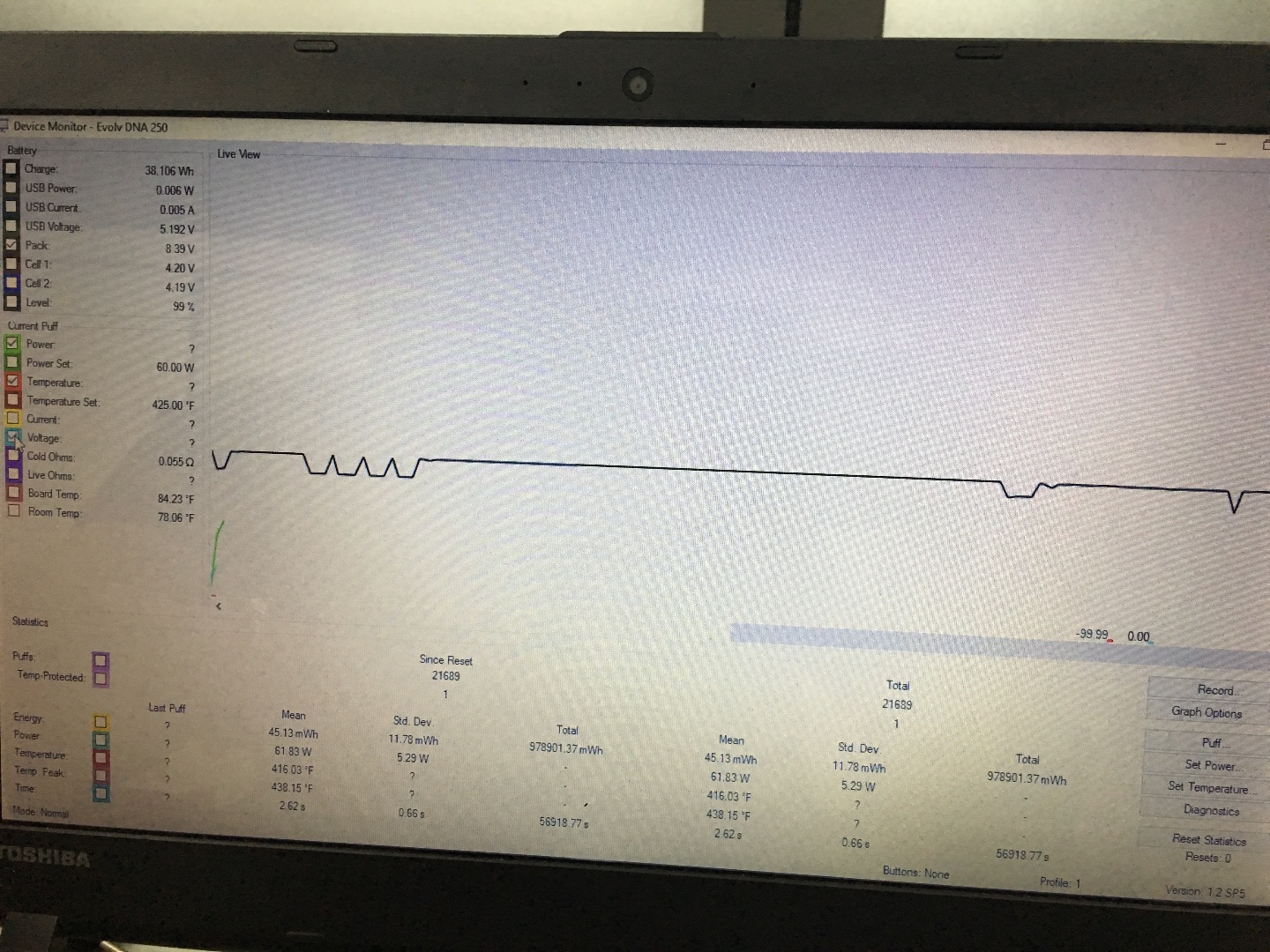

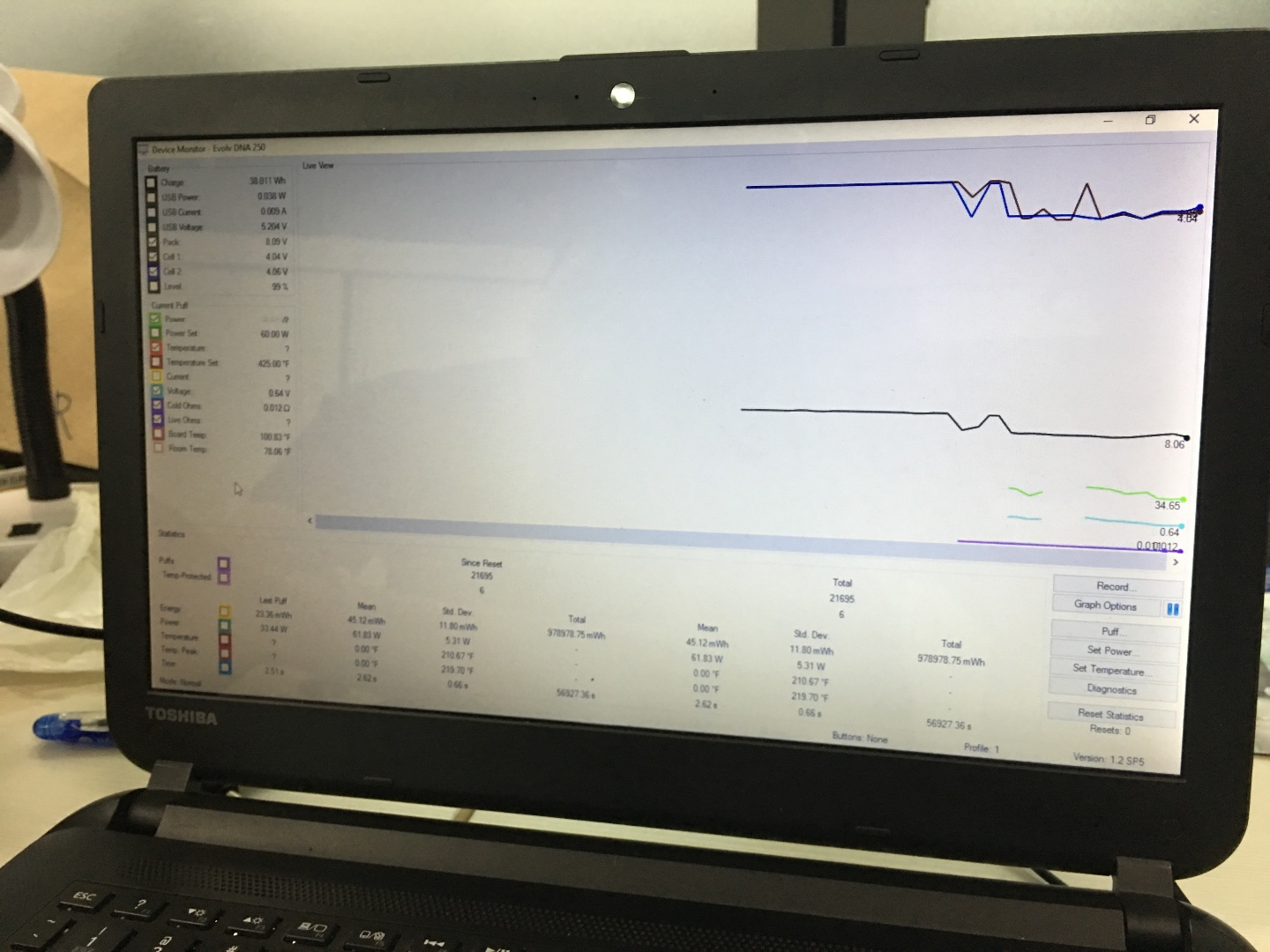

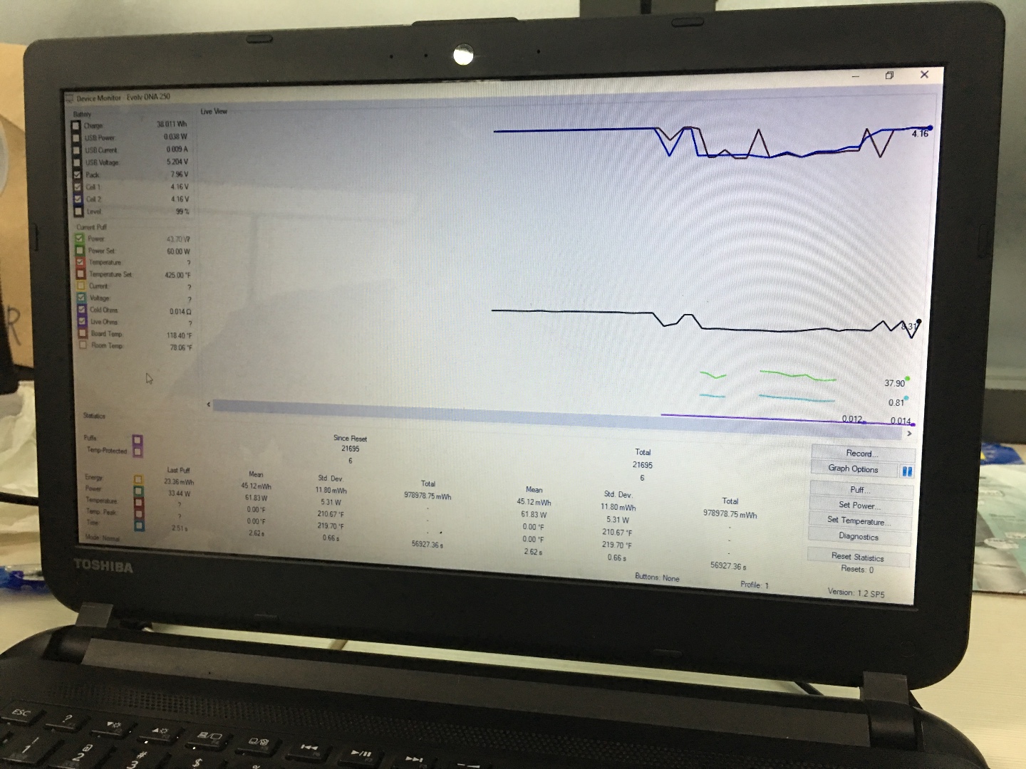

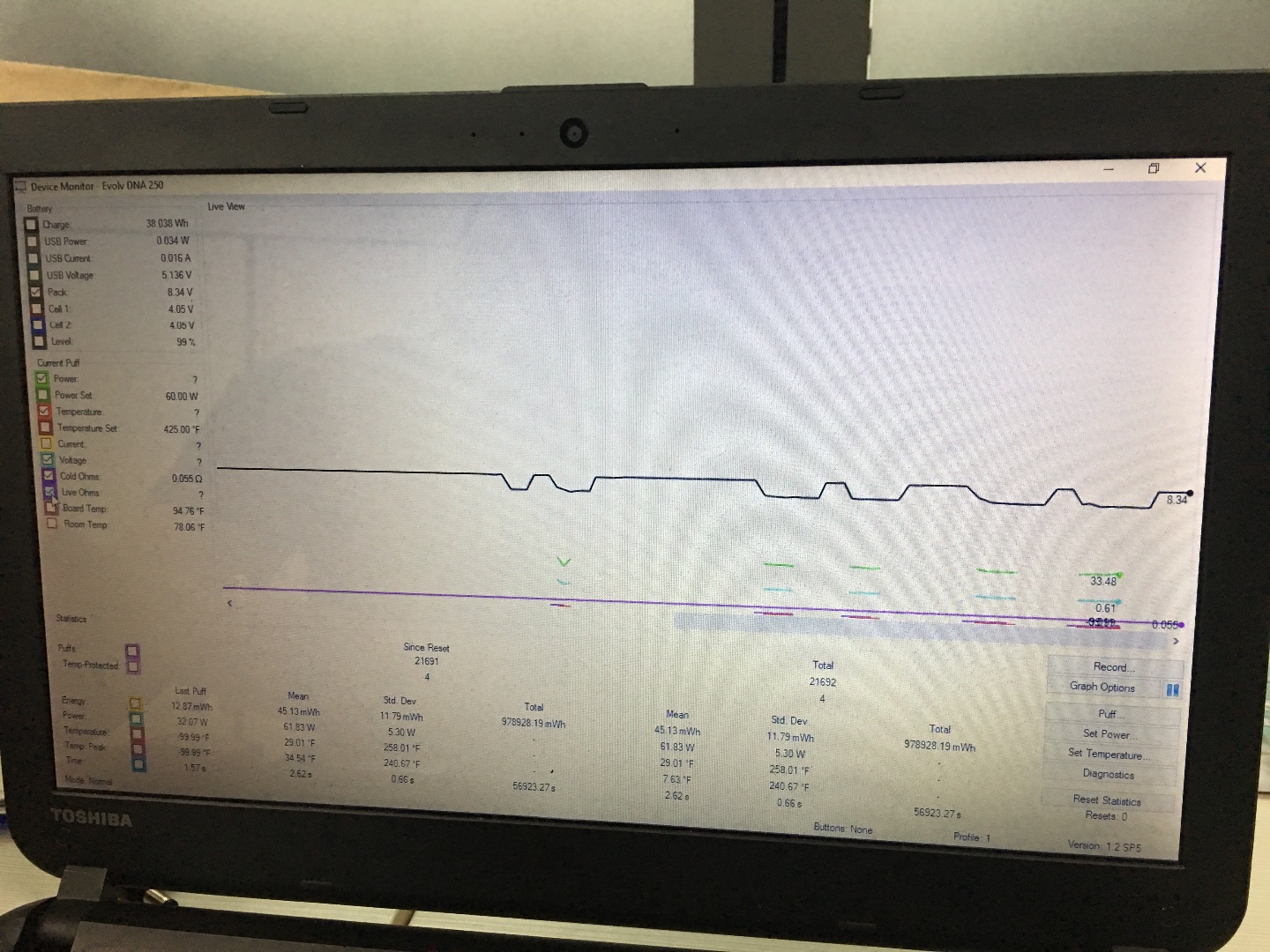

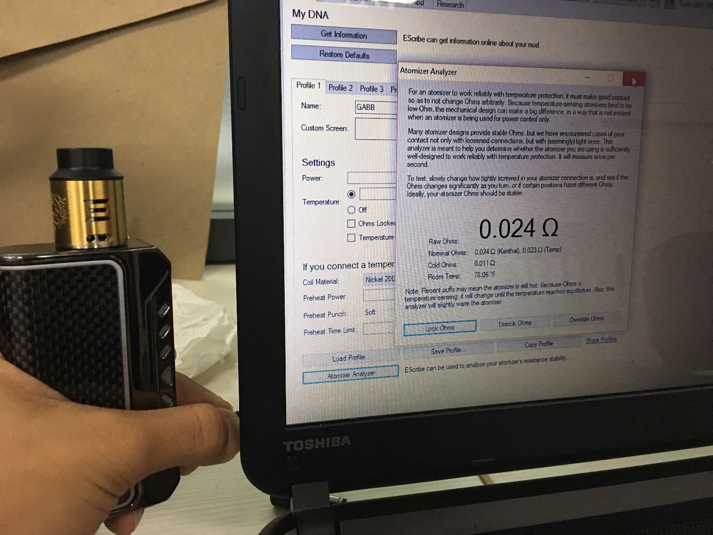

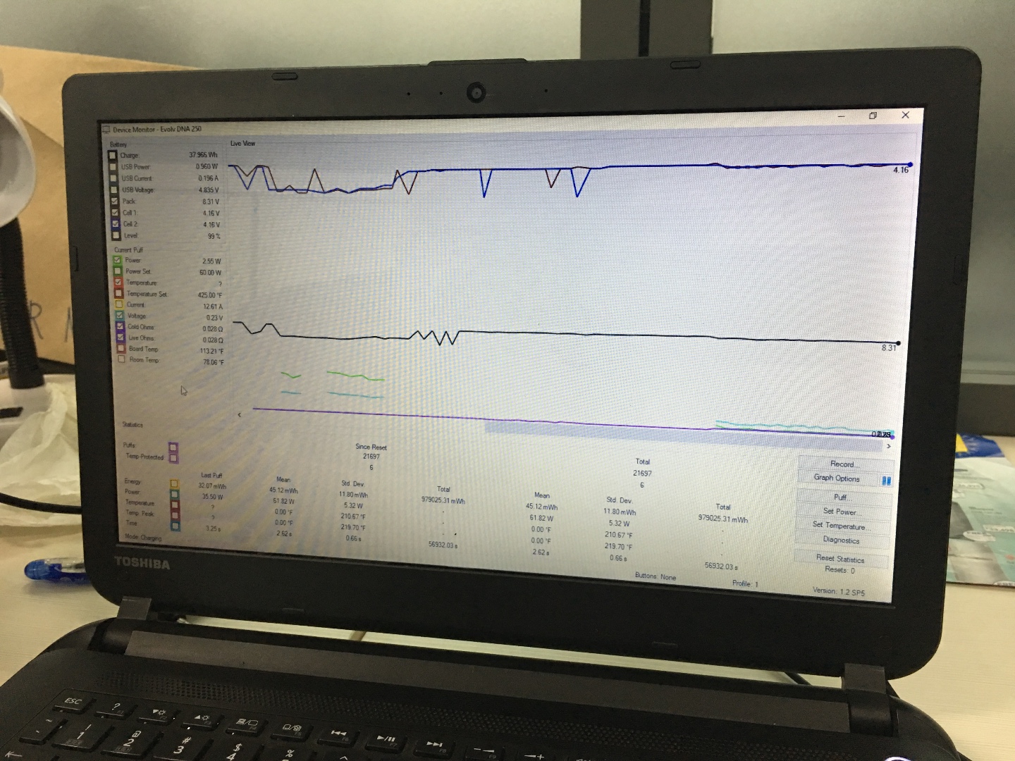

gabbcruz11 Posted February 25, 2017 Author Report Posted February 25, 2017 ChunkyButt200 said:try a hard reboot from EScribe first. if that doesn't do it, try re-flashing the current firmware. if that still doesn't fix it, take a look in atomizer analyzer and take note of any resistance readings with no atty on and with a few different ones on. this will determine if it's atomizer side short or not. it displays shorted with or without an atty? if you want, post a screenshot of device monitor with the battery option boxes ticked and cold, live ohms boxes ticked. try firing an atty and post those screenshots.i'm deleting your duplicate thread. This I tried hard reboot then nothing happened. Still "shorted" I tried the atomizer analyzer(please look at the pictures posted for reference) I used 2 different atty. and I tried the device monitor and look also the pictures for reference.

Spector NS5 RD Posted February 25, 2017 Report Posted February 25, 2017 gabbcruz11 said: This I tried hard reboot then nothing happened. Still "shorted" I tried the atomizer analyzer(please look at the pictures posted for reference) I used 2 different atty. and I tried the device monitor and look also the pictures for reference. it appears from looking your photos, the device is trying to fire your build. i doubt you are actually using a .01 or even .02 coil. could be your 510 and/or 510 wiring. if this is happening with any atomizer installed, i would contact Thinkvap and ask what their warranty repair process is like. evolv warranties the board for one year. you can open a help ticket with them and explain your situation. other than those two suggestions, i would have you open up the mod and post pics.
