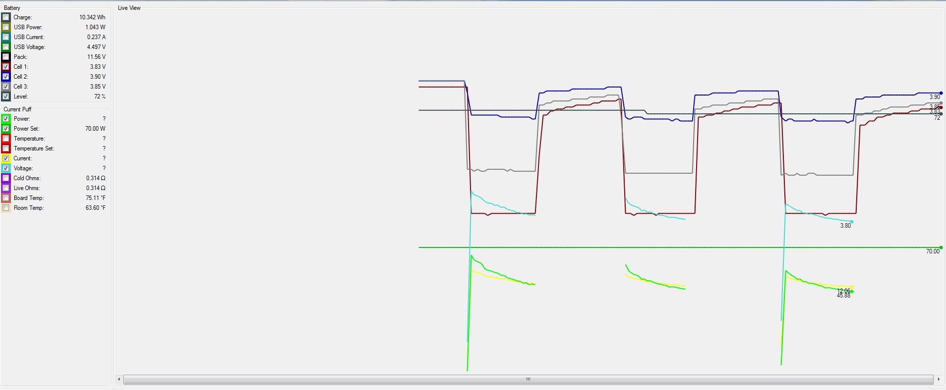

Wayneo Posted February 28, 2017 Report Posted February 28, 2017 What kind of Mod?What kind of Battery (detailed)?Device Monitor Print Screen, (not crooked cell phone pic)of when you see this occurring.
ravin187 Posted March 1, 2017 Author Report Posted March 1, 2017 Wayneo said:What kind of Mod?What kind of Battery (detailed)?Device Monitor Print Screen, (not crooked cell phone pic)of when you see this occurring.sorry all very important thing missed!lost vape efusion duo.battery is fully max 1300mahhard reboot sometimes fixes it but seems to NOT happen when battery is >80% full. I have done the usb recovery charge and that doesn't seem to have fixed it.your input is VERY appreciated.
dwcraig1 Posted March 1, 2017 Report Posted March 1, 2017 It looks to me that the battery is no good.Cells 1 & 3 show excessive sag under load.
Wayneo Posted March 1, 2017 Report Posted March 1, 2017 @dwcraig I believe has hit it on the head. However for your issue 1, was this fine at one time. Either way, it still looks like time for a replacement. I'm glad you didn't take offence to my post, but it just makes everything much easier. If you're not hindered by the dual 18650 limitations, you'll get longer run time till you get a new Lipo. That's still one of my fave 200's that I own.
