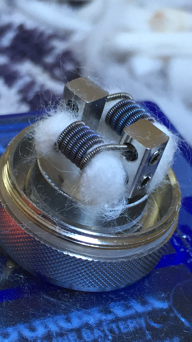

Wow great stuff here Jaquith,  im currently using your 3.5 profile running my goliath v1 with triple twisted 28awg ud 316l wire dual coil wrapped around a 3/32 drill bit.  comes out to .173 ohms and running at 400f with no preheat.  So amazing.  best vape from a tank ever.  great stuff you got here and thanks so much for all the info.

can you post a pic of that
