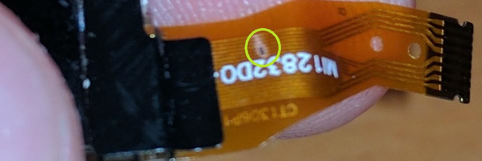

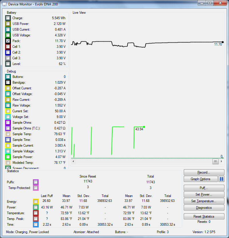

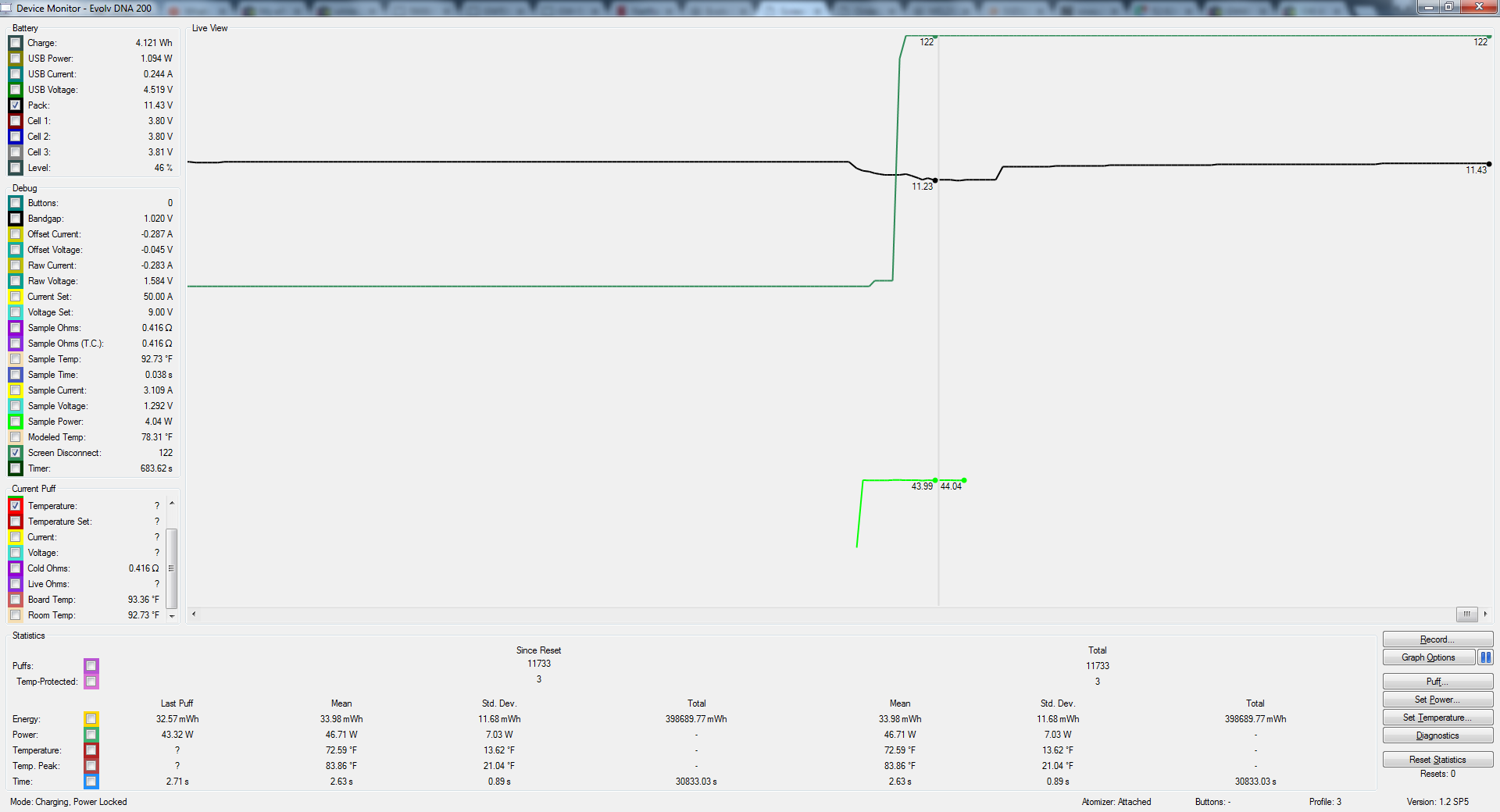

Jonnyw2k Posted March 12, 2017 Author Report Posted March 12, 2017 Hi,I think my screen cable is on the way out (noticed that the screen wasn't updating properly) so found the extra debug menu, and thought I would check the disconnects. While taking a puff it jumped from 54 to 122 just thought I would point it out. Also is there anything I can do when installing the new screen to protect it from getting killed by the firebutton again?Cheers
VapingBad Posted March 12, 2017 Report Posted March 12, 2017 If the screen cable is not catching on the fire button it could be dirt, worth disconnection and giving a quick wipe with IPA or contact cleaner. If the screen needs replacing all you need to do is keep the cable clear of the fire button, you can bend it round a wire or credit card, don't bend it repeatedly in the same spot and not within 1 mm of the glass. You can fold the cable, but IMO bending is a bit safer.
VapingBad Posted March 12, 2017 Report Posted March 12, 2017 ??? someone nicked all the gold (Cu Ag plated) off the end of that cable, I have one in my hand now and can't understand how that could happen, Evolv will probably do you a replacement screen under warranty, go to the main sire and open a ticket + include the photo.
Jonnyw2k Posted March 12, 2017 Author Report Posted March 12, 2017 The end is fine, just strange reflection lighting, I've circled the issue:
Jonnyw2k Posted March 12, 2017 Author Report Posted March 12, 2017 So I wrapped some tape round the exposed metal on the ribbon cable in case it was just shorting and not actually broken (and to add some strength to the cable if its bending too much).Appears to have fixed the screen disconnects: My post originally was meant to be about the erroneous count number (jumping from around 50 to 120) though, not the fact I was getting disconnects.
Wayneo Posted March 12, 2017 Report Posted March 12, 2017 @jonnyw2k Those screen disconnects count every single time it's encountered, and resets itself to zero IIRC upon removing the batteries or a stats reset (old and can't remember). I can go weeks with 0, then a rash of them, then back to zero. The count is not erroneous.
