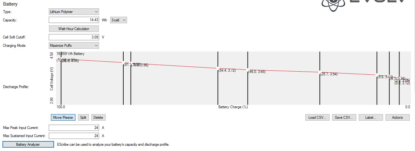

When i connect device to Escribe , and going to device monitor i saw that problem:
On cell 3 , at 25%, is always less more than cell 1 & 2.
So any one could tell me what happen with my dna.
Thank alot
@lawtran I'd suggest you run your own battery analyzer on that mod. For starters you've got 14.43 Wh's as your capacity, yet your battery curve is showing 16.6Wh battery. Easy to do, nothing special needed ..... just a bit of time. OR, just lower your Wh's

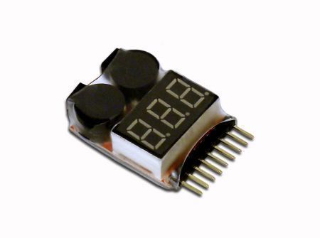

Actually , i have a mainboard read detail of lipo battery !
By this , i could read total volt of lipo , volt each cell!

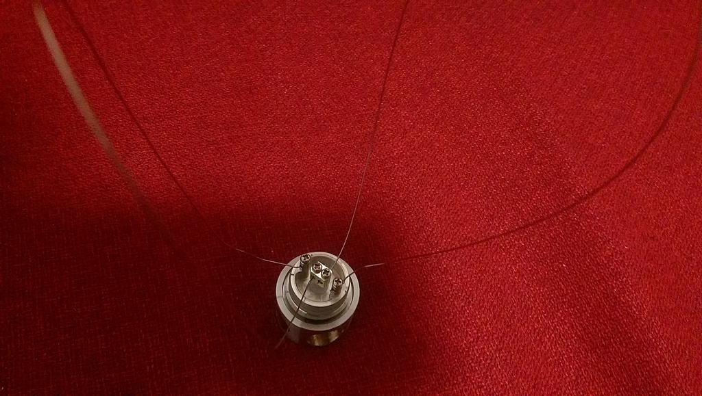

Sorry...See if you can get the idea with this picture...as Wayneo stated,if you search 'Battery Analyzer' on this forum, there is a lot of info about it...

Draining uneven like that indicates a problem with the battery.
If they drained evenly when still new then cell #3 has become weak.
If new then cell #3 is either not been matched with the other 2 cells or the above.
There isn't much power left once a Lipo hits 3.4 volts (unloaded)
dwcraig1 said:
Draining uneven like that indicates a problem.
so this sound like i need purchase a new battery ?
If this problem only surfaces when the cells are below 3.6 volts unloaded it doesn't seem to be all that big of a problem (at least to me)
It's really hard on the cells to discharge them all the way down, you might consider charging sooner.
As the pack ages this is the kind of things that one starts to see, a new pack? Probably.
You hitting the cell soft cutoff resulting in the "check battery". I don't recommend lowering that, 3.09 is good.
Adjusting your curve and watt hours my get you closer to showing 0% when it's that low.

I try to use lipo battery low volt test reader buzz and get this result when battery fully chager :
total: 12.1
# 1: 4.02
#2: 4.02
#3: 4.05
I think i should use battery analyzers on this night to to get watt hour closer to showing 0%.
