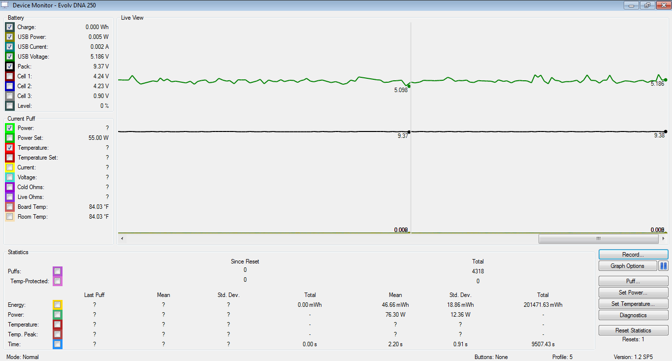

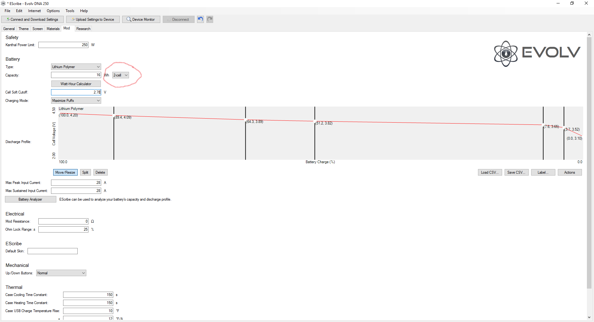

giz_60 Posted March 16, 2017 Report Posted March 16, 2017 It is showing '3' cells on your Device Monitor & the Therion only uses 2...on the 'Mod' tab, make sure it set for 2 cells
etz1204 Posted March 16, 2017 Author Report Posted March 16, 2017 oh yes. some on facebook notice it and teach me how to change it. now its 2 cell. again its firing but the display didnt came back.

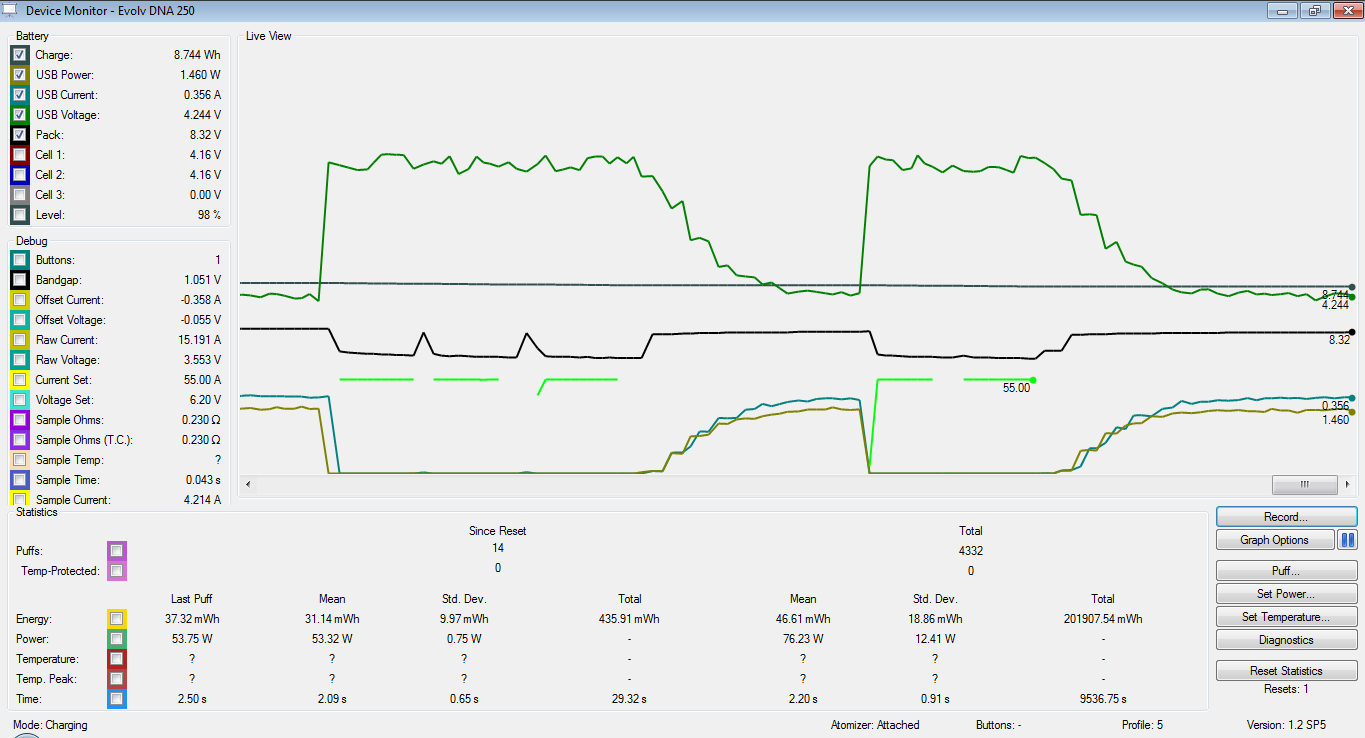

retird Posted March 16, 2017 Report Posted March 16, 2017 hum.... what does device monitor show when you try to fire it ? What are the Battery Settings in the Mod Tab?
etz1204 Posted March 16, 2017 Author Report Posted March 16, 2017 its on normal mode sir. Some says it could be the ribbon. but idk how to fix the ribbon
retird Posted March 16, 2017 Report Posted March 16, 2017 If the ribbon gets pinched by the fire button then the display will need to be replaced.... is the device still in warranty by the mod maker?
etz1204 Posted March 16, 2017 Author Report Posted March 16, 2017 retird said:hum.... what does device monitor show when you try to fire it ? What are the Battery Settings in the Mod Tab?Here is the screenshot when im firing it. I've notice the Buttons on the right corner is not responding.

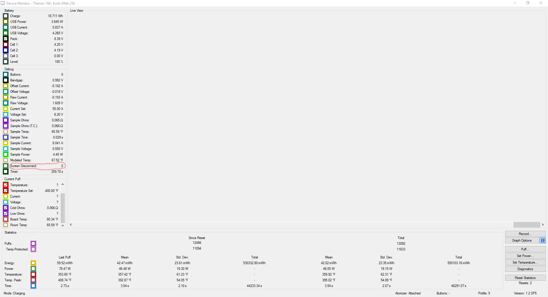

giz_60 Posted March 16, 2017 Report Posted March 16, 2017 Most vendors (where you bought it) have at least a 30 day warranty...in device monitor, what number is at 'Screen Disconnects'?
etz1204 Posted March 16, 2017 Author Report Posted March 16, 2017 giz_60 said:Most vendors (where you bought it) have at least a 30 day warranty...in device monitor, what number is at 'Screen Disconnects'?Vendor suggest to open it up and try pinching it back. lol where can i find 'Screen Disconnects' ? can you post some SS?
retird Posted March 16, 2017 Report Posted March 16, 2017 Opening the device may void the warranty.... a pinched ribbon usually can't be fixed by "pinching it back"....what is the vendor's warranty period?
etz1204 Posted March 16, 2017 Author Report Posted March 16, 2017 giz_60 said: how? i only have this tabs
etz1204 Posted March 16, 2017 Author Report Posted March 16, 2017 retird said:Opening the device may void the warranty.... a pinched ribbon usually can't be fixed by "pinching it back"....what is the vendor's warranty period? Usually 30 days warranty from the vendor. Im 8 days behind. but sadly i think the vendor cant help me. and he suggest to open it and pinched it back.
giz_60 Posted March 16, 2017 Report Posted March 16, 2017 You're missing a lot of tabs...try restarting Escribe & put it back into Debug mode...
