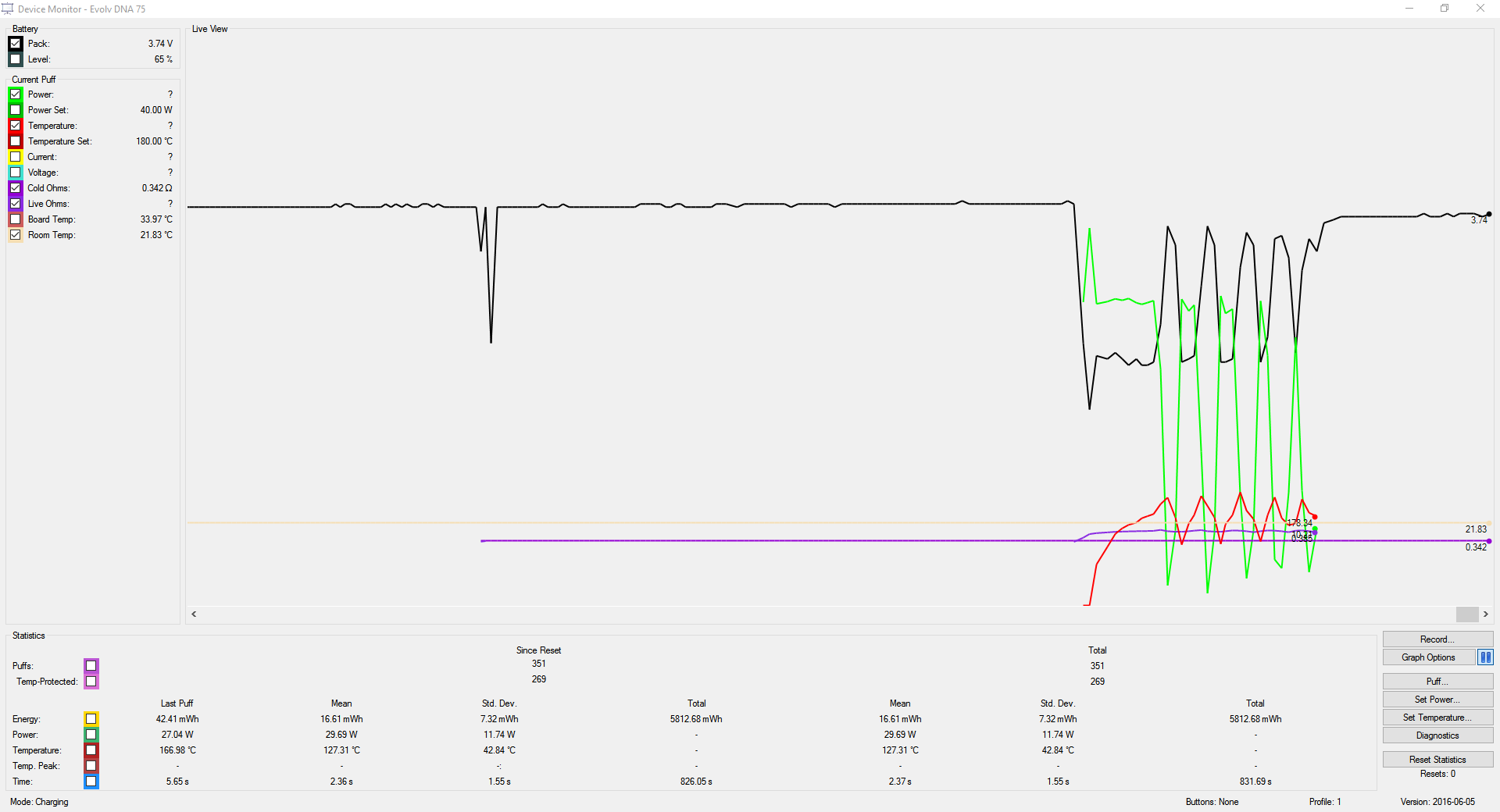

TimTim32 Posted April 16, 2017 Author Report Posted April 16, 2017 Hi, I recently bought a VT75 Nano. And i'm having some problems with it. It seems everything is working fine, the ohm reading is stable and i did try to lock the ohms at room temprature but is still seem to be pulsing to keep the temprature. Here is a picture of what I run into.

giz_60 Posted April 16, 2017 Report Posted April 16, 2017 What kind of atomizer/coil are you using?Edit: The reason I ask is... if you look closely at the screenshot you posted, you will notice that the 'Live Ohm' graph is fluctuating up & down, coinciding with the spikes & sags in temp, voltage & wattage...seems you may have unstable resistance when the coil is heated up...
