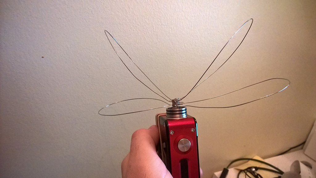

Wayneo Posted April 24, 2017 Report Posted April 24, 2017 Mustafa, on your battery tab you'll see Battery analyzer. Start with close to fully charged batteries. Create about a .5 ohm coil. Best to use 4 or so tennis ball sized loops of wire. Start the test, at 40 watts. In less than an hour, the testing will finish. You then need to save and load. Dead easy, and the absolute most accurate values for your mod and your batteries. Cheers.
Wayneo Posted April 24, 2017 Report Posted April 24, 2017 Thanks @giz, I was on mobile.@Mustafa once you're done report back with your thoughts on the ease of doing this so others will learn from your experience. Sorry if I sounded harsh.
giz_60 Posted April 24, 2017 Report Posted April 24, 2017 Wayneo said: Thanks @giz, I was on mobile. Expand @Mustafa....when running the analysis, have a small fan blowing on the mod...to keep it cool...
