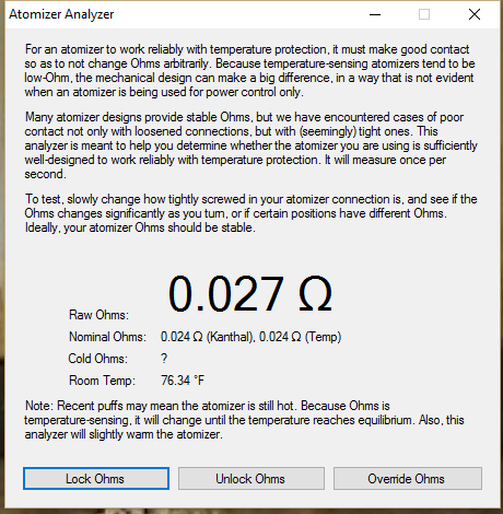

giz_60 Posted April 4, 2017 Report Posted April 4, 2017 You can try this to see if the device is detecting anything via the 510 connector...open the 'Atomizer Anlayzer' in Escribe (General tab)...remove atty from device & short the 510 center pin on the device to ground with a screwdriver or something & see if you get a reading...I used a pair of needle nose pliers in this photo...

kcredrum1 Posted April 5, 2017 Author Report Posted April 5, 2017 screw driver, tweezers do not show any ohm reading at all. tried 2 different screw drivers and nothing will show up on Atomizer Anlayzer' in Escribe software. i get room temp but ohms are just ?bad device?just got this on monday and online store gave me lost vape info for support. i guess the ammit will hold up for now during work and i will drip at home.i am interested in a bf device with tc, any ideas?
