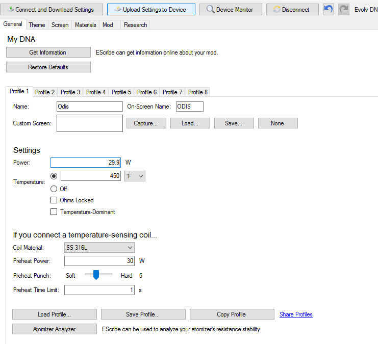

Posted

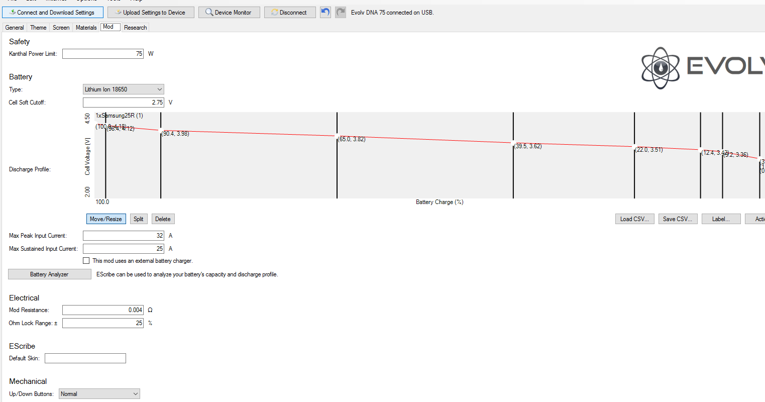

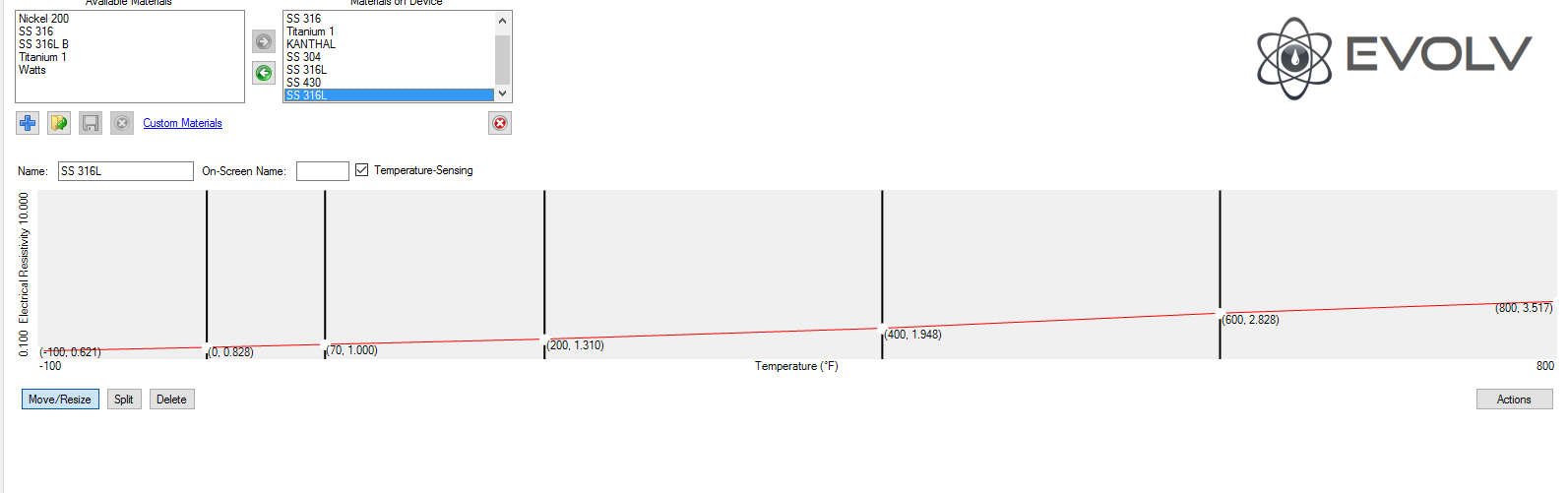

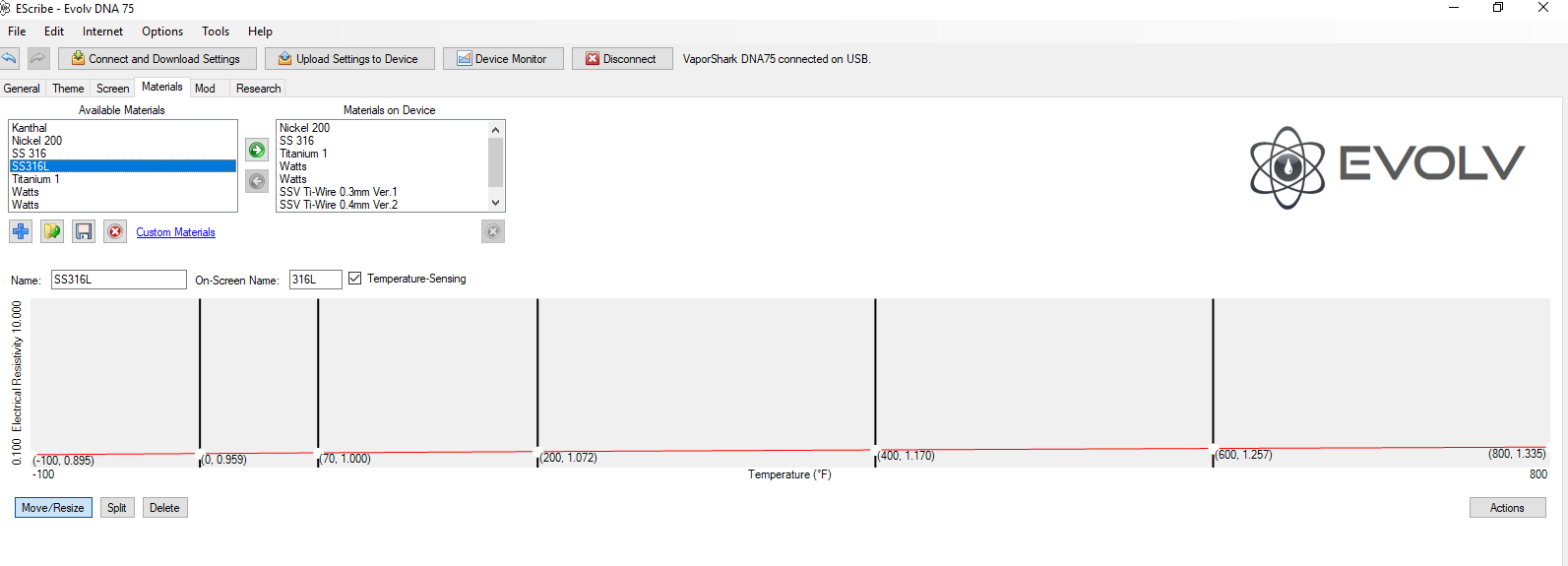

Please don't ask to see graphs. I have spent 3 days with a total of 26 hours reading every post on this issue. I have done the atomizer, mod temp and battery calibration twice and every time I load my profile, the wattage will not adjust for the temperature. I have totally given up on this mod. I have the Drone (250 chipset) and no issues with temp mode. I have a BF Odis 16 atomizer that was bought specifically for this mod which needs temp mode to avoid dry hits as there is virtually no juice well. I am not a happy camper with this DNA 75 chipset

Posted
Sorry to hear you are having issues but, you obviously don't have something set up correctly. What do you mean when you say the "wattage will not adjust for the temperature"? Not being able to see your mod, you are going to need to post some screenshots if you need help. The 75 works very well in temp mode, if everything is set up properly...

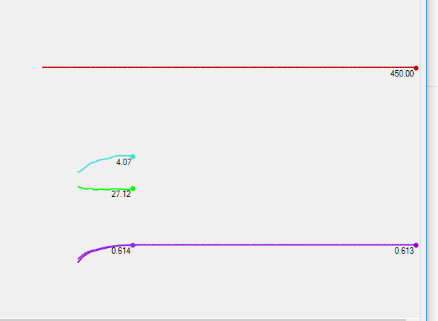

Posted

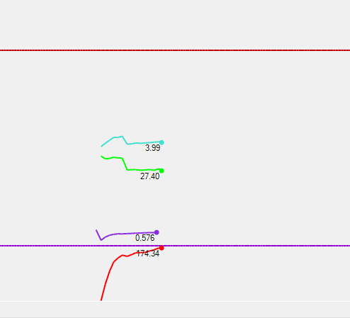

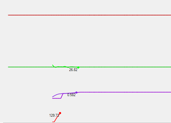

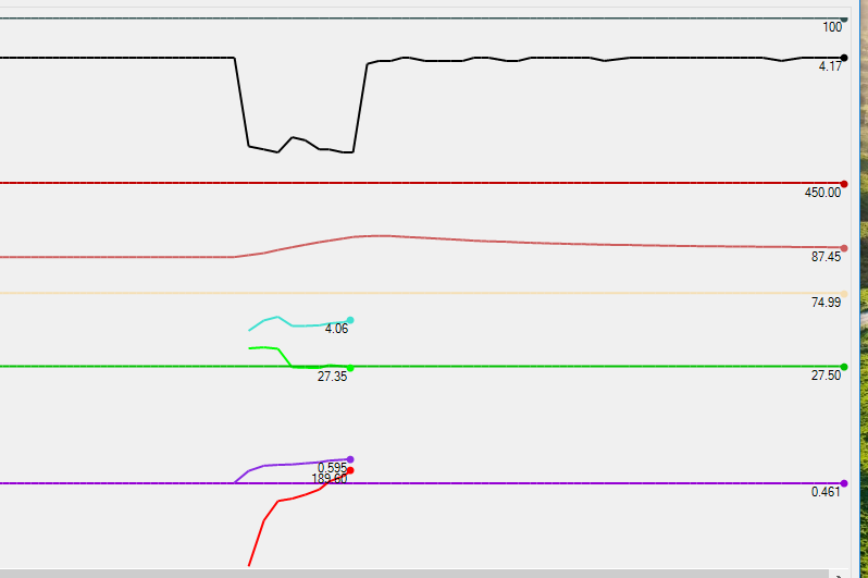

Can you post a screen shot of Device Monitor while firing with the following boxes checked...Power, Power Set, Temperature, Temperature Set, Cold Ohms, Live Ohms...
