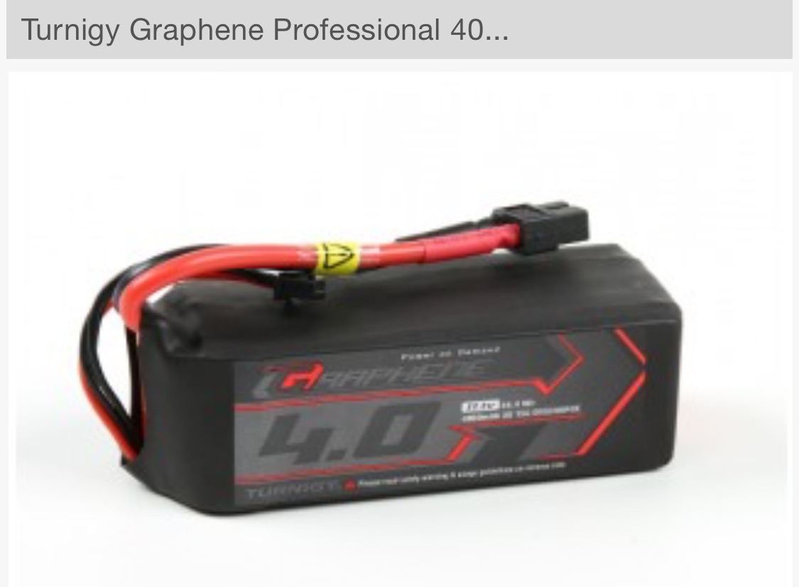

ccppkkjj Posted April 30, 2017 Author Report Posted April 30, 2017 After some support of the knowledgeable. Building a DNA250 with a 3s LiPo. I think I've confused myself. I want to run a Turnigy Graphene Professional - 3s 4000mAh at 15c. Giving it 60Amps continious. Just wondering if this is safe to use or outside of spec?
VapingBad Posted April 30, 2017 Report Posted April 30, 2017 Safe, google battery university if you want to know more, not kissing you off, just a good place to explain these sort of things.High capacity allows lower C rating for a given current (amps) level .
retird Posted April 30, 2017 Report Posted April 30, 2017 hum..... don't think I' ever used a 3S2P (6 cell battery) in a DNA.....Specs:Capacity: 4000mAhVoltage: 3S2P / 6 Cell / 11.1VDischarge: 15C Constant / 30C BurstWeight: 296g (including wire, plug & case)Dimensions: 107x35x31mmBalance Plug: JST-XHDischarge Plug: XT-60
