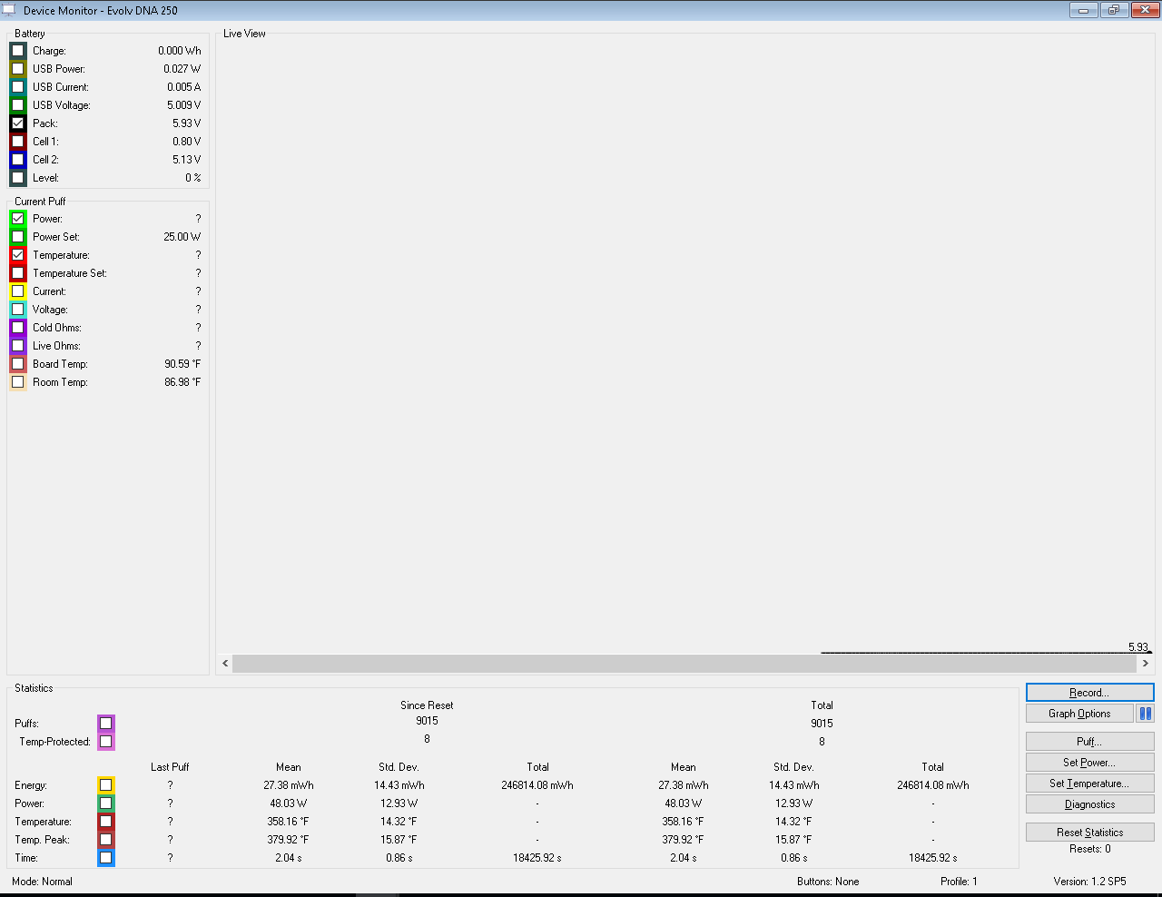

Wayneo Posted April 30, 2017 Report Posted April 30, 2017 erix222 said:Hello, A month ago i bought one of your products it was think vape finder dna 167 box mod.NO, you bought a ThinkVape productYour 1st contact should be your place of purpose, followed by Thinkvape. If it's determined to be a board issue and no help from them, then Evolv. Anger is understandable, but you're misdirecting it. Tell Gearbest you're angry, we're here to help you.Can you post a full proper screenshot (not a video or cell phone picture) of Device Monitor, and a screenshot of the 'Mod' tab
erix222 Posted April 30, 2017 Author Report Posted April 30, 2017 Oh sorry that was just a copy paste of a letter i sent to think vape themselves my bad... Im not home right now will post it tommorow. But as far as i remember escribe showed that one battery is like 4.4v and another is 0.73 or something , and no it wasnt batteries fault , tried brand new vtc6 , vtc5 , 25r's. the only time i used escribe was to make wh and mah settings to fit my batteries, tried hard reseting , soft reseting... And im pretty hopeless , gearbest refuses to respond for like almost a month. As i said i will post the mod tab pictures when im home thank you for your help
Wayneo Posted April 30, 2017 Report Posted April 30, 2017 No worries man. We'll help you determine if it's a board fault. The worst case scenario is that you'll need to send either the mod or the board to (Evolv) in the USA. Have a good one. Printscreens much cleaner, clear and all info, not pictures

giz_60 Posted May 2, 2017 Report Posted May 2, 2017 erix222 said:Tried it already it didnt help as it was already set to 2 battery modeCan you post a screen shot of Device Monitor
erix222 Posted May 2, 2017 Author Report Posted May 2, 2017 giz_60 said:Can you post a screen shot of Device MonitorWell not really , because its kinda packed to go for an Adventure into evolv headquarters for rma.

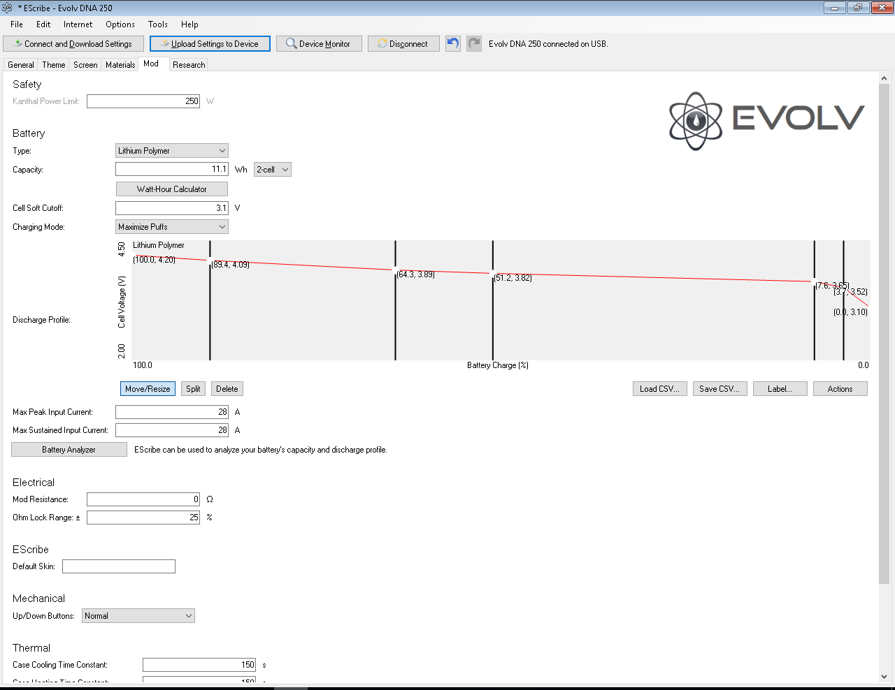

erix222 Posted May 3, 2017 Author Report Posted May 3, 2017 So u wanted my escribe settings , here they are
Wayneo Posted May 3, 2017 Report Posted May 3, 2017 erix222 said: Well not really , because its kinda packed to go for an Adventure into evolv headquarters for rma.I think you already have that RMA, and your printscreen's show that. You also mentioned your friend with same product and issues. Maybe you can post his issues, and send 2 back at the same time to save on shipping costs. Just an idea
erix222 Posted May 4, 2017 Author Report Posted May 4, 2017 Uuum it was always like that , i think it was at 9wh with vtc5 and now 11.1 with vtc6 but its not the case it worked just fine earlier.
Wayneo Posted May 4, 2017 Report Posted May 4, 2017 @erix222 11.1 for each vtc6 each, at best .......... but certainly not with your 3.1V cell soft cutoff. In reality, with those batteries it could be closer to around 10Wh each. Scarab is absolutely correct BUT you said '.... kinda packed to go for an Adventure into evolv headquarters for rma', so I didn't want to go there.
