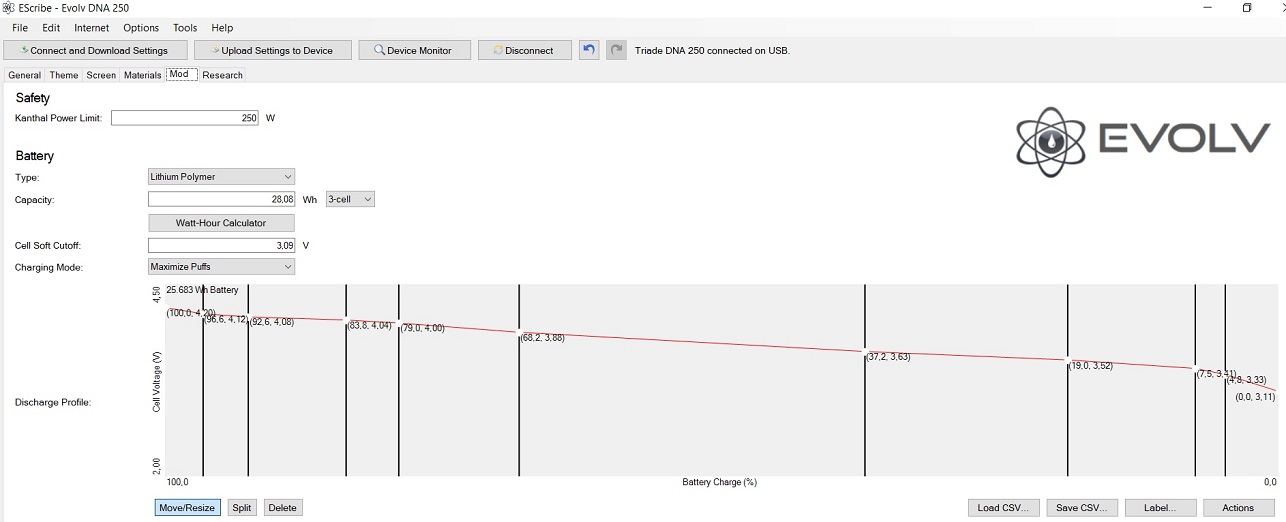

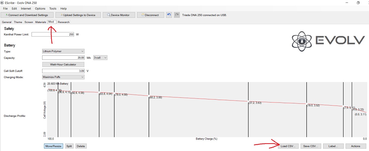

Madkat Posted March 28, 2017 Report Posted March 28, 2017 sorry for the silly question...but where do you load the battery profile in eScribe? i must be blind!
Franz74 Posted March 28, 2017 Report Posted March 28, 2017 In the attachment there's my discharge curve. Hope you'll find it useful3 x vtc5.csv
Madkat Posted March 29, 2017 Report Posted March 29, 2017 giz_60 said:In the 'Mod' tab... Thank you SiFu giz_60just realized i've been running escribe UI in advanced mode only :/

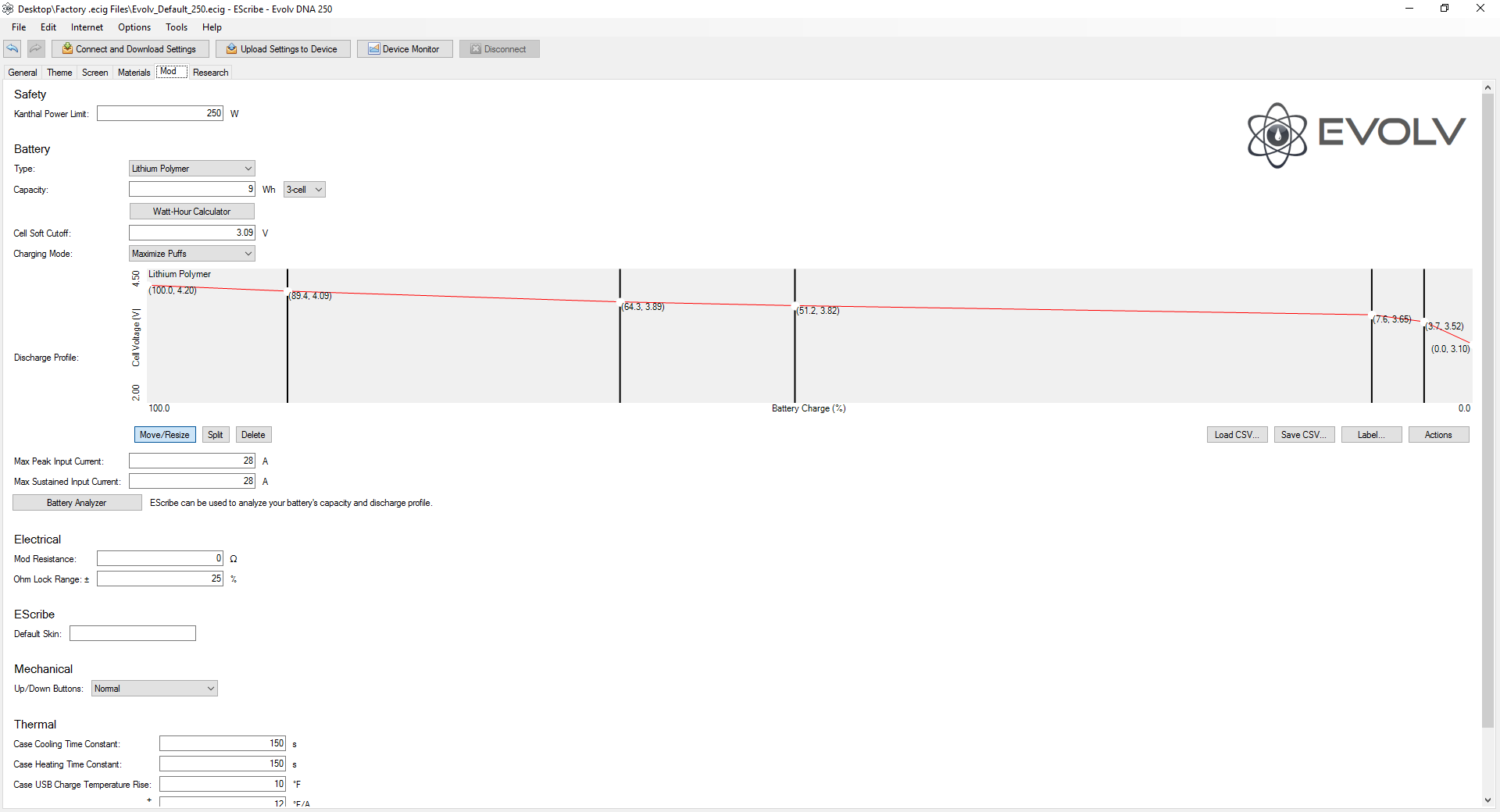

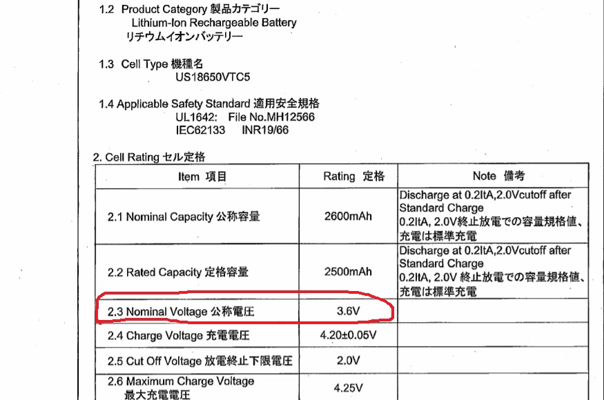

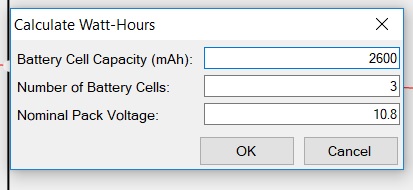

funnfunn Posted May 4, 2017 Report Posted May 4, 2017 Hellogiz_60 said:In the 'Mod' tab... Why only 9 Wh?You need to consider the total voltage of the three batteries.The nominal voltage of a single battery VTC5 3.6 volt hence the nominal voltage of the three batteries is equal to 10.8 volts. You need to specify the total nominal voltage of three batterieshere are my settingsTriade DNA250 3xVTC5(my conf.).csv

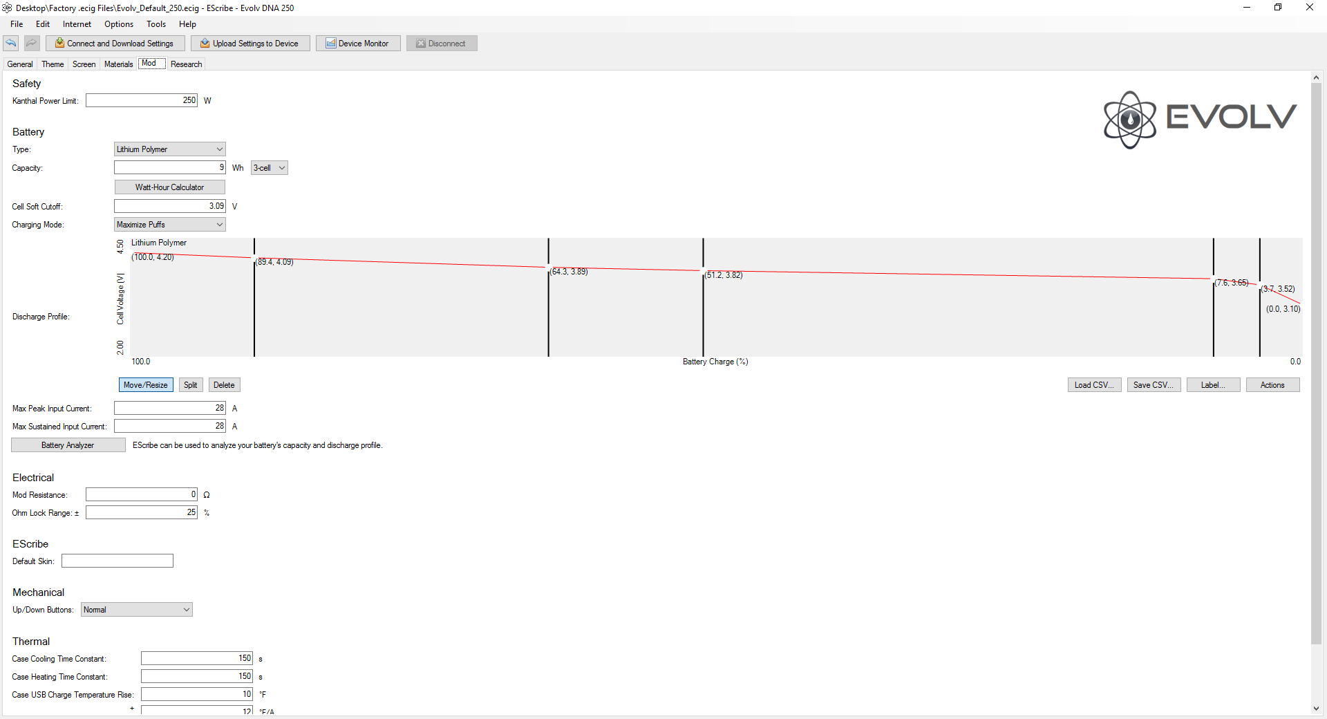

giz_60 Posted May 4, 2017 Report Posted May 4, 2017 That screenshot was taken from the Evolv default setting...wasn't referring to the Wh's in that post...but rather, how to load a .csv file...

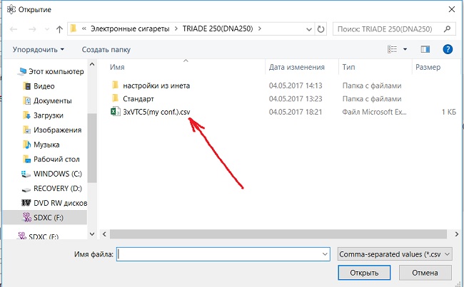

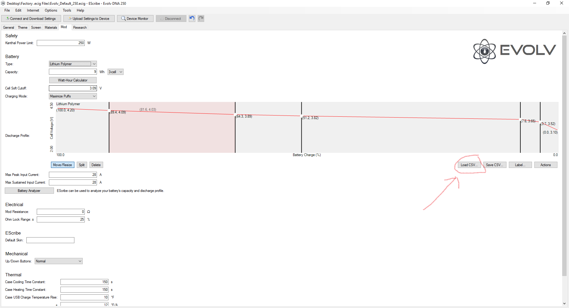

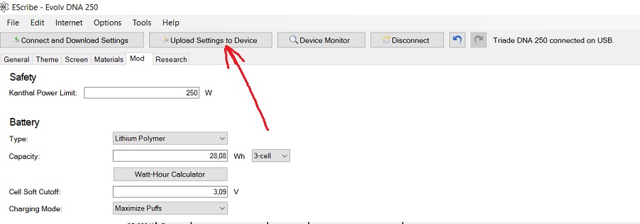

funnfunn Posted May 4, 2017 Report Posted May 4, 2017 giz_60 said:That screenshot was taken from the Evolv default setting...wasn't referring to the Wh's in that post...but rather, how to load a .csv file...this is the standard chart from the default settings for Triade DNA250I changed the numbers in the calculator battery.You mean to load the settings in the mod? And upload the file which you downloaded earlier Then save the settings in a modThat's all. Mod is ready to work.
giz_60 Posted May 4, 2017 Report Posted May 4, 2017 If you open Escribe to the DNA 250 version with no device attached...this is the screen you will get...which is what was used in the screen shot you were originally referring to...was only using this as an example to show how to load a .csv file into his device...
funnfunn Posted May 4, 2017 Report Posted May 4, 2017 giz_60 said:If you open Escribe to the DNA 250 version with no device attached...this is the screen you will get...which is what was used in the screen shot you were originally referring to...was only using this as an example to show how to load a .csv file into his device...Well friend, no problem. I hope these tips will help novice users. Thank you for your file (.csv) I'll upload it into my mod later.
