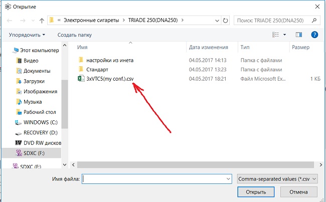

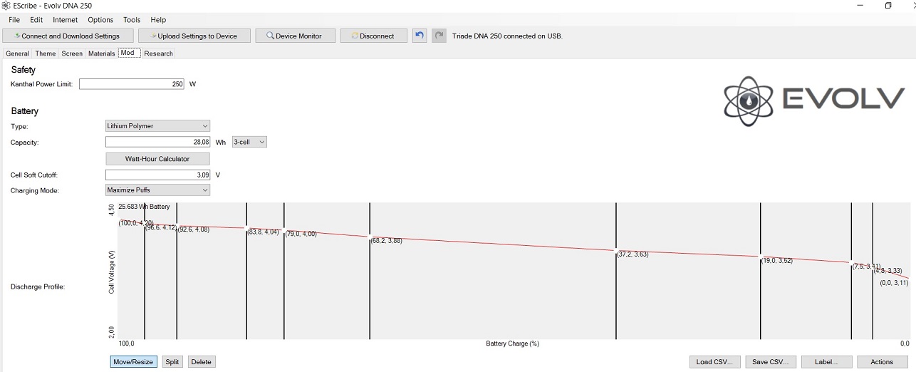

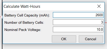

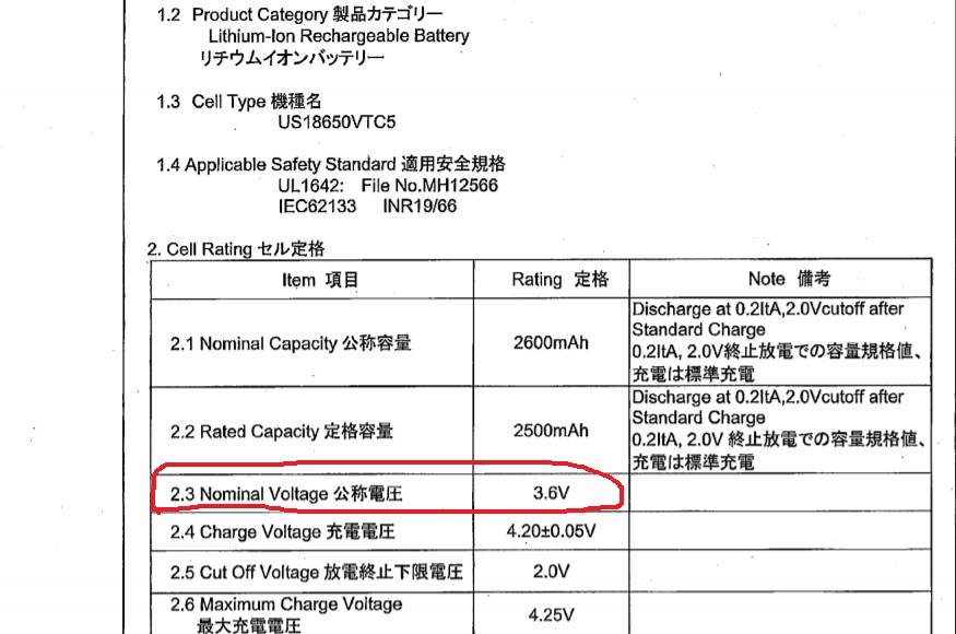

Hello Why only 9 Wh? You need to consider the total voltage of the three batteries. The nominal voltage of a single battery VTC5 3.6 volt hence the nominal voltage of the three batteries is equal to 10.8 volts. You need to specify the total nominal voltage of three batteries here are my settings Triade DNA250 3xVTC5(my conf.).csv
