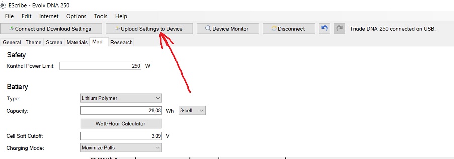

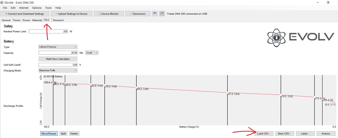

  1. Well friend, no problem. I hope these tips will help novice users. Thank you for your file (.csv) I'll upload it into my mod later.
  2. this is the standard chart from the default settings for Triade DNA250 I changed the numbers in the calculator battery. You mean to load the settings in the mod? And upload the file which you downloaded earlier Then save the settings in a mod That's all. Mod is ready to work.
  3. Hello Why only 9 Wh? You need to consider the total voltage of the three batteries. The nominal voltage of a single battery VTC5 3.6 volt hence the nominal voltage of the three batteries is equal to 10.8 volts. You need to specify the total nominal voltage of three batteries here are my settings Triade DNA250 3xVTC5(my conf.).csv
