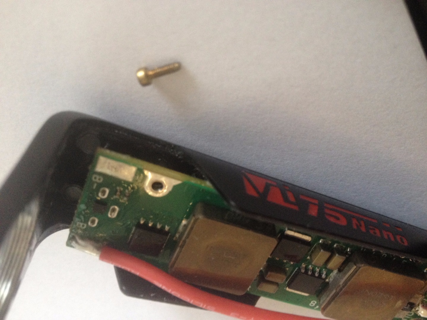

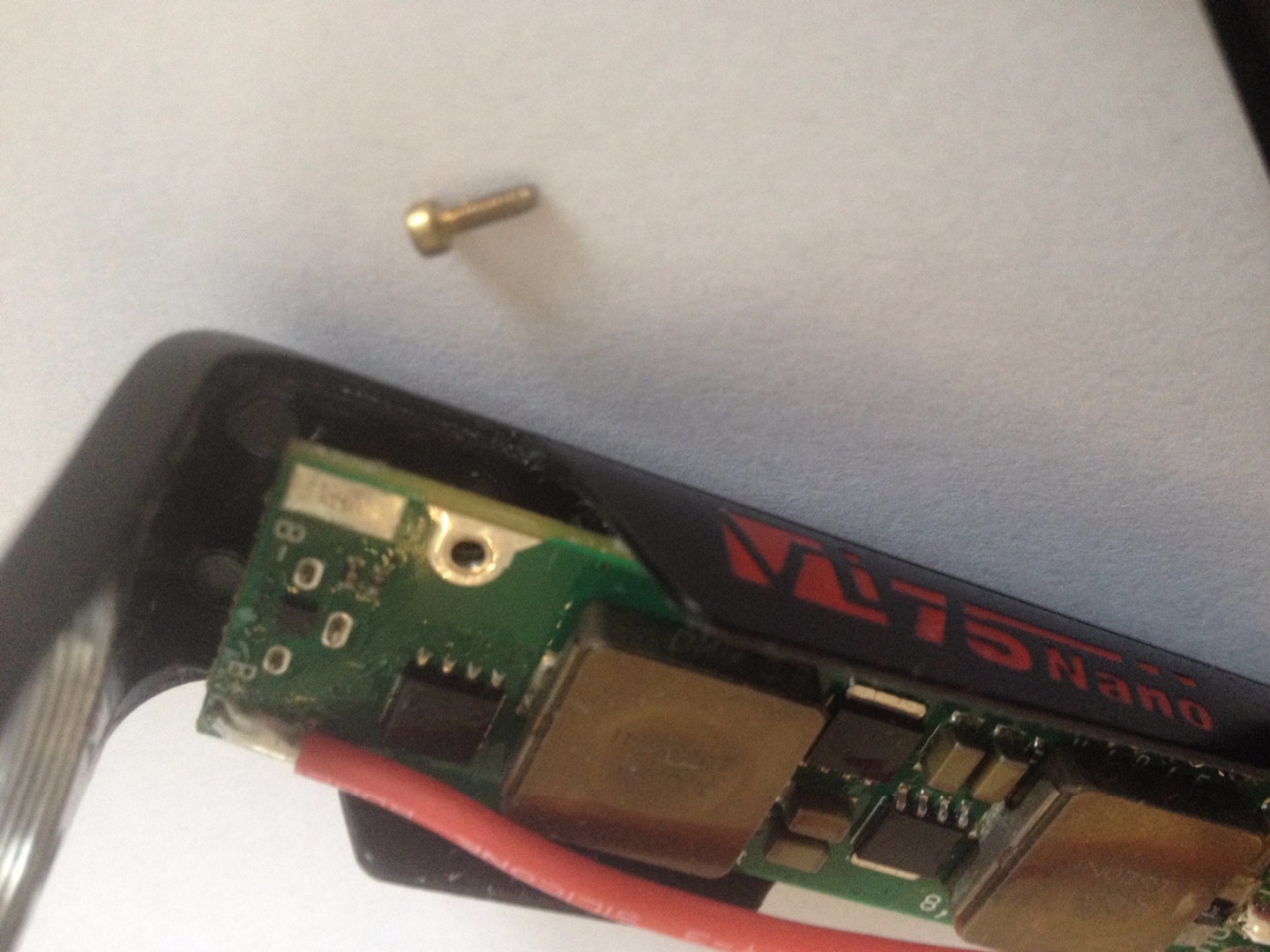

gidzol Posted November 20, 2016 Report Posted November 20, 2016 I had the same problem.I took the VT75 Nano apart and found that the grounding screw felt out (see picture). I screwed it back and since it is working fine.

Loxias Posted January 24, 2017 Author Report Posted January 24, 2017 I found out that I've got the same mechanical issues which faced by gidzol and daddi89.The VT75 nano started to behave like a mad. I took it apart and voila! An internal screw was completely unscrewed and two others were loose.In conclusion: That said by daddi89: "this mod has a very great look, but the engineering is crap"
