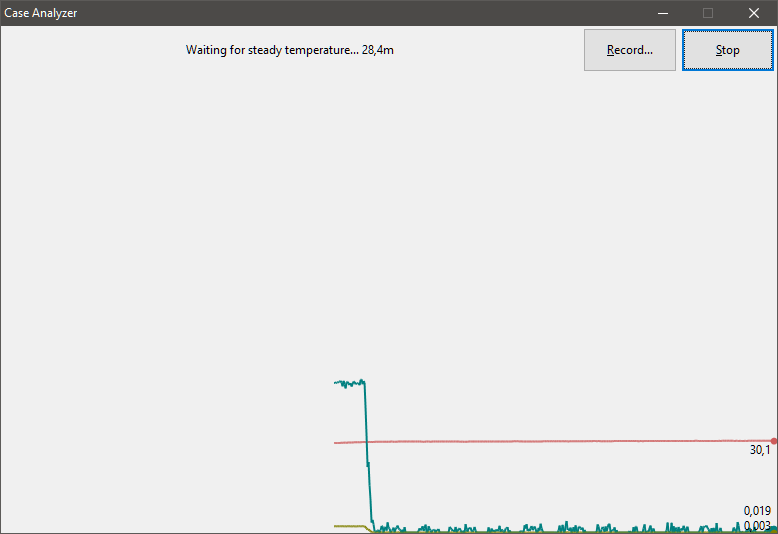

  4. Hi there, i have recently bought a Lost Vape Thelema DNA250C and have since dove deep into calibration and measurements. Since im using SS coils it is very important for me to have everything properly set up because even the slightest error will throw the temps way off. The problem is: While doing case analysis (tried from 25% battery as well as 50%) the cells still receive a minimal charge during equalization and cooldown phases when any charging should be disabled. The amperage fluctuates between 0 and mostly 0,035A on my mod which initially doesn't sound like a lot but will still warm the device up considerably (4-7°C), making it impossible to equalize to room temp. However: I know that it's possible to disable charging completely because if I disable USB charging from the device monitor Diagnostics button it locks at 0.000A and stays there. Not even a single hickup (Current scale set from 0 to 0.1A so you can see there's absolutely nothing): I have since found out that other people also have had this problem for quite a while but never received an answer to their reports in other topics and subsequently pinned it to a possible power leakage, bad boards or random cell balancing... I think it's neither of those. I've tried with SP38 INT as well as the SP45 beta from the german DNA200 website, both to no avail. To me it seems to be just a bug where the case analyzer doesn't shut down charging in quite the same way as the device monitor can do. Please try to fix this very annoying bug as this precise calibration capabality is one of the reasons I and I'm sure many others chose DNA in the first place. It'd be very sad if that was now impossible due to such a silly bug. Thanks in advance for any help. If you need recordings or logs please ask. Unr3aL
