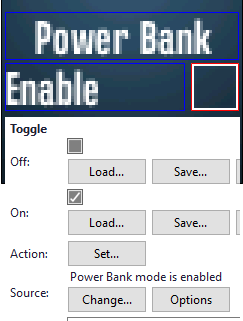

.... and the next theme, which fools the owners of 75C and 100C chipsets into a power bank function, which - oh wonder - cannot be activated.
The next theme, which in a mod with only one cell, shows the total voltage of the battery pack one below the other and then the one cell again ...Hey - do your homework.

On the battery screen, you should use the same condition for cell 1 as for cell 2, as it makes little sense and looks unattractive if the single existing cell is displayed individually under the total voltage of the battery pack.So, now to the power bank function: what happens if you select the menu item on your 75C chipset? Does your mod suddenly have unexpected abilities? Better, the menu item only appears if the function is actually available. To do this, you create a "hidden field" measuring 22, 22 and enter the corresponding function as a condition for displaying the image:
And if you've done all of this properly, I'll remove my comments - deal?
vor 17 Minuten schrieb s-ugra:
No, I haven't tested it, but it should work))
Probably not, since the 75C and 100C do not have a power bank function and cannot evaluate separate battery cells.
vor 16 Minuten schrieb s-ugra:
If you publish a theme specifically for the 75C, then I wonder why it provides controls and screens for a power bank function and several battery cells. You should expand the tags or make it clear that this theme is also suitable for 100C and of course supports the functions of the 250C (power bank, evaluation of individual cells in the battery pack).
