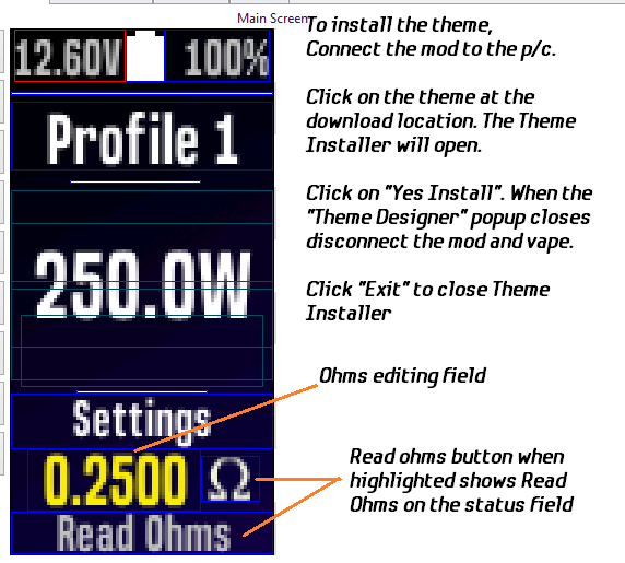

Tub Thumper, If I remember correctly the board reads the ohms to five decimal places. It is very important to use the 1/10,000 setting when editing the ohms. At the default 1/100s the ohms could be 10 to 20% off from the actual resistance if the coil is below .15 ohm. Measuring and setting the ohms in this fine of scale should help in evaluating the different tcr/tfr settings. This is the default Evolv theme with the read ohms button and ohms editing field. I replaced the upper ohms field with the battery voltage. I also made the Atomizer screen ohms field read only. Download the theme and have fun!! JT About the tcr/tfr's I use the Steam Engine version. I feel that the default 316 profile vapes too cold. The temperature setting for the stock 316 profile was 20 to 30 degres higher for me than the Steam Engine profile. Hope this helps, JT 250c default with ms ohms.ecigtheme -

Tub Thumper, I still experiment as you describe. To get around the resample problem, I would put all of the cold atty's (5) on one profile. I would measure the resistance by useing the read ohms button in my theme. I made a notepad file that I recorded the different cold atty's resistances in. In my theme I have a cold resistance field on the main screen that I can set the ohms in. If your theme has an ohms field you can make it editable by using Theme Designer and the settings in the screenshot below. If your theme does not have a read ohms button I can show you how to make one. JT -

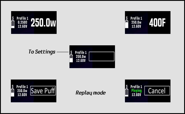

Added silver or black side bars on the main screen and a replay switch to the atomizer screen. JT 250c ---- 250 v2 silver.ecigtheme 250c ---- 250 v2 black.ecigtheme -

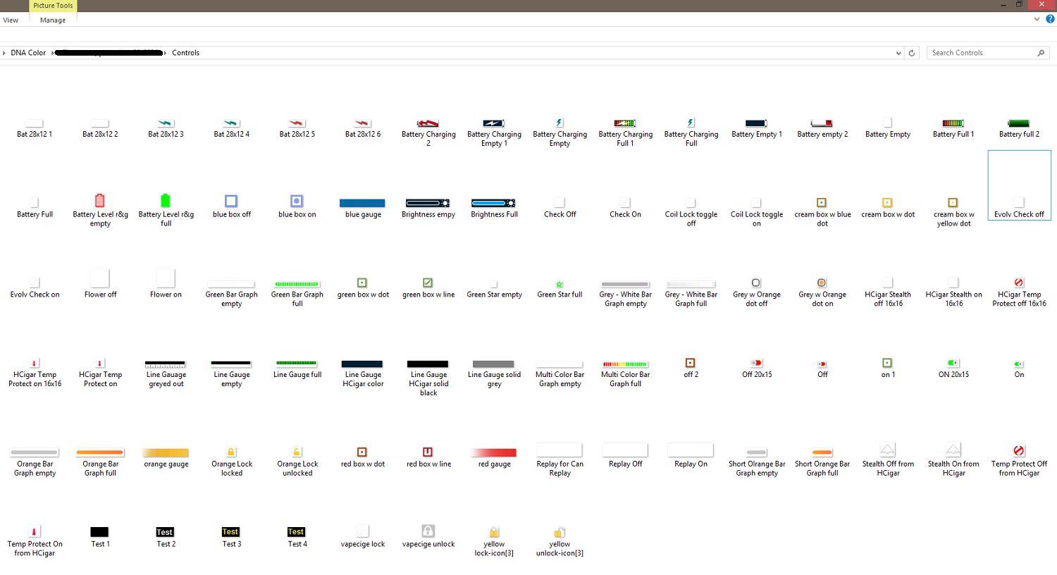

To change the color of the pictures it is best to try to use the white pictures in your controls. Trying to change the color of a picture that has color has either no visible effect or odd results. Sometimes the odd result is nice, so it's worth trying. The example below shows how to do it. Enjoy JT
