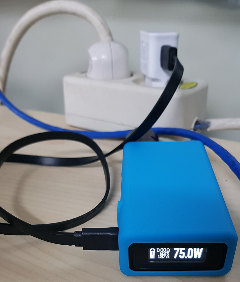

Hi James, it's 2 Amps and i use / carry around Samsung chargers.. I'm quoting myself from the support ticket between me and Nick. but I forgot to mention i also use Anker Powercore II powerbank and it's 2.0 cables here are the list of USB cables and adapters that i've tried : 2.0A> Adapters : 1. OEM charger for Samsung Galaxy A5 and A7 (2 of them, white and black), 2.0 A output 2. Samsung Travel Charger, 2.0 A output 3. Samsung OEM Charger for Samsung Galaxy S8 (the one i carry around) USB 3.0 Qualcomm Quick charge 4. Hippo dual dynamic charger (1A & 2A ports) 5. Dell Laptop USB Port (2.0 and 3.0) 2.0 Cables : 1. Vaporshark included 2.0 usb cable (data transfer capable) 2. Macson short 2.0 usb data cable (data transfer capable) 3. Samsung 2.0 usb cables (3x paired with the adapters, 2 of them are data transfer capable, 1 is not) 4. Hippo 2 Meter fast charging cable (no data transfer support) i can confirm that no cut off happened while on SP 5.1, and very positively sure it didn't happen before upgrading to SP6 and after downgrade from SP6.. because i have a habit whenever i charge my mod, the screen is always facing my direction, as soon as the battery reaches 100% and current goes less than 0.20A then i disconnect the chargers. i do this almost everytime, except when i go to bed, i charge it with anker powerbank which is intellegently turns itself off after the mod no longer accepts charges.. edit: have you seen my graph on page 49? it has down spikes which i'm not sure have happened before, i rarely use escribe for anything except for theme changes 😉 -

Just an update to my previous posts.. I've contacted for support and had been asked to roll back the firmware and i did, i went back from SP6 INT to SP5.1 and my device no longer suffering from power cut offs.. the downside is i lost the boost feature... dang it.. I hope they found out the problem and got them sorted out.. for now i'll upgrade again to SP6 and enjoy the boost feature and charge my device with 1A only just to be safe -

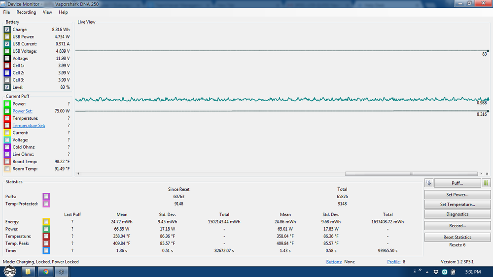

thanks for the heads up, so whenever the current changes drastically within a period might trigger the chip to cut off the charge and reorient itself. i do have to mention that my favorite fast charger adapter randomly ramps up/down rapidly reading at 1.94 to 2.00A before disconnection happens.. but i can confirm that the behavior happens when i'm using previous firmware without disconnecting.. well, i'll try changing the adapter and see what happens.. btw, have you seen my graph above? is it normal to have some spikes like that while charging? or is it the balancer taking control which cells needs to be charged? thanks again
