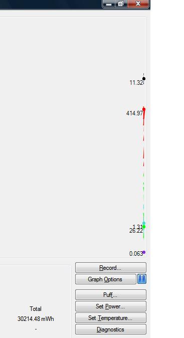

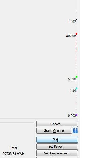

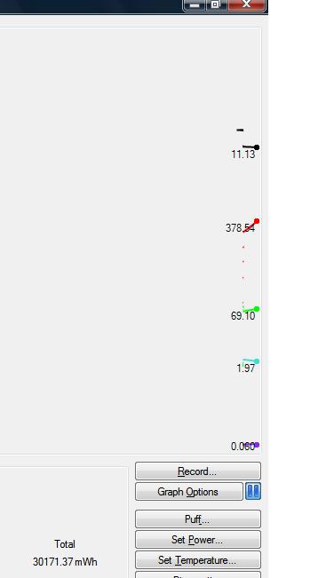

  12. So I take a puff in device monitor and the graph shows up like this with time scale set to 5 seconds, any ideas why? this is running 07.29 update.
  13. My bad I must have just changed it too the highest curve I could without even thinking what I was doing, 100% @ 4.5 volts hahaha, I'll change it back to standard now. Thanks for your help John.

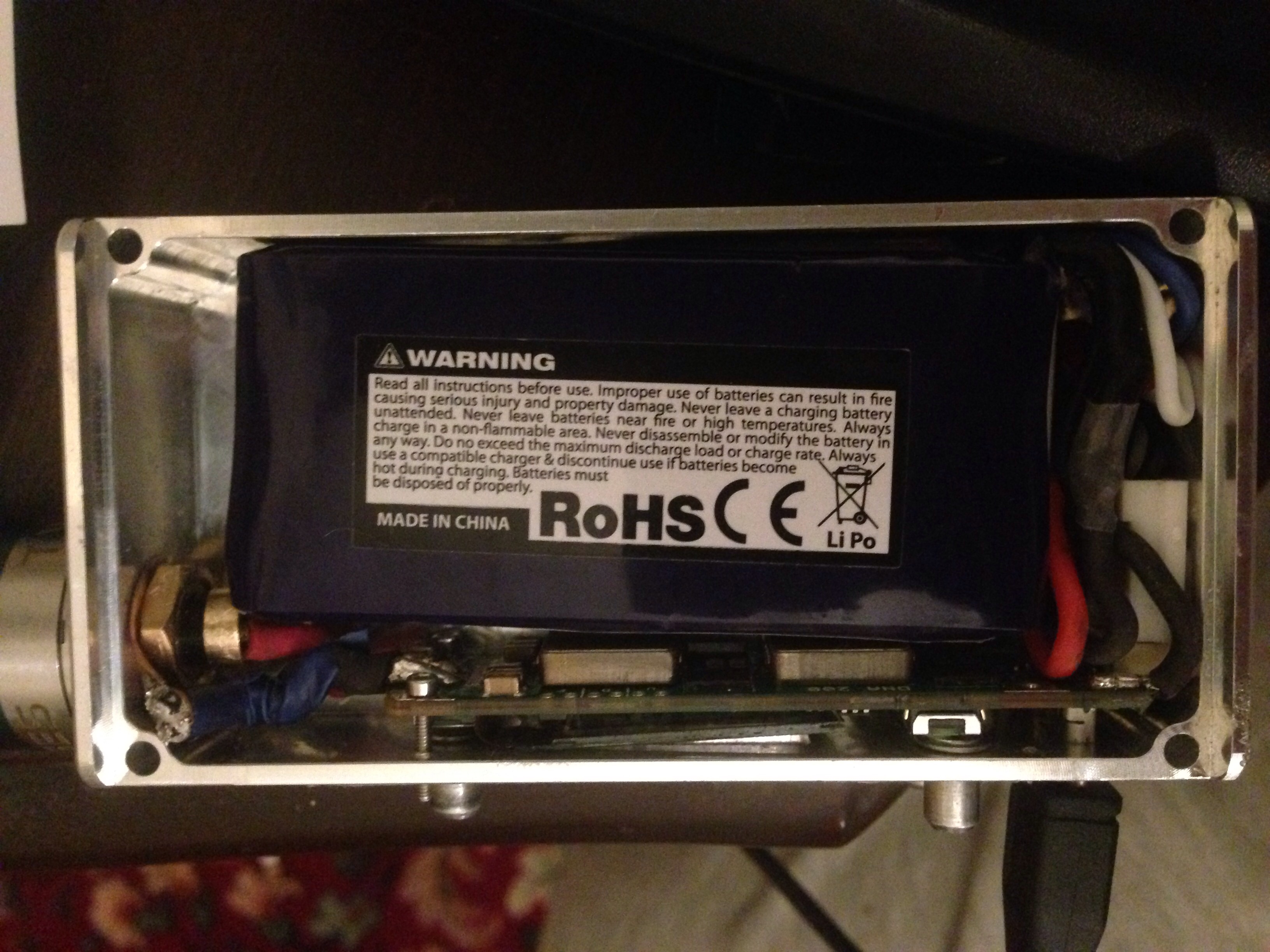

  16. By the way John I haven't got a battery connector in there (xt60 so on), just soldered the wires straight too the board and plugged in the balance connector now this wouldn't make a difference surely?
  17. This wasn't with an atomiser on the mod, I'd just charged it for the first time, locked it to go to sleep and laid it on it's side.

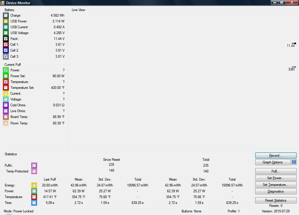

  19. It was on 9/27 firmware, no it wasn't running hot from what I noticed, it definatly wasn't in the morning. What would you like me to set on device moniter? Here's a photo
  20. Cells all read the same on the device monitor and I set the battery Wh too, I couldn't find the multimeter so will have too look again
