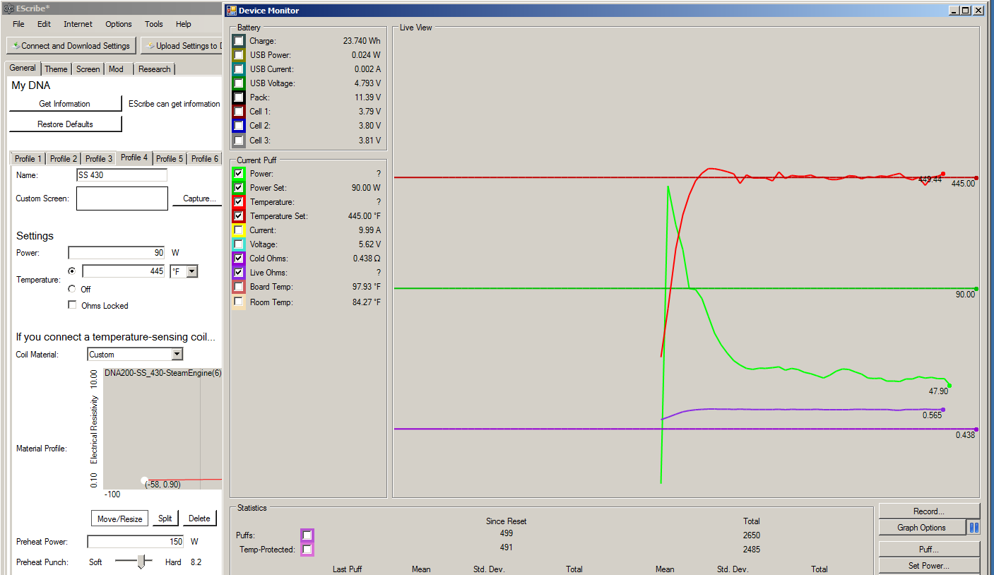

This build is going to be hard to beat for Unkamen's Nickel Free 28 gauge SS 430 that results in a stable temperature. It is 16 wraps of twisted annealed 28 gauge around 3mm arbor at about a 1.5 pitch. Came in at .445 cold ohms. Twist pitch ended up at 1.5mm A lot looser than I wanted but that is where the ware broke. When I replace this coil I'll Anneal the wire before twisting instead of after to see if that gives me a tighter pitch which should increase the cold resistance a little more. The graph below is about a 5 second vape in a 10 second window. Set for 90 watts, 1 second 150 watt preheat. Vertical coil on a Steamcrave Aromamizer. Going to kill a battery quick though.

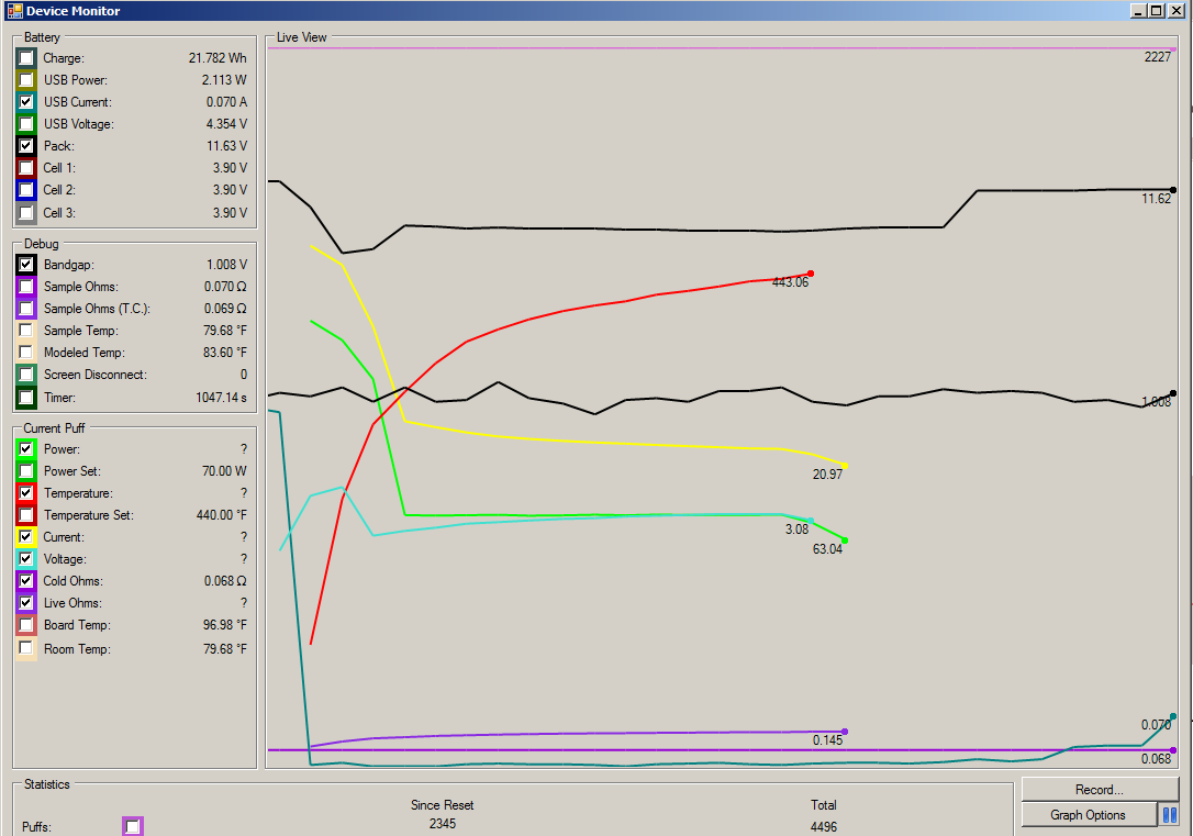

My Results. I ran this test twice a few days apart from about 25% battery remaining, The first time I ran it I left the Reuleaux setting flat, up right on the desk (bottom air holes blocked) and the second time I ran it I propped the mod front up on my mouse pad so airflow could enter the bottom air holes. I didn't do a screen capture of the first run however charge temperature rise and Degrees F/A were significantly higher. Attached below is a screen print of my second run. I've always believed "Cooler is Better" when it involves electrical components so I now charge with the mod vertical and the bottom airflow holes exposed. I'm betting the differences we are seeing between each other is caused by a combination of different initial ambient room temperature, battery temperature and the board temperature. Mine was still hot from vaping few minutes previously. Also how well the dna board transfers heat to the metal of the case to dissipate. My actual room temperature for both runs was a little under 70F. I wonder if a little thermal compound between the board mount pads and the case or enlarged airflow holes would help? I might try that someday <grin> I'm also interested in what my results would be in I set the mod inverted (upside down) with the atty removed so air could enter the side air holes and exit out the bottom air holes facing up? Plan on trying that soon myself. What I think I want to see is a low Case USB Temperature Rise and a low F/A value. Does anyone know what the heating and cooling constants represent?

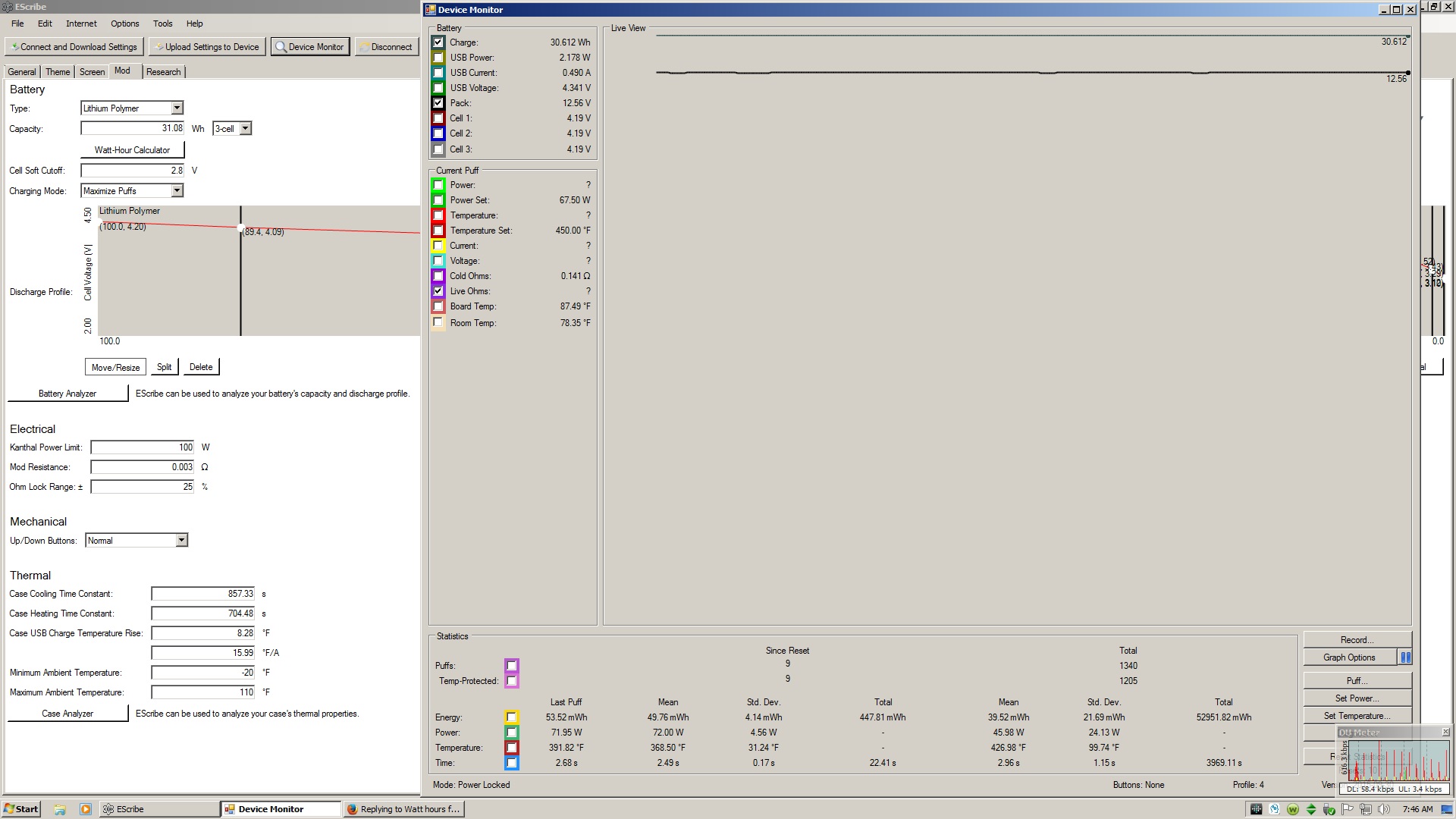

I had the same issue with Wismec's settings. For some reason it was causing an error with the "cold ohms" that resulted in a vape that was poorer than poor. What I did was install the latest Evolv firmware and used Wismec''s thermal settings until I had a chance to run my own thermal case analysis. It has been working great since. Your Crown tank resulting in a bad cold ohms is more likely caused by the Crown Atty static resistance, A incorrect "mod resistance" setting under the Mod Tab, or Unstable or erratic resistance in your coil build contacts. Attached is my current Mod settings.
