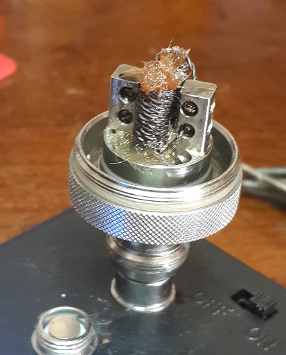

I almost hate to show a picture. It is a Very Ugly Coil but has lots of mass and surface area and vapes well. There isn't a lot of room under the bottom end of the coil. Maybe 3/16". Actually Looks more difficult than it is to wick a set of verticals. With a little practice, less than a minute to wick. Wicking requires long strand cotton. I use Japanese cotton. Regular organic cotton from a cotton ball doesn't work very well. Feed cotton into the top until it sticks out from the bottom a bit. Capture the tip of the wick with a needle point and fish it out to the side until you can grab it with finger tips or tweezers. With needle point press down on the cotton into the well while pulling out the tail. A two hand operation. Loosely fill the juice well with cotton and trim the top almost flush just a little above the top of the coil

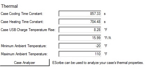

My Results. I ran this test twice a few days apart from about 25% battery remaining, The first time I ran it I left the Reuleaux setting flat, up right on the desk (bottom air holes blocked) and the second time I ran it I propped the mod front up on my mouse pad so airflow could enter the bottom air holes. I didn't do a screen capture of the first run however charge temperature rise and Degrees F/A were significantly higher. Attached below is a screen print of my second run. I've always believed "Cooler is Better" when it involves electrical components so I now charge with the mod vertical and the bottom airflow holes exposed. I'm betting the differences we are seeing between each other is caused by a combination of different initial ambient room temperature, battery temperature and the board temperature. Mine was still hot from vaping few minutes previously. Also how well the dna board transfers heat to the metal of the case to dissipate. My actual room temperature for both runs was a little under 70F. I wonder if a little thermal compound between the board mount pads and the case or enlarged airflow holes would help? I might try that someday <grin> I'm also interested in what my results would be in I set the mod inverted (upside down) with the atty removed so air could enter the side air holes and exit out the bottom air holes facing up? Plan on trying that soon myself. What I think I want to see is a low Case USB Temperature Rise and a low F/A value. Does anyone know what the heating and cooling constants represent?

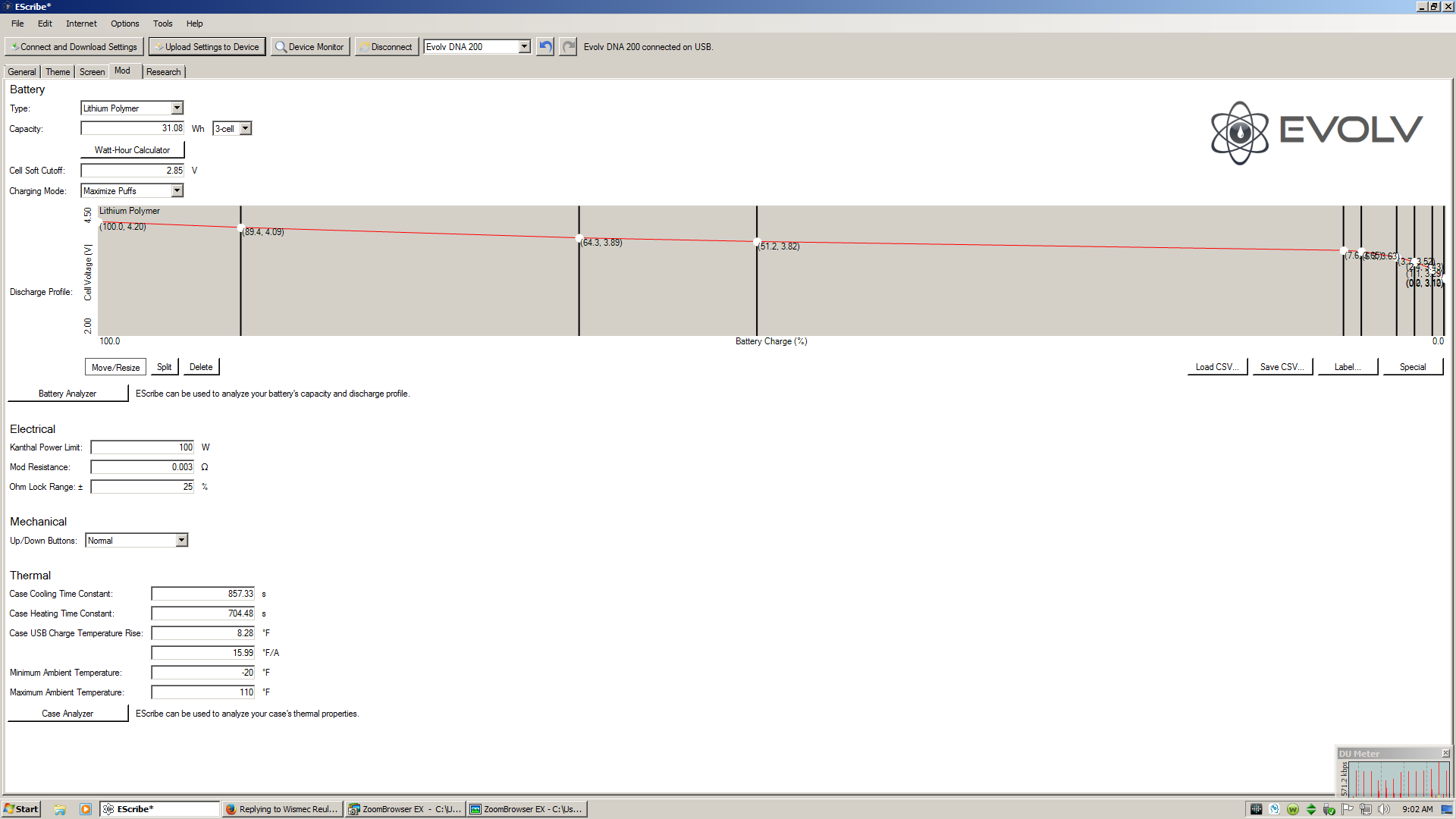

I had the same issue with Wismec's settings. For some reason it was causing an error with the "cold ohms" that resulted in a vape that was poorer than poor. What I did was install the latest Evolv firmware and used Wismec''s thermal settings until I had a chance to run my own thermal case analysis. It has been working great since. Your Crown tank resulting in a bad cold ohms is more likely caused by the Crown Atty static resistance, A incorrect "mod resistance" setting under the Mod Tab, or Unstable or erratic resistance in your coil build contacts. Attached is my current Mod settings.

I'm using a set of "subohmcell" batteries that are listed as 2800 mah. However Kidneypuncher.com web site tested a set of these and found they perform identical to 25R's in capacity. Whatever the subohmcell is it's definitely a rewrapped battery of some type. Using the settings from the watthour it calculator they are 31.08 wh. This is what I entered, right or wrong. Jumping ahead from a full charge to empty I'm getting 410 puffs with ending cell voltage about 3.25 volts when the battery meter shows empty and remaining watt hours shown on the monitor was showing about 1/3 of 1 watt hour left. So should you set yours to 2500 or 2800? Good question, I'd try 2500 if I were you and see if your battery meter is accurate. If not, make an adjustment or run battery analyzer.
