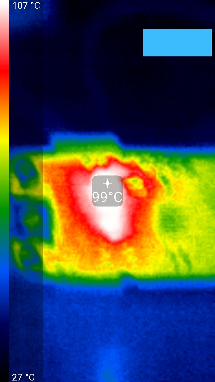

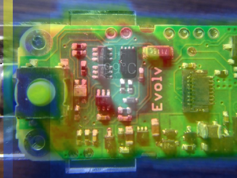

DNA75c discharge probrem.
eucalyptus. replied to eucalyptus.'s topic in EScribe, Software and Firmware
OK. The cause seems not to be F/W. I tried another approach. Probably it is a trouble of RTC. When we measured the temperature with Seek Thermal, the elements of the image were generating heat. Because Xtal is connected, I think it is RTC. -

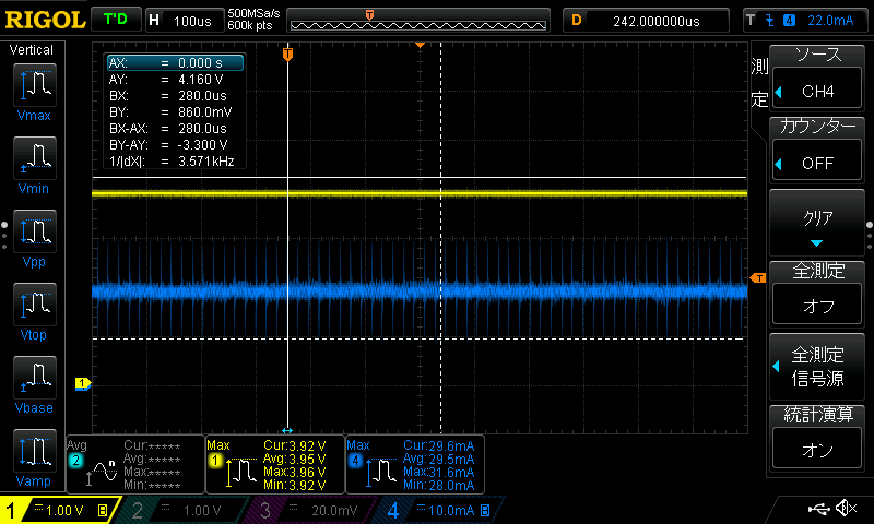

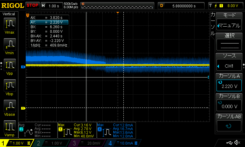

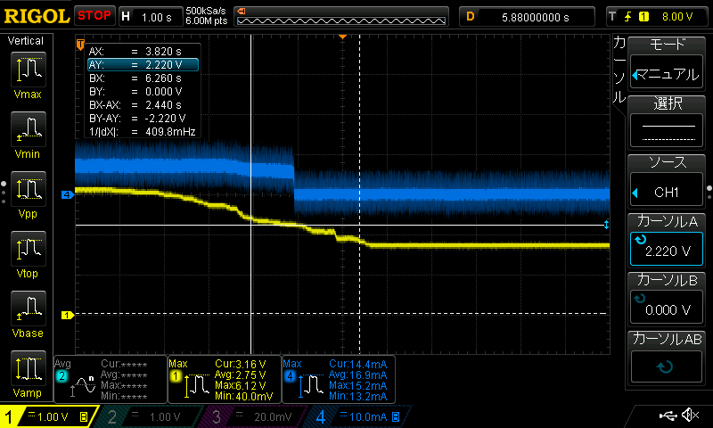

Thanks for reply!. I have examined it in more detail. 1. F/W I tried reinstalling Rev 19 and Rev 20, but there was no change. 2. Current I compared it with a new board. · High current consumption · Low end voltage (approx. 1.2V) · It does not become standby Therefore, not only F/W but also element failure is suspected. Attach the measurement result. Oscilloscope: rigol DS 1054 Z Voltage source: DDC Current probe: Hantek CC-65 tr_standby.png: trouble DNA75c standby tr_endv.png: troble DNA75c end-voltage. nm_standby.png: New DNA75c standby. nm_endv.png: New DNA75c end-voltage. -
