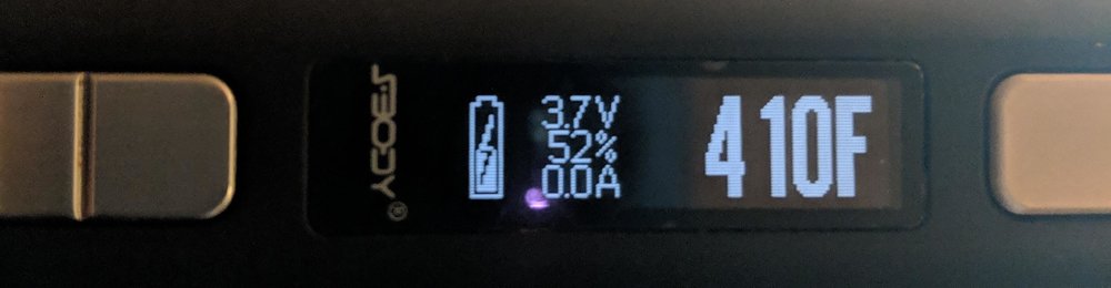

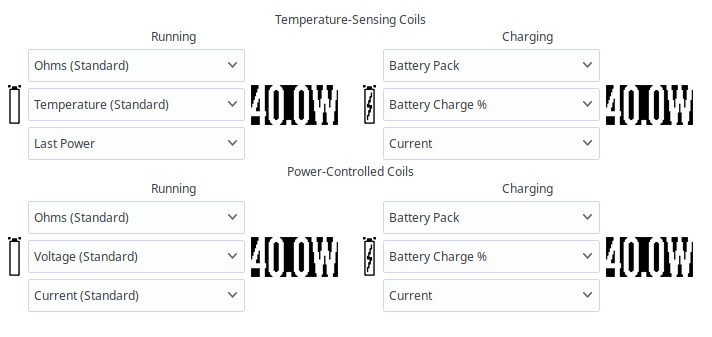

For some reason my Vapedroid (DNA75) doesn't display the charge current on the charging screen. I've had other DNA devices that I've configured the same way as I have this one configured, all of which do properly display the USB charge current. This one just doesn't. Ideas? It seems like such a simple thing, but it's really nice knowing the current charge current.
