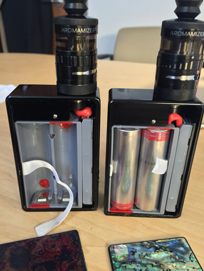

I picked up a few more vt133's myself. Also, if I have a mod like the Efusion Duo w/out reverse battery protection, I like making a good visual indicator to help prevent battery insertion mistakes. I strip the shrink wrap and paint red rings on the batteries, then re-wrap in clear shrink wrap and then paint red indicators on the mod's battery tray --> -
