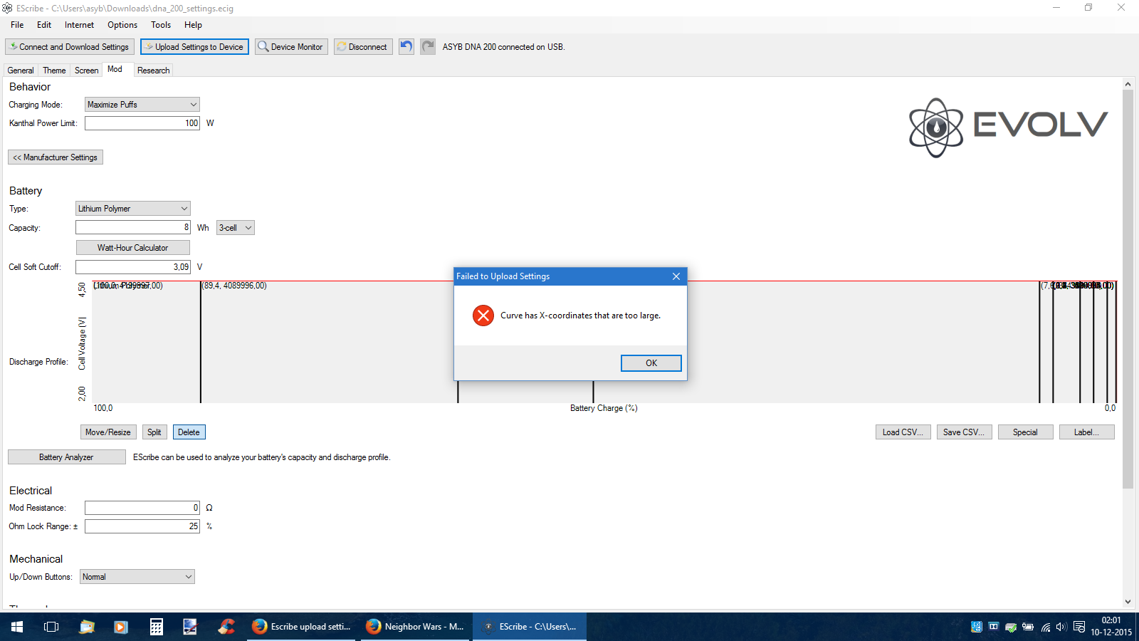

  7. i test the file ,100% the battery discharge curve. try to upload settings to my device no go , with my battery curve a go . this is my error
  8. try last firmware and Escribe . https://www.dimensionengineering.com/software/SetupES_2015-10-21.exe

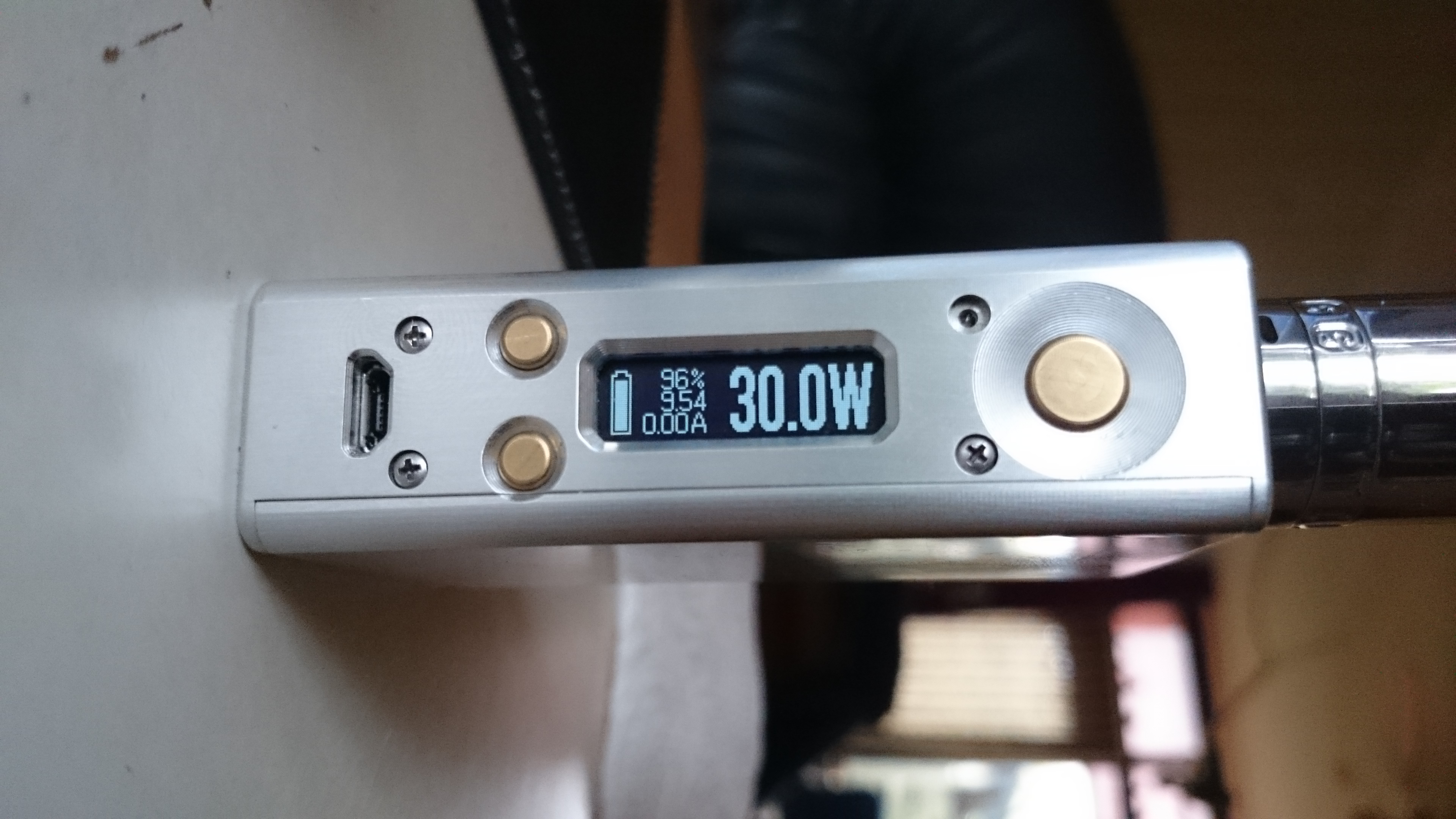

  11. solved !!!!!!!! . Cause = laptop close connected with USB cable = display always on. Solution = USB cord to connect again, and laptop startup = resolved and display go out again. apparently it gets a charge start pulse or something, which is disturbed, when laptop closed connected with USB cable. my own stupid fault so

  13. @ Blueridge dog thank you for your response , sadly I have already checked you tips, but to be sure, once checked, it remains strangely out of nowhere will the screen no more out . thanks for your complements for the millwork
