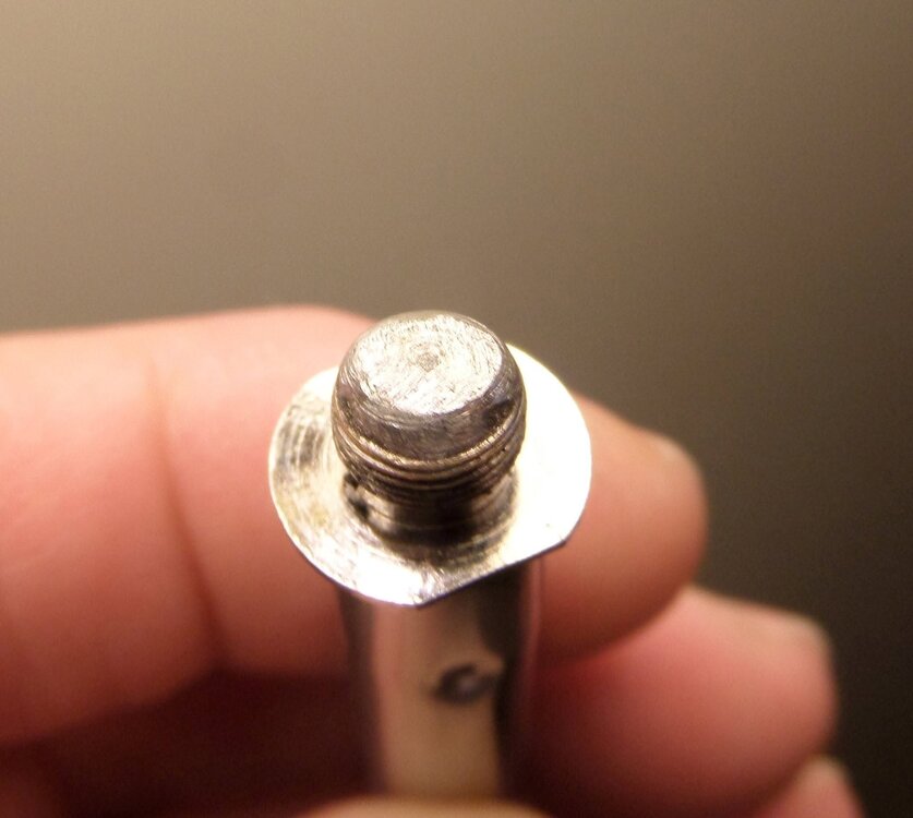

profess0r2000 Posted September 21 Author Report Posted September 21 Thanks! So if I understand correctly, you essentially made your own low-resistance calibration short by silver soldering the 510. Do you use that with EScribe to determine the mod resistance? Also, what resistance does EScribe typically read with yours connected?
dwcraig1 Posted September 21 Report Posted September 21 Yes and yes. Follow directions, first set to zero and upload to device then measure and upload reading to device.
profess0r2000 Posted September 21 Author Report Posted September 21 4 hours ago, dwcraig1 said: Yes and yes. Follow directions, first set to zero and upload to device then measure and upload reading to device. Thanks, that clears it up! I understand the calibration procedure now — set mod resistance to zero, upload, measure with the shorted 510, then enter that reading and upload again. One last question: what type of 510 connector did you use to make your calibration short? I’d like to make one similar to yours rather than guess at the hardware.
dwcraig1 Posted September 21 Report Posted September 21 If you mean what is pictured, it's a Smok dual coil cartomizer.
profess0r2000 Posted September 21 Author Report Posted September 21 Ah, got it — an old Smok dual-coil cartomizer. Thanks! Did you remove/gut the coil and then silver-solder the center connection directly to the outer 510 body to create the short?
dwcraig1 Posted September 21 Report Posted September 21 Yes I removed the gasket, coils and packing. It wouldn't make any difference though. A 510 to 510 adapter or any old atty no longer wanted will do also. You can use the solder of your choice btw. Also it will require a mini torch or a high wattage iron. I used solder and flux for water pipes simply because I had it.
