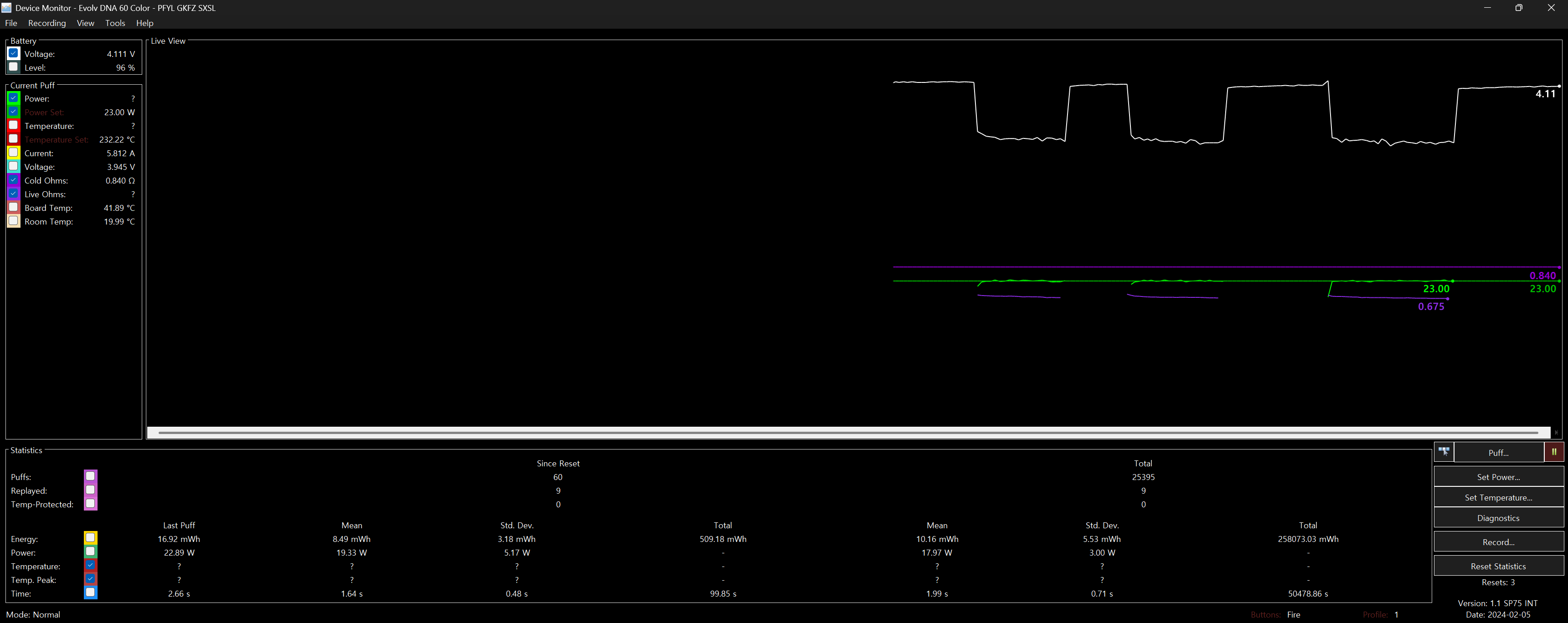

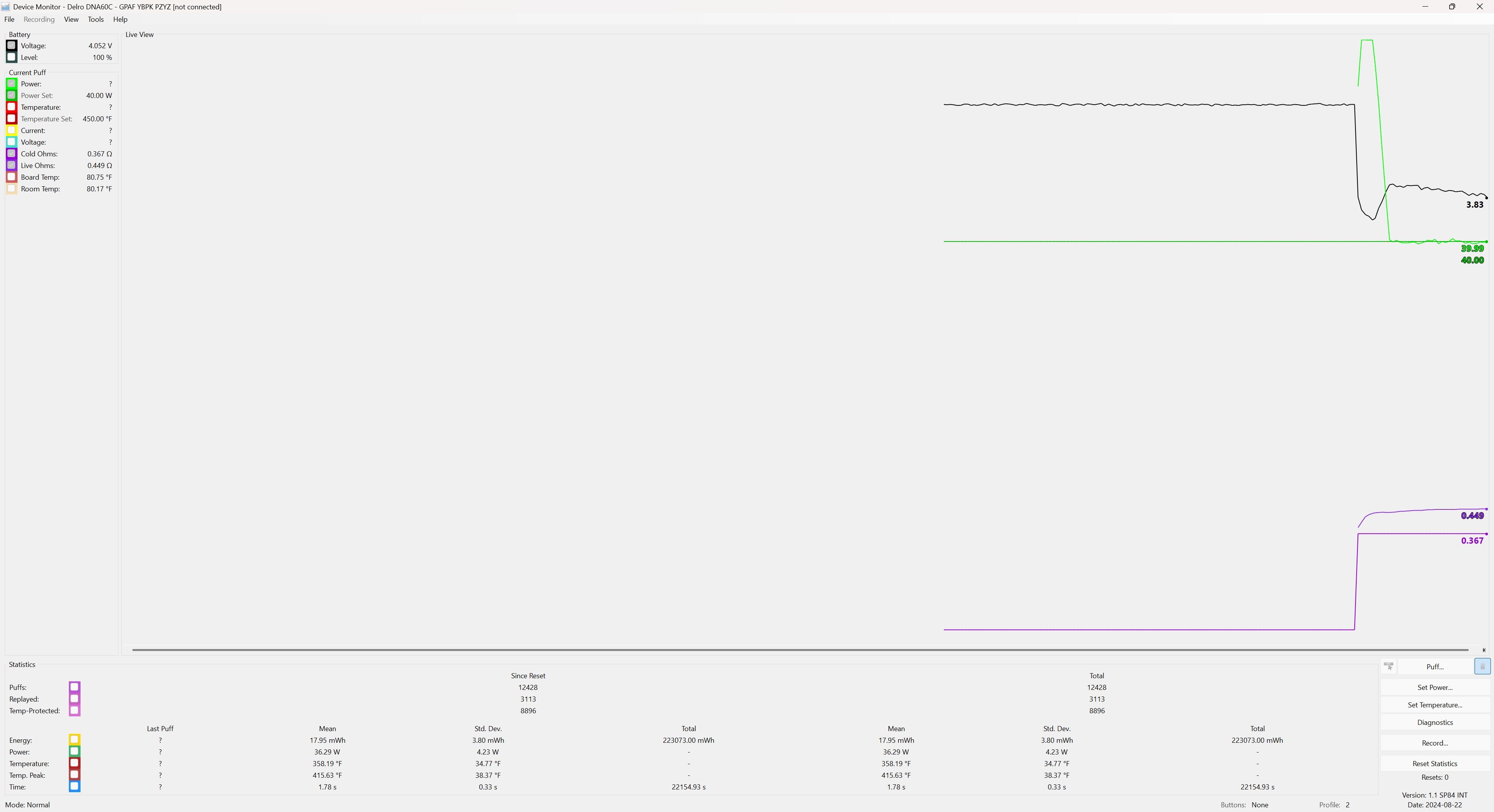

dwcraig1 Posted March 7 Report Share Posted March 7 Would you post a snippet of your device firing in Device Monitor like this one of mine? Maybe include you board and room temperatures in your post as well as your coil material. Link to comment Share on other sites More sharing options...

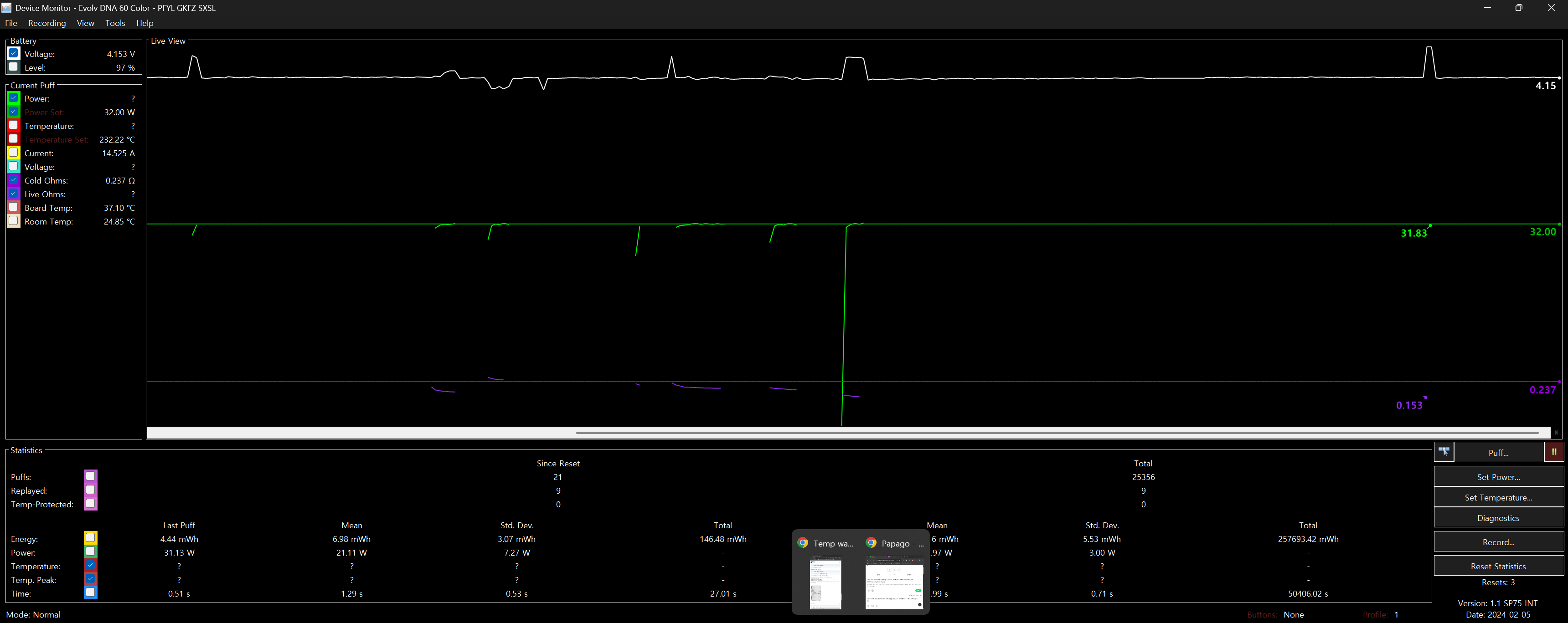

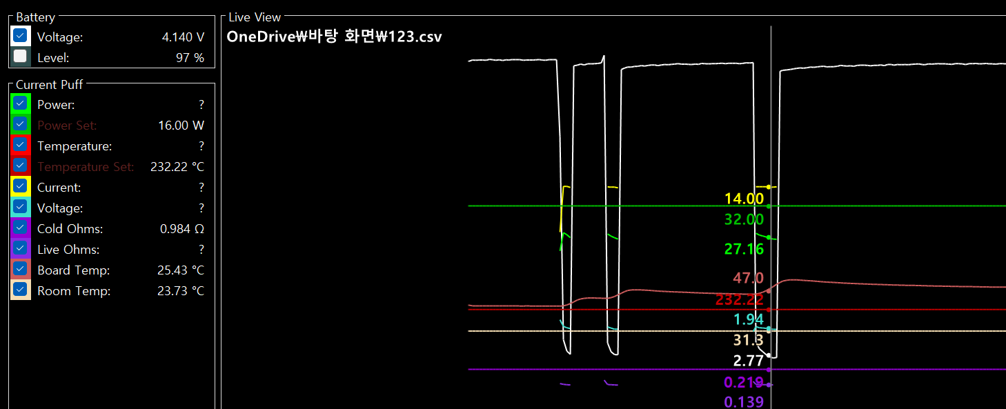

Wayneo Posted March 8 Report Share Posted March 8 11 minutes ago, nicoparkk said: I used pmc coil 0.28 ohm and it worked fine on other instruments. Never heard of this coil. 12 minutes ago, nicoparkk said: Mod Resistance was set around 0.15, as the displayed resistance value was held higher than the actual resistance value. What 'mod resistance'? Are you talking about escribe -> mod -> electrical -> mod resistance? The left side of your screen looks nothing like the right side. Left side shows: 16watts, 0.984Ω coil. Right side shows: 31watts, 0.219Ω coil. Battery voltage drop while firing looks terrible. If that is a .28Ω coil, re-measure the resistance of the coil on the mod. Link to comment Share on other sites More sharing options...
nicoparkk Posted March 8 Author Report Share Posted March 8 5 minutes ago, Wayneo said: What 'mod resistance'? Are you talking about escribe -> mod -> electrical -> mod resistance? Yes, that's what you said. 6 minutes ago, Wayneo said: The left side of your screen looks nothing like the right side. Left side shows: 16watts, 0.984Ω coil. Right side shows: 31watts, 0.219Ω coil. I've already broken up the bridge. So that's what happened to get the recorded data I wrote yesterday. The right side is the data that had the problem. 10 minutes ago, Wayneo said: Battery voltage drop while firing looks terrible. What should I do to solve this? Link to comment Share on other sites More sharing options...
dwcraig1 Posted March 8 Report Share Posted March 8 1 hour ago, nicoparkk said: 1 hour ago, Wayneo said: Battery voltage drop while firing looks terrible. What should I do to solve this? Your battery voltage drop. Either your cell is really weak or there is a poor connection between battery and board. If this battery works well in another mod then check that it's tight enough against battery contact. Check all battery connections are clean. With a load of 27 - 32 watts I would expect to see voltage drop to about 3.8 volts or higher with a cell that's nearly fully charged. Link to comment Share on other sites More sharing options...

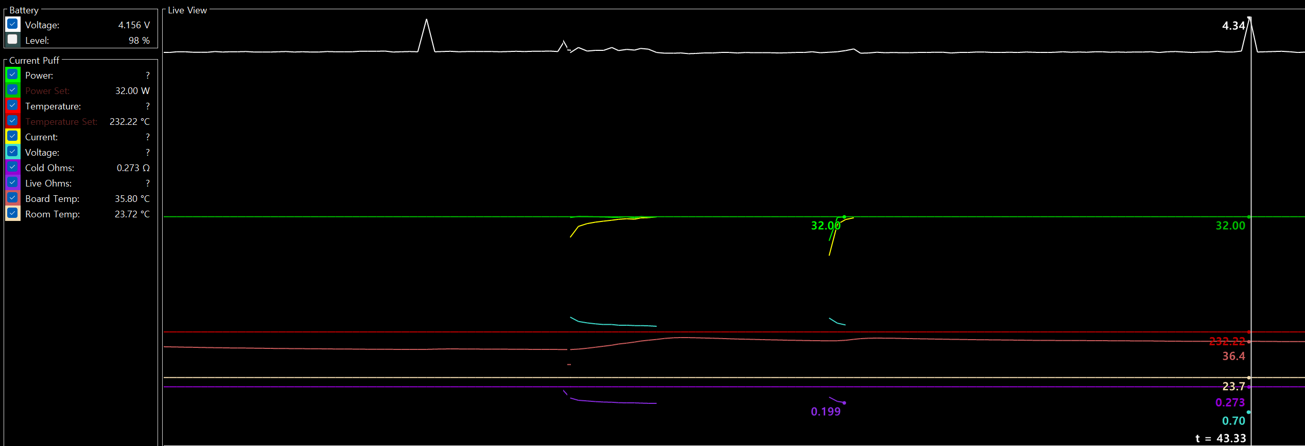

Wayneo Posted March 8 Report Share Posted March 8 21 hours ago, nicoparkk said: I'm using a clone Billet Box DNA60c. What manufacturer makes this? Post link. 21 hours ago, nicoparkk said: ....... when 0.28 ohm is signed to the steamshell.(Watt mode) So is that a hand wrapped coil in an RBA or a stock coil in a bridge? Did you change "mod resistance" ? How did it get to 0.15? And what is it now? I need you to use 'escribe' words. What do you mean by "Initialized all settings." ? What do you mean by " .... something is off." ? Finally, I'd like to see a FULL Device Monitor screenshot like DWCraig posted way up top, with only these 5 parameters clicked. Link to comment Share on other sites More sharing options...
nicoparkk Posted March 9 Author Report Share Posted March 9 Sorry, wrong words because I'm using a translator. The manufacturer is JHFWI. This coil is a fused clapton, handcrafted coil. 12 hours ago, Wayneo said: What do you mean by "Initialized all settings." ? What do you mean by " .... something is off." ? Initialized all settings -> Restore Defaults This data is when the drip tip is loosely tightened. When tightened, the BATT warning is on display. Link to comment Share on other sites More sharing options...
Wayneo Posted March 9 Report Share Posted March 9 Thank you for all that you cleared up. Yesterday your Device Monitor showed differently to today. When you pushed the fire button, the voltage dropped (as it should) Today when you pushed the fire button, the voltage went up, no sag (which is backwards/odd/wrong) and it shows your coil losing resistance while it should be staying the same or increasing. Yet you say your 0.8Ω stock coil works fine. Do you have any other RBA's you could try in this mod OR any other DNA's you can try with this RBA? That drip tip should always be snug, not superman tight. Link to comment Share on other sites More sharing options...
