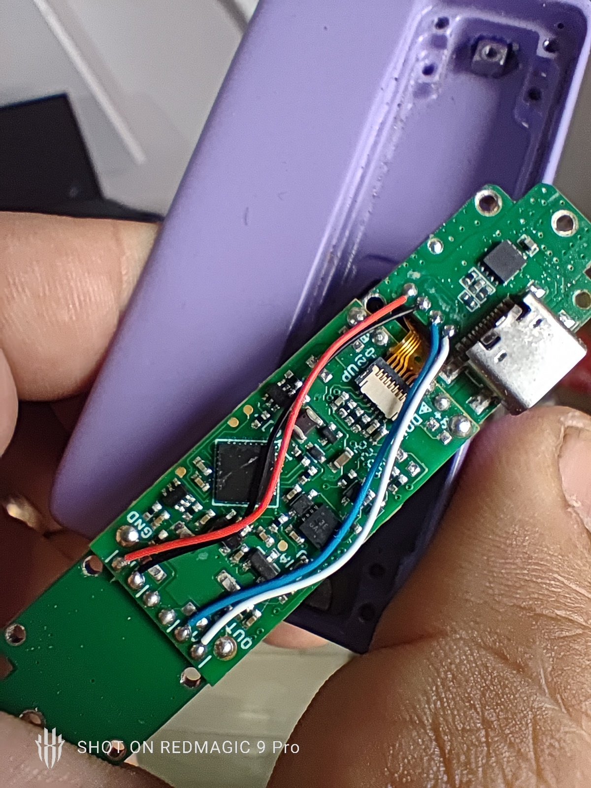

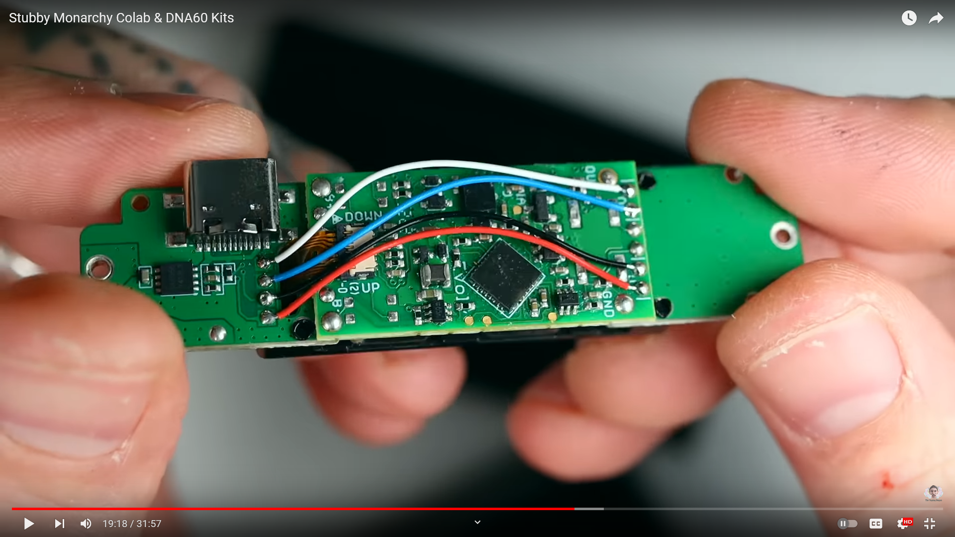

BillW50 Posted June 24, 2024 Report Posted June 24, 2024 3 hours ago, Guedslu1 said: I've already tested all the computer cables and it's the second kit I purchased, the first one works without a problem, this one just keeps loading and doesn't connect to the program or install the drive It should connect to EScribe by the board alone without being installed in the Stubby too. There are four wires between the Stubby board to the DNA60 board that controls data. And something is wrong there if EScribe still can't connect by the board alone. I have two of those boards and mine hasn't been unboxed yet. But Wayneo is right, the place you got it at is the place to go. Although Evolv by filing with the HELP DESK is another option to try if the first option fails. I think I would check those wires first. If ok, maybe they wired them to the wrong place, like getting two wires reversed. 2 1

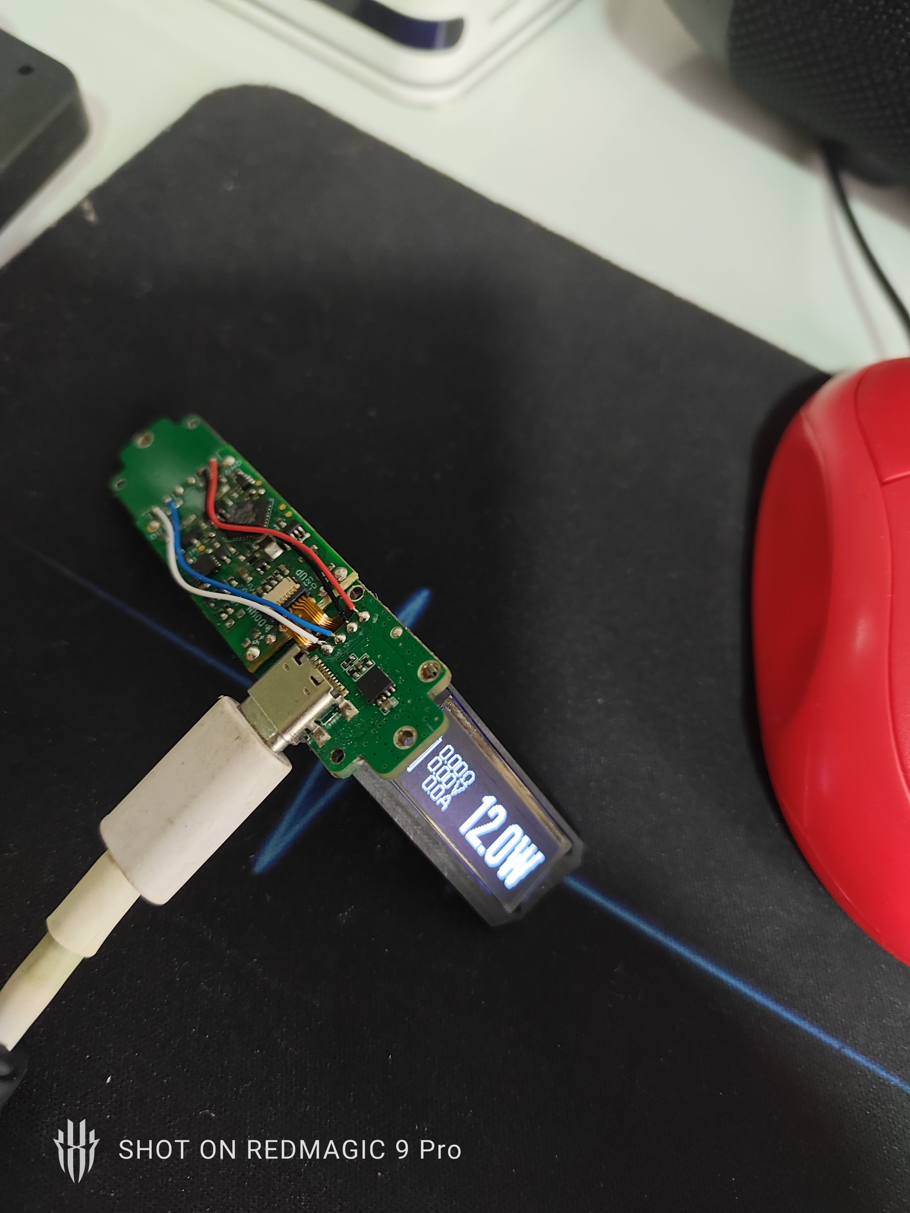

Guedslu1 Posted June 27, 2024 Author Report Posted June 27, 2024 Em 24/06/2024 em 18:16, BillW50 disse: It should connect to EScribe by the board alone without being installed in the Stubby too. There are four wires between the Stubby board to the DNA60 board that controls data. And something is wrong there if EScribe still can't connect by the board alone. I have two of those boards and mine hasn't been unboxed yet. But Wayneo is right, the place you got it at is the place to go. Although Evolv by filing with the HELP DESK is another option to try if the first option fails. I think I would check those wires first. If ok, maybe they wired them to the wrong place, like getting two wires reversed. Iunfortunately it only appears charging, it seems that the wires are correct as in the photo
