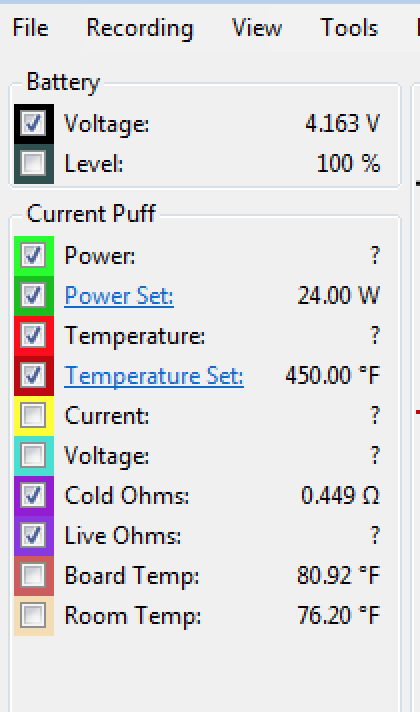

Wayneo Posted March 11, 2024 Report Posted March 11, 2024 With a cold coil (ambient temp) Start escribe and go to your current profile. Do a full screenshot. Scroll to the bottom of the page. Start/click Atomizer Analyzer. Tell me how much it fluctuates over a 2 minute period. It will fluctuate. Start Device Monitor. Enable the checkboxes below. Take a puff. Pause Device Monitor, scroll back to the puff. Do a full screenshot. Thanks. 1
