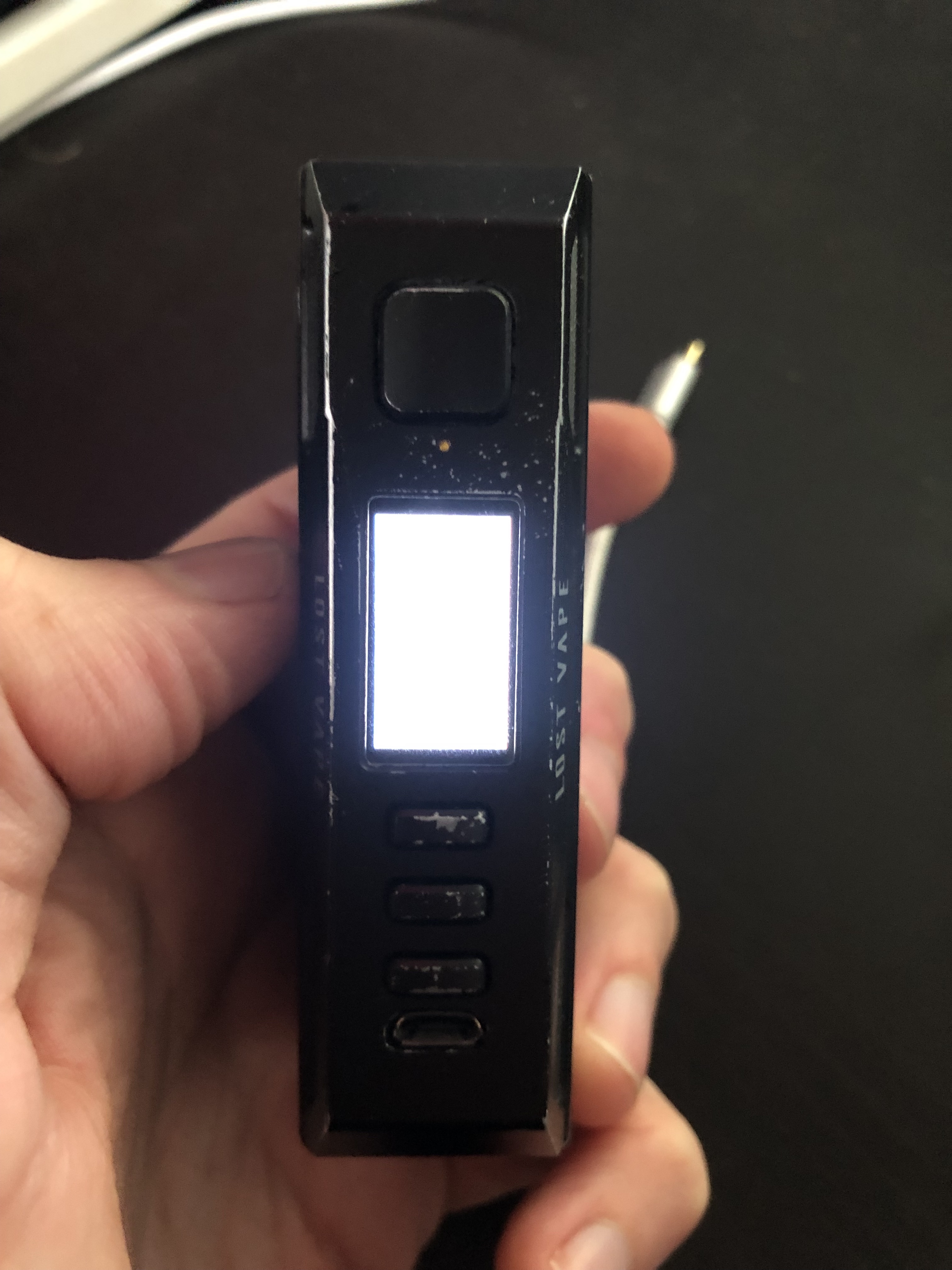

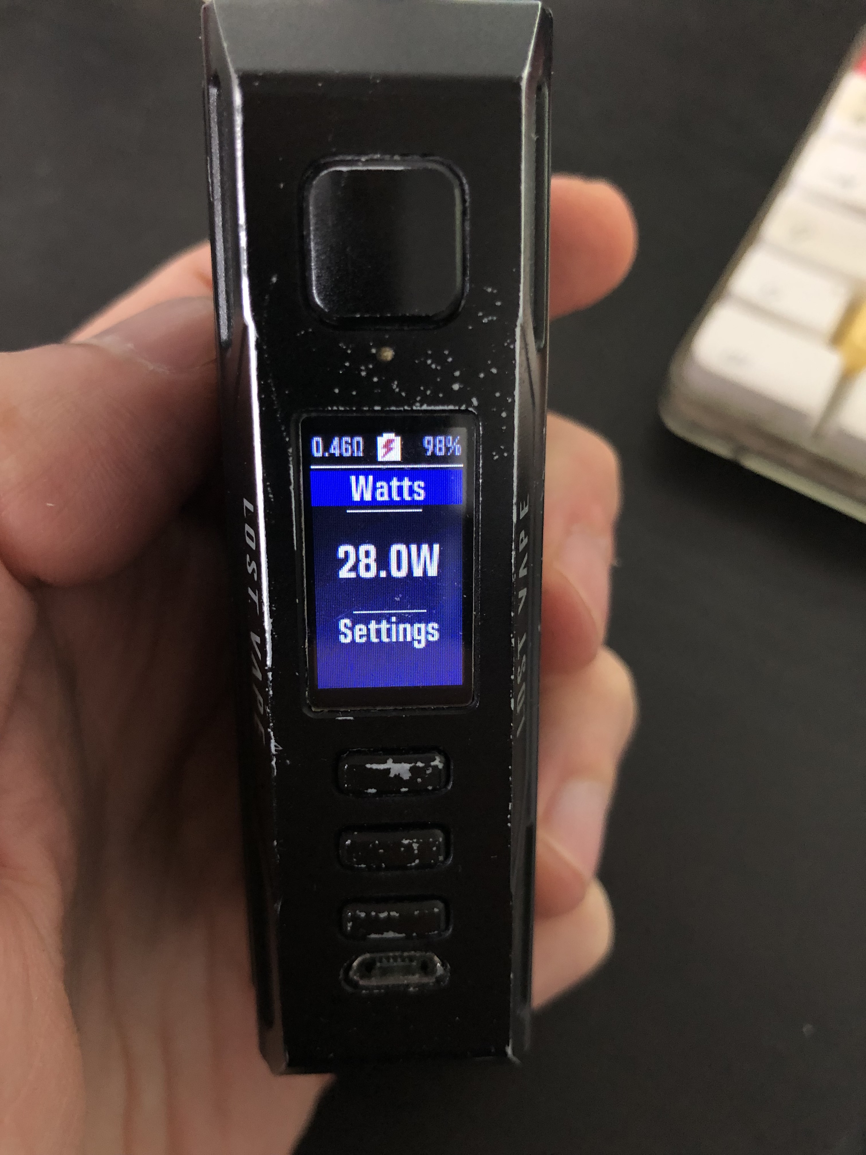

Kukrapoc Posted August 4, 2023 Report Posted August 4, 2023 (edited) Hello, I had a strange bug for a few days with my LOST VAPE THELEMA DNA250C, I had it since 2 years, and no problem until these days. A charging symbol was permanently lit, but the box was not in charging mode. No consequences on the vape, but only on the percentage of battery, it remained stuck on a number, and descended by leaps from time to time. I'm on two 18650 batteries. Of course, I try different kind of set of batteries, I had multiples kind of it, LG ( brown ) , Efest ( purple ), but nothing changes. I tried to plug it in using the mini usb cable on the electrical outlet, but no lights came on. Charging was not working. I cleaned everything with Isopropylic alcohol. Then I removed the batteries, and simply connected to the computer to open it on Escribe. It was detected by the software, after the test on 6 usb cables... Wanting to do a reset, I "apply service pack" but the cable disconnected during the transfer. Following this, the thelema box is on a black screen, even with the cable connected to the computer, and with the batteries. Of course, it is no longer detected by Escribe. Anyway, long story short, it just doesn't work anymore. How to restart the chipset and reconnect it? Thanks in advance if you provide me some advices ! Here is the photo of the recharge symbol I got before the trying to reset and fail: (the box had a lot of scratches, but never felt on the ground) Edited August 4, 2023 by Kukrapoc 1

Kukrapoc Posted August 9, 2023 Author Report Posted August 9, 2023 Hey, thanks for the tip ! I try this and it's working. But I've got a white background after this manipulation. Can I process an hard reboot after this ?
Kukrapoc Posted August 12, 2023 Author Report Posted August 12, 2023 Hey ! quick update ! After trying to hard reboot from the first line of your proposal, the device shutdown and be completely black. After trying with multiple other micro usb cable, nothing worked.. But suddenly, at the last attempt, after first, pluging the only cable who works, and then launch Escribe, it's working ! I apply the last service pack and now the device run normally with no charging symbol, and seems totally workable ! Thanks a lot for your advices for a simple newbie. 1

Kukrapoc Posted August 19, 2023 Author Report Posted August 19, 2023 Well... quick new update, The charging symbol is reappearing... So, I'm facing the same issue as beginning...With my usb cables, it's so capricious, that I'll leave it like that for the moment...

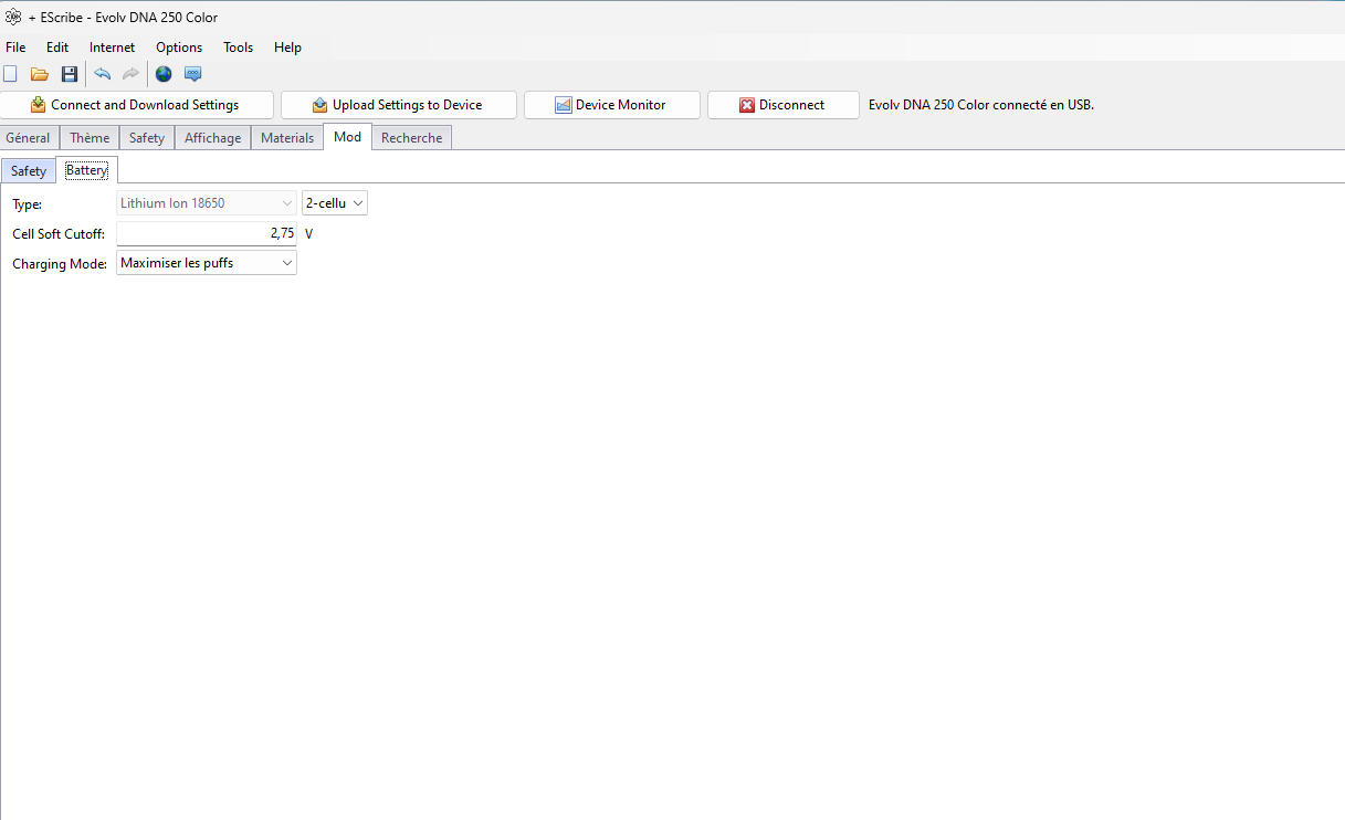

Wayneo Posted August 19, 2023 Report Posted August 19, 2023 escribe -> mod -> battery tab. Shuts off internal charging completely. Upload settings to mod. 1
Kukrapoc Posted August 28, 2023 Author Report Posted August 28, 2023 Hi, it's me again ! I don't find the option where you indicate ! escribe -> mod -> battery tab. Where am I wrong ? I test in windows and Mac... There is maybe a command line with the serial terminal ?

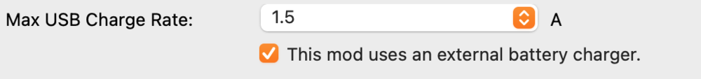

Kukrapoc Posted August 28, 2023 Author Report Posted August 28, 2023 Ahh that’s why ! thanks for the info. there is a way to do it otherwise ?
Wayneo Posted August 29, 2023 Report Posted August 29, 2023 20 hours ago, Kukrapoc said: there is a way to do it otherwise ? Yes, but IIRC it does not survive a battery swap. But you can test that yourself. Escribe - Device Monitor - diagnostics - disable USB charging. 1
Kukrapoc Posted September 2, 2023 Author Report Posted September 2, 2023 Thanks ! I found it ! But even after clicking, the weird symbol reappear... So, I let it like this....
