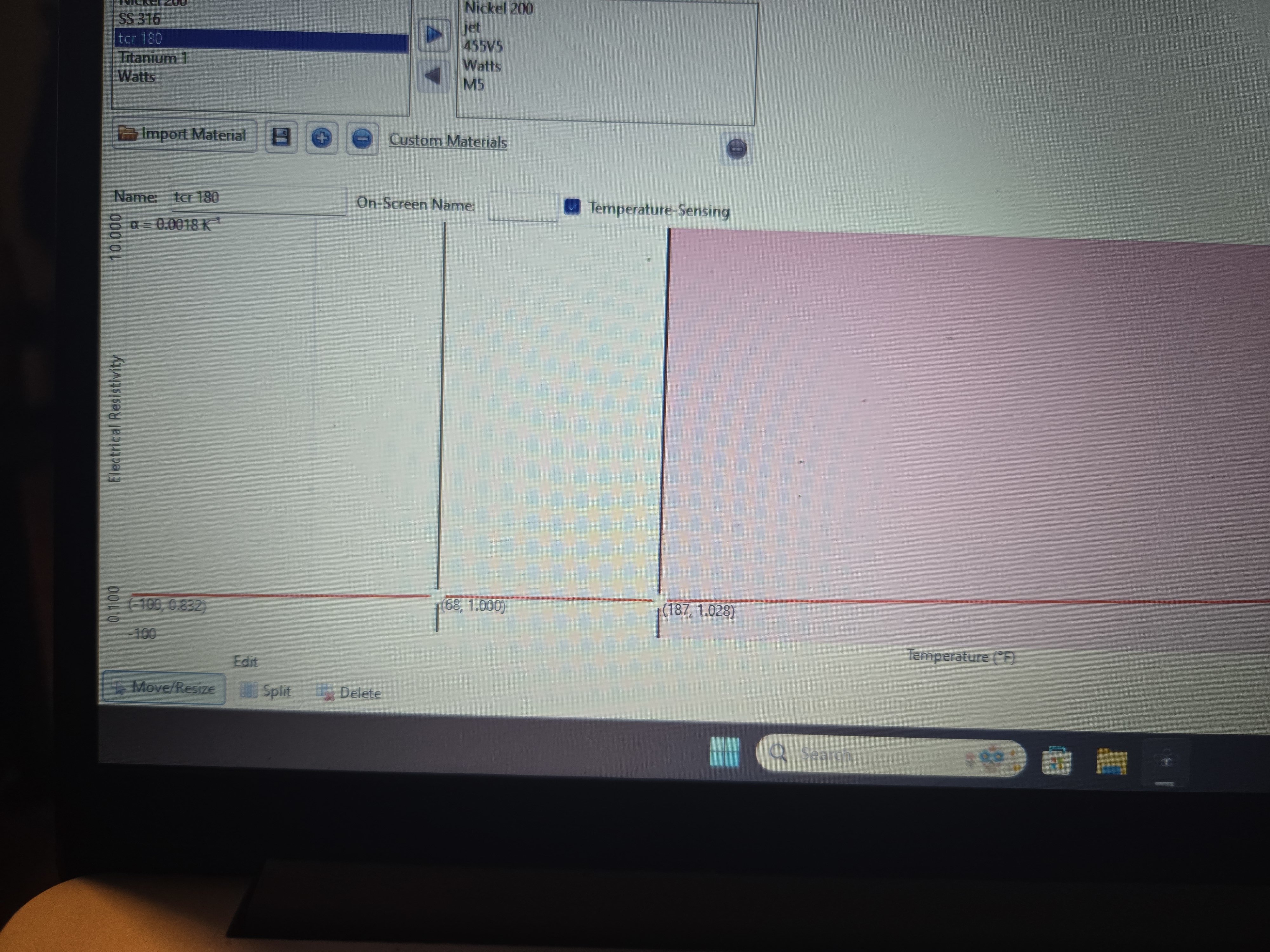

balt Posted November 3, 2024 Author Report Posted November 3, 2024 So just went on the divine tribe server and it looks like they aren't even using this workaround anymore it used to look like this for the tcr profiles. You would creat a tcr profiles bottom right corner for temp coefficient. 180tcr would be 0.00180, 200tcr would be 0.00200. And them you just add a point around 200degrees that is close to your room temo coefficient. But it looks like they aren't even doing that anymore. I'll post the new info they give out

balt Posted November 3, 2024 Author Report Posted November 3, 2024 This is what they are telling people to do now. I have been out the scene for a little while now I just use my custom profiles but every cup is different.
balt Posted November 3, 2024 Author Report Posted November 3, 2024 5 minutes ago, RicketyPumpkin said: divine tribe website has a random link to vaporninja and that literally just Literally tell you how to input a custom material in escribe. I'm just trying to understand the relationship between the 200 degree point versus where the TCR needs to be at that 200 degree point in relation to an overall TCR value of 200. Or does it not matter? Can I simply make it any acceptable value that's an upward curve from the first point? Obviously without going over there requested tcr of 200? The 200 degree point needs to be close to your room temp coefficient number. So the mod thinks it's at 200 degrees when it's only actually around 100 or so. That's why you had to do the cotton test and try with a couple different TCRs. But it looks like now they are just telling people to crank up the wattage
RicketyPumpkin Posted November 3, 2024 Report Posted November 3, 2024 3 minutes ago, balt said: The 200 degree point needs to be close to your room temp coefficient number. So the mod thinks it's at 200 degrees when it's only actually around 100 or so. That's why you had to do the cotton test and try with a couple different TCRs. But it looks like now they are just telling people to crank up the wattage So which do you agree with? Now I completely understand the relationship between TCR and tricking the device, the answer was it was relationship with room temperature that's the part I was not understanding and nobody could tell me what that answer was until you did. I appreciate so much that you took the time to get those screenshots for me, I'm not sure what's going on with my connection to divine tribe but if I click any of their hyperlinks, I get a 404 error and it's not finding anything so I literally couldn't get these or join their discord through the link no matter what. I'm really uncomfortable with cranking my wattage up to 55 watts that seems a Little excessive and definitely is going to take that lifespan way down on that cup. Currently the XL I'm running Is around 4 months old and still looks brand new on the inside after a burn off and cold resistance is still a 0.44 which is the exact same as when I first plugged it in. I suspect that this 55 watt recommendation or ceiling is going to result in dramatic resistance increasing and a lot of cracking of the cups. I've had a cup crack at 0.82 During a burn off set only at 40w and in the first 60 sec of autofire. So I'll definitely order a probe, like a proper one but without spending another 100 bucks i'd rather just stick with Arctic Fox at that point, but I found some decently rated temperature probes with display readouts for not too much on Amazon so I make that happen do you agree that the best course of action would be the material modification, then cotton bud test every say 2-3w? Also if I get a burnt Q tip before the device keeps TC, I would obviously just stop there and go back to using my cheap Arctic Fox mods that I have several of until a better way is put out by evolv. I suspect they're holding off on that because of the cricket and it's claim of two seconds until vapor production and five seconds before you can put it back in your pocket. They wouldn't want any plain old 250C to be able to do the same exact thing that the $300 cricket does so I would just stick to wattage mode I guess or go back to what I was using before I spent $170 on this paperweight! nah I'm Still extremely impressed by this mod but yeah I already have everything else I already have the theme that unlocks every single feature that they programmed into the board and I've done everything else stated in those screenshots just from my prior knowledge of how crucible style atomizer's work. At least I know I could always sell this mod, DNA chipped devices hold value better than any other brand, especially nowadays the lost vape DNA's, So I could always recoup at least a bit of my money in worst case.

balt Posted November 3, 2024 Author Report Posted November 3, 2024 11 hours ago, RicketyPumpkin said: So which do you agree with? I always just mapped out my own cups using tfr and a thermocouple. It was like 12 bucks on Amazon and only took about 10 mins per cup. I never liked the TCR " work around trick" cause it was never accurate and temps would climb and be all over the place. I definitely don't think it's a paperweight. Those are the manufacturer instructions in the screenshot I posted And many people are having sucess with higher wattage. The device will stop adding wattage when it sees that it is at desired temp and u will only only "autofire" for about 30 seconds or so. Just make sure the resistance doesn't climb above .8. That's odd about your cup popping at .81 I always wattage cleaned to .9 and have only had one cup blow because I didn't let it cool down enough before my next wattage pulse 20 minutes ago, Wayneo said: For starters @balt did you ever try 'session mode'. I'd really suggest you ask that dude with a thermocouple and same version crucible to share the material file with you. Could you post a link to their instructions? Yes we tried that and it still wouldn't pass the tsm check because the cup takes longer than 2 seconds to heat up. Every crucible cup is different with different cold resistance (.43-.5) and different TCR values (160-200) it's not a really one size fits all material profike kind of thing. TFR instructions are to plug your device into the pc and view live data. Probe your cup with a thermocouple and wattage fire your device. Fire it until the thermocouple says it has reached 200 degrees and immietely stop. Read the resistance on the live data where the cup reached 200 degrees and write it down. Repeat step again but this time at 300 degrees. Repeat again every 100 degrees until 500. Wirte down these resistance points in a custom material profile and then add a "fake" resistance point around 190 degrees that is close to your cold resistance to fool the tsm check.
