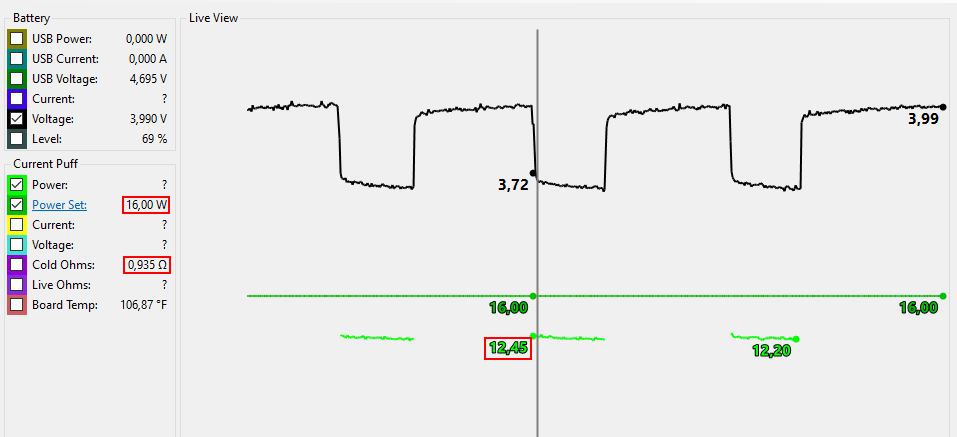

Dear Vaper-Friends!
My question is that (as you can see in the attached pictures), the device refuses to return the set values.
The boost function does not seem to work either. I have reset the default values, but nothing has changed...
If I build to 1.7 ohms, it only outputs 7.7 watts instead of the desired 12 watts. If I use 0.9 ohms, the maximum output is 12.4 watts. Unfortunately, this is just not enough for a satisfying vaping experience.
What could be the reason?
You need to build within the limitations of the chip. So build lower, and if you were to enable volts and current in the 'current puff' section you'll see it. Remember there's not boost for the battery voltage.

Thank you, but it still doesn't work for me...
For my lower ohm (0,935) build:
If: W=V²/R, then: 3.7²/0.935=14.6 and not 12 watts...

23 hours ago, Wayneo said:
See that 3.7V reading. Move your cursor 1/3 of the puff to the right and take another reading.
Oh...
Dear Wayneo!
I'm starting to understand (really slowly 🙂). Thank you!
So, do you mean:
3.45² (V) /0.967 (Ω) = 12,3 W... Thats why i cannot reach 16W?
So, do you mean:
Yes, with just 1 slight change. On the DM you see 'cold ohms' & 'live ohms'. I'll use that 'live' value from your last puff. (Which is odd, because the 'live ohms' should always be higher than 'cold')
3.45² (V) /0.948 (Ω) = 12.56 W or 12.6 W (rounded up) which is pretty close to the 12.61 shown in the 1st puff.
So look at 2 examples. If that coil was .35Ω and .5Ω
3.45² (V) /0.35Ω = 34 W.
3.45² (V) /0.50Ω = 23.8 W
If you can't get there with SS316, there is other material you can use. Something with a higher TCR.
