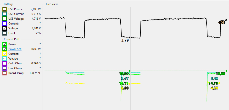

  2. Oh... Dear Wayneo! I'm starting to understand (really slowly 🙂). Thank you! So, do you mean: 3.45² (V) /0.967 (Ω) = 12,3 W... Thats why i cannot reach 16W?
  3. Thank you, but it still doesn't work for me... For my lower ohm (0,935) build: If: W=V²/R, then: 3.7²/0.935=14.6 and not 12 watts...

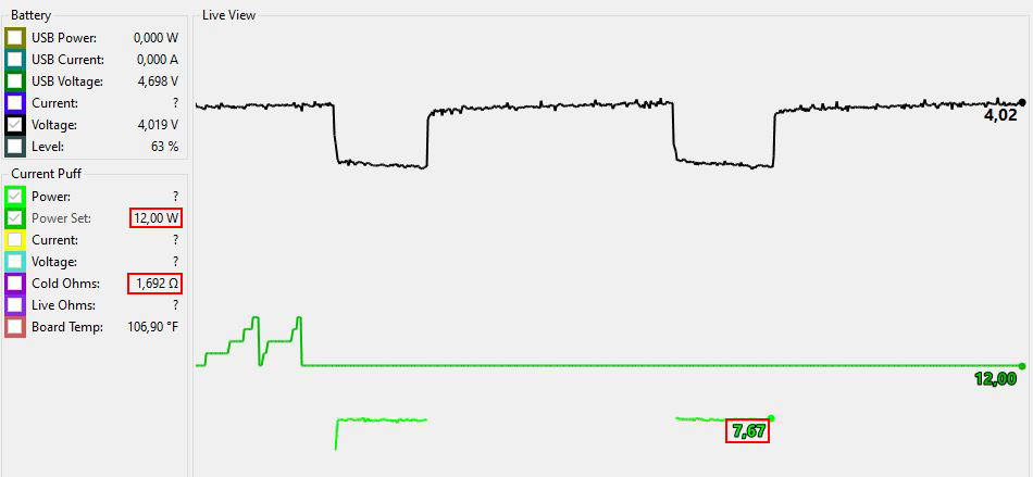

  4. Dear Vaper-Friends! My question is that (as you can see in the attached pictures), the device refuses to return the set values. The boost function does not seem to work either. I have reset the default values, but nothing has changed... If I build to 1.7 ohms, it only outputs 7.7 watts instead of the desired 12 watts. If I use 0.9 ohms, the maximum output is 12.4 watts. Unfortunately, this is just not enough for a satisfying vaping experience. What could be the reason?
