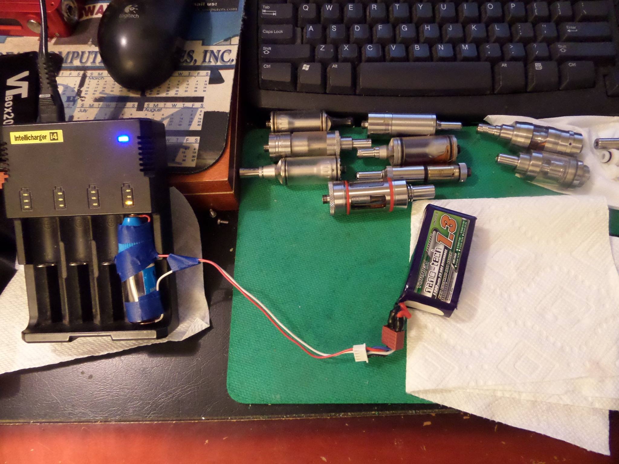

dwcraig1 Posted February 26, 2023 Report Posted February 26, 2023 In this image I used a juce bottle with wires taped to it's ends and placed in a charger. The wires run to the balance plug and connect to the low cell. While this may look a bit crude it worked very well. If you don't want to wait till it balances via mod consider this. 1

dwcraig1 Posted February 28, 2023 Report Posted February 28, 2023 The battery in my post had been hooked up to a small hobby charger and an expensive one with no results. So just what is your concern with my recomended method?

thelateoctober Posted February 28, 2023 Author Report Posted February 28, 2023 4 hours ago, dwcraig1 said: The battery in my post had been hooked up to a small hobby charger and an expensive one with no results. So just what is your concern with my recomended method? Did you solder tabs or something to the ends of the wires going into the charger? How did you get the other end into the JST? I feel like stripping a good enough amount and tinnijg it would be good enough, but I'd be interested to hear how you did it. Also - if I'm trying to charge cell 2, I'm going to be using (starting nearest the battery negative) the 2nd hole as my negative and 3rd hole as positive, correct?

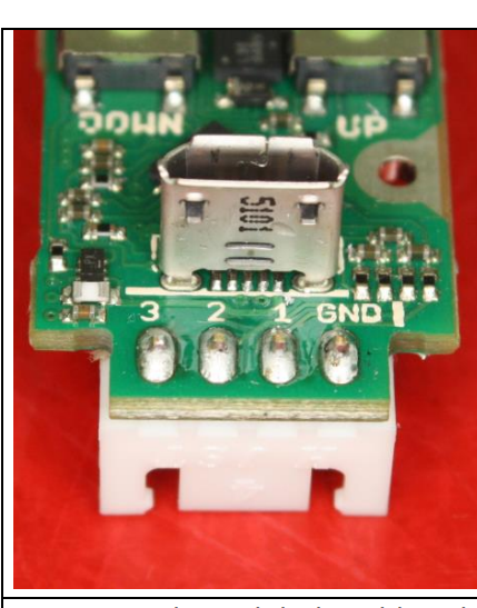

Wayneo Posted February 28, 2023 Report Posted February 28, 2023 44 minutes ago, thelateoctober said: Update - I woke up this morning with cell 2 at 3.98, 0.05v higher than I've seen it yet. So somethings happening, I guess? Yup, that's how balance charging works. Painfully slow. IIRC it'll raise 1&3 to like 4.21 then drop them to 4.19, raise 2 a bit. Rinse and repeat for a long time. From the top of my head, looking at the board battery negative pad, that 1st jst pin is a ground, then cell 1, 2, 3. But I'd wait for @dwcraig1 to validate that. It should show a lower voltage.

dwcraig1 Posted February 28, 2023 Report Posted February 28, 2023 1 hour ago, thelateoctober said: Did you solder tabs or something to the ends of the wires going into the charger? How did you get the other end into the JST? I feel like stripping a good enough amount and tinnijg it would be good enough, but I'd be interested to hear how you did it. Also - if I'm trying to charge cell 2, I'm going to be using (starting nearest the battery negative) the 2nd hole as my negative and 3rd hole as positive, correct? I used a small gauge solid wire, no tinning. Made little circles like elecrtic stove burners for on the ends of the 5 ml juice bottle and simply taped the wire to the side of the bottle. On the battery end I just pushed the wire into the holes on the JST plug and added some tape so they would stay put. Use your meter to find them, they will be next to each other.
dwcraig1 Posted February 28, 2023 Report Posted February 28, 2023 If DNA250 it should be the two center ones. #2 positive and #1 negitive for cell #2 connection
thelateoctober Posted February 28, 2023 Author Report Posted February 28, 2023 13 minutes ago, dwcraig1 said: If DNA250 it should be the two center ones. #2 positive and #1 negitive for cell #2 connection Awesome, thank you. I'm not positive I have any solid wire small enough, but if I tin some of my 24g that should work. Also might have a couple of the ground connectors that go around the 510, those would probably work too. I'm gonna continue with the recommendations from the Maxamps guy for now - if it gets to a point where in just over it il9ise this method. Thank you! One other question, I'll ask Wayne too - when cell 2, the low one, is hitting the cutoff at 3.1 the other two still have 0.4v give or take,, the battery meter still shows 6% and the mod still fires, just not at full power. Should I continue using it to get those other two down to 3.1 or do I need to stop?
