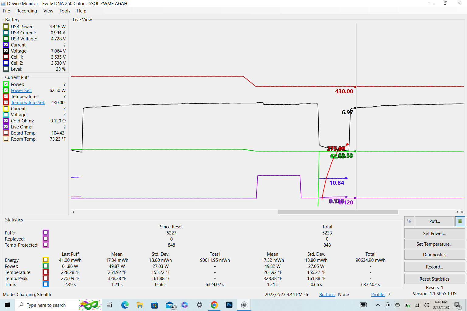

Br114nAcc Posted February 23, 2023 Author Report Posted February 23, 2023 here are the pictures after i got an identical tank just a new one with a fixed 510 pin, it is way more stable, and way faster time and idk if there would be any things that might help with showing what could be up with the ohms of the coil, first is watt with boost then with no boost, second is tc with no preheat

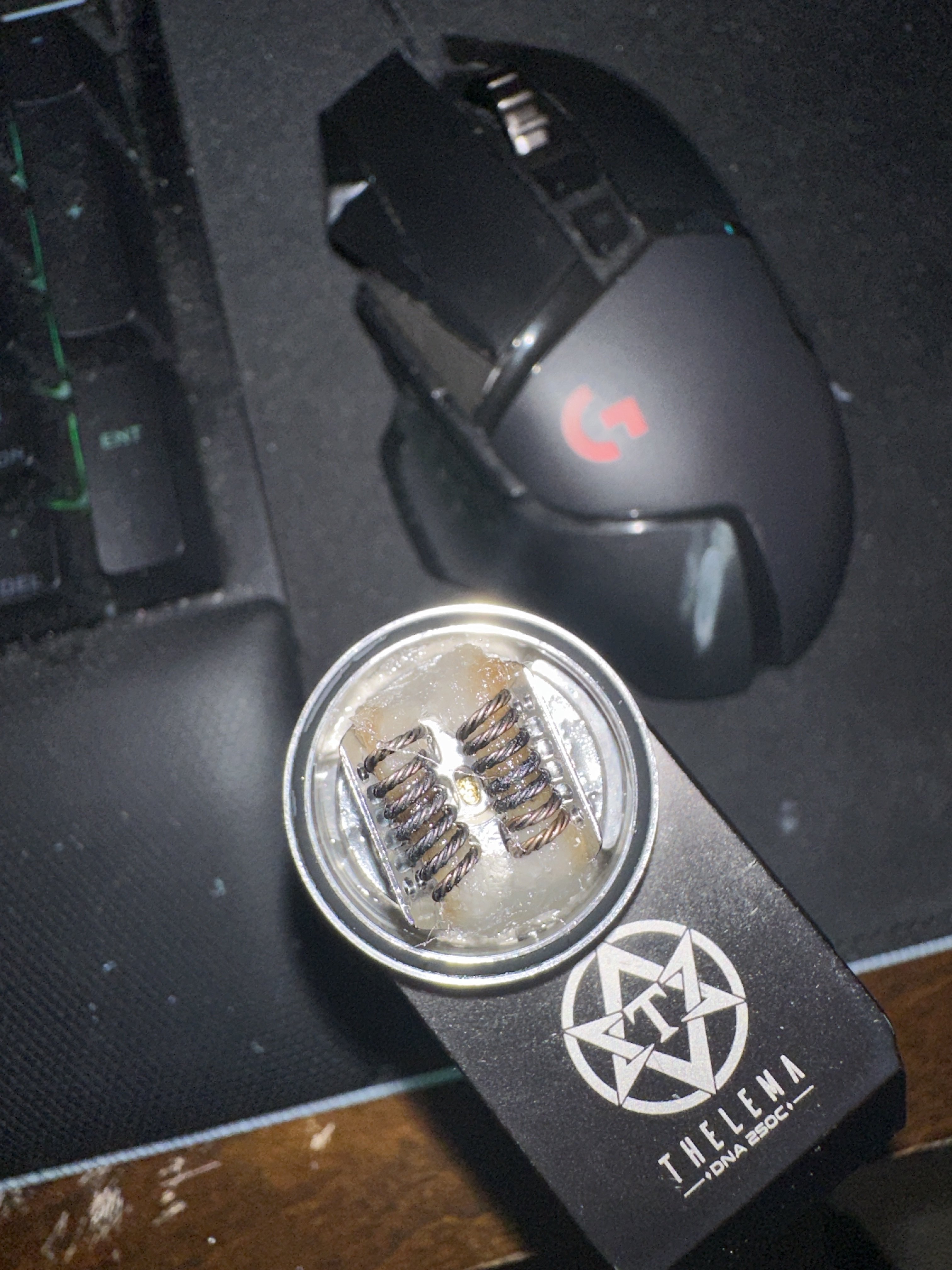

dwcraig1 Posted February 24, 2023 Report Posted February 24, 2023 Are you using the same wire as in your earlier posts? The resistance of 0.12 troubles me. With building the same coil with the same wire but 6-7 wraps instead of 10-11 should be around 0.21 ohms for the pair of coils. Is there any chance they are touching the chamber? Have you checked resistance with the chamber removed, deck only?
Br114nAcc Posted February 24, 2023 Author Report Posted February 24, 2023 On 2/24/2023 at 3:22 AM, dwcraig1 said: Are you using the same wire as in your earlier posts? The resistance of 0.12 troubles me. With building the same coil with the same wire but 6-7 wraps instead of 10-11 should be around 0.21 ohms for the pair of coils. Is there any chance they are touching the chamber? Have you checked resistance with the chamber removed, deck only? Expand i'll check right now, it seemed to have been working recently and last night i was just adding a working replay function to my theme. seems like the only type of vape that gives me a good hit is replay as of right now lol but yes let me check real quick
Br114nAcc Posted February 24, 2023 Author Report Posted February 24, 2023 On 2/24/2023 at 3:22 AM, dwcraig1 said: Are you using the same wire as in your earlier posts? The resistance of 0.12 troubles me. With building the same coil with the same wire but 6-7 wraps instead of 10-11 should be around 0.21 ohms for the pair of coils. Is there any chance they are touching the chamber? Have you checked resistance with the chamber removed, deck only? Expand nope still definitely at .111-.112 ohms constant and raw ohms is .115
Br114nAcc Posted February 24, 2023 Author Report Posted February 24, 2023 On 2/24/2023 at 6:41 PM, Br114nAcc said: nope still definitely at .111-.112 ohms constant and raw ohms is .115 Expand it is quite literally a perfect build it isn't even changing from .111 it is constant for minutes on end
Br114nAcc Posted February 24, 2023 Author Report Posted February 24, 2023 my bad brother i forgot i forgot, this is a 4 strand twist fuck i am stupid as shit i am so sorry for waisting your time, hey but i am pretty proud of my theme i made, i would definitely like to know if a seasoned vaper like you would grade it on a 1-10 scale
