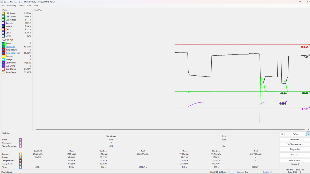

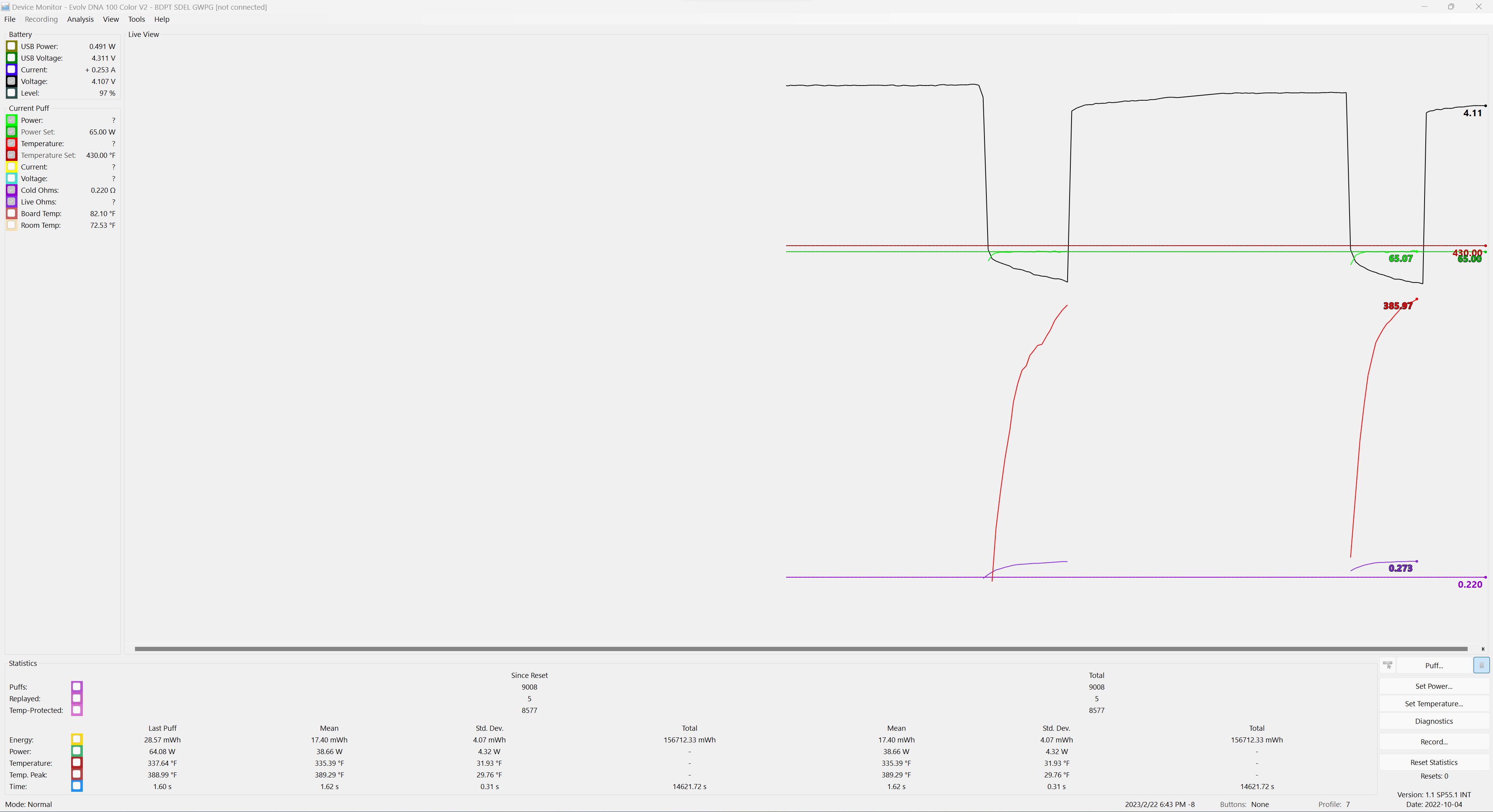

dwcraig1 Posted February 23, 2023 Report Posted February 23, 2023 I use twisted 28 gauge SS430 almost always. Here is a snippet of my dual coil SS430 build firing at 65 watts in EScribe's Device Monitor. My coils are 2.7 mm id and 6 or 7 wraps each. It would be most helpful if you could post a snippet of yours firing with the same boxes checked as mine. DNA100C

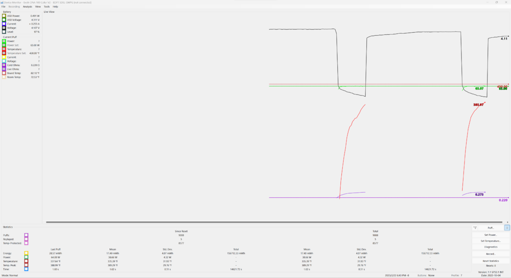

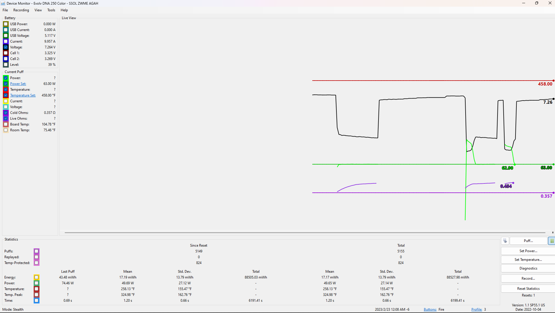

Br114nAcc Posted February 23, 2023 Author Report Posted February 23, 2023 Quote 3 hours ago, dwcraig1 said: I use twisted 28 gauge SS430 almost always. Here is a snippet of my dual coil SS430 build firing at 65 watts in EScribe's Device Monitor. My coils are 2.7 mm id and 6 or 7 wraps each. It would be most helpful if you could post a snippet of yours firing with the same boxes checked as mine. DNA100C Here you go @dwcraig1, I don't know if this is normal or not but i selected the same things and the first hit is without boost the next ones after the first hit are with boost all in watt boost mode (just to get rid of extra confusion added on due to TC.

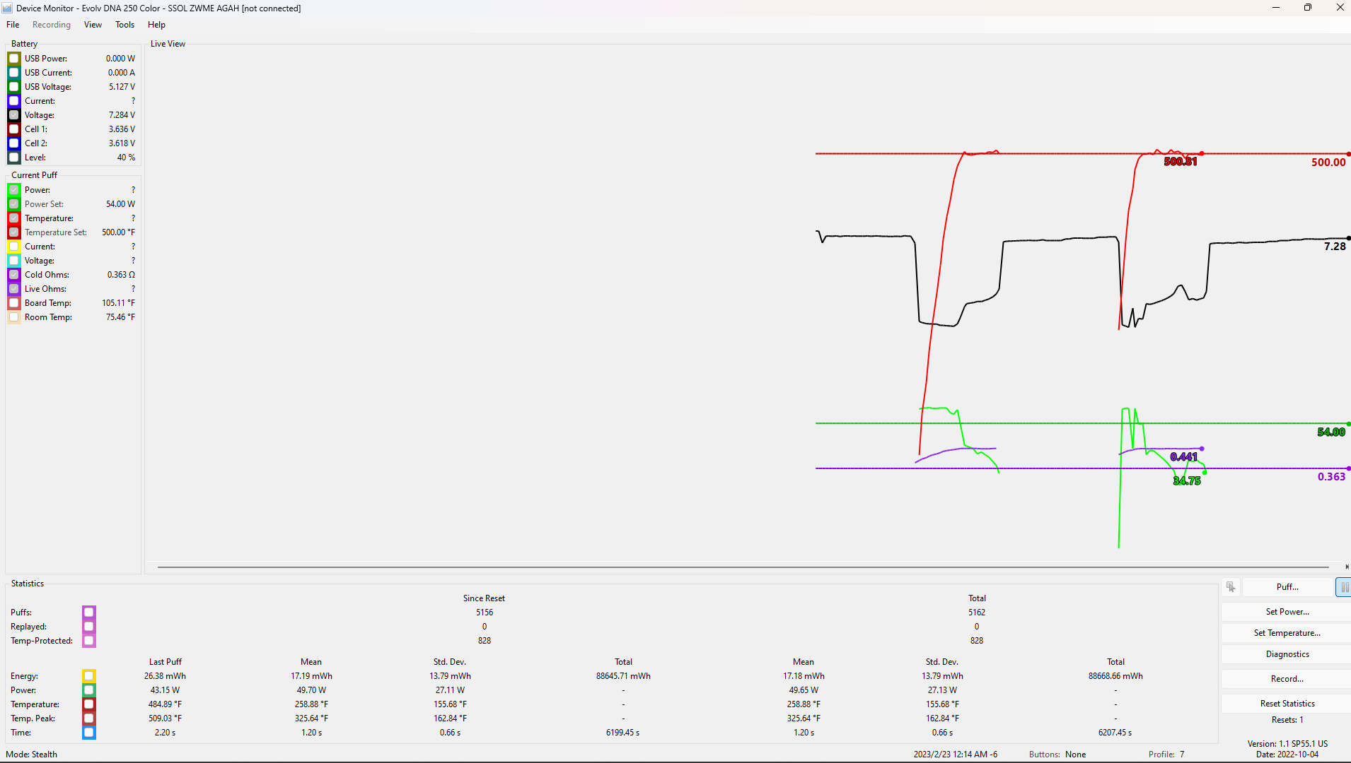

Br114nAcc Posted February 23, 2023 Author Report Posted February 23, 2023 This is in TC mode @dwcraig1
Br114nAcc Posted February 23, 2023 Author Report Posted February 23, 2023 and no I do not usually vape at 500F I usually do 420F-480F but those are all really cold and before I put it on the monitor I was testing out where it would become a warm vape, but yes 54 is normally my watts
dwcraig1 Posted February 23, 2023 Report Posted February 23, 2023 The non TC snip shows some boost and you are getting your 63 watts that it s set to. The TC snip shows it hitting temp setting and throtting down below 54. Check all your connections. Use Atomizer Analyzer to check that your atty's 510 is making contact with the mod's 510 positive pin well before it's screwed in all the way. (and not the last half turn)

Wayneo Posted February 23, 2023 Report Posted February 23, 2023 All your mod, or ANY mod can do is apply power to a coil. That's it, that's all. In your DM screenprints, you have 2 Green lines. The 'power set' and just plain 'power'. Without boost, or preheat (your 1st puff of each type) you can really only tell when you start your puff due to the battery voltage starting to drop. Otherwise, it's a near vertical line. Near instantaneous reaching the watts you set. If I look at your title ".... slow ramp up times with any rebuildable coil in rda, rta, or rdta's" I don't see it from a mod perspective, do you? 2 hours ago, Br114nAcc said: i tightened it when i got it, is it adjustable it is a dead rabbit rta v3 or id it to take out for a squonk pin this is why i tightened it but if it is adjustable maybe that is why And no, 510 positive pins should always be snug. I think your problems are with that atty and coil. 10 1/2 wraps (21 total) and you're hoping your wicking's going to keep up. And with what .... a 2.5mm ID? IT'S NOT YOUR MOD.
Br114nAcc Posted February 23, 2023 Author Report Posted February 23, 2023 9 minutes ago, Wayneo said: All your mod, or ANY mod can do is apply power to a coil. That's it, that's all. In your DM screenprints, you have 2 Green lines. The 'power set' and just plain 'power'. Without boost, or preheat (your 1st puff of each type) you can really only tell when you start your puff due to the battery voltage starting to drop. Otherwise, it's a near vertical line. Near instantaneous reaching the watts you set. If I look at your title ".... slow ramp up times with any rebuildable coil in rda, rta, or rdta's" I don't see it from a mod perspective, do you? And no, 510 positive pins should always be snug. I think your problems are with that atty and coil. 10 1/2 wraps (21 total) and you're hoping your wicking's going to keep up. And with what .... a 2.5mm ID? IT'S NOT YOUR MOD. That's the thing it is showing a normal puff n what not from my mod but with the atty it is slowly ramping up the thing, so what you're saying is my mod settings aren't the problem, my problem is the atty and how can i have better coil building because i am new to it and don't really understand what to look for in a vapable coil like on steam engine everything is always a high heat capacity, but when i try my coils normally they are usually fine just ramp up a bit slow, i agree with you now knowing that my mod is reading normal, my problem is with the coils i am building. But are you saying that my coil is too dense or are you saying it is not dense enough for the cotton to keep up, my problem is my coils will often burn before the cotton does.

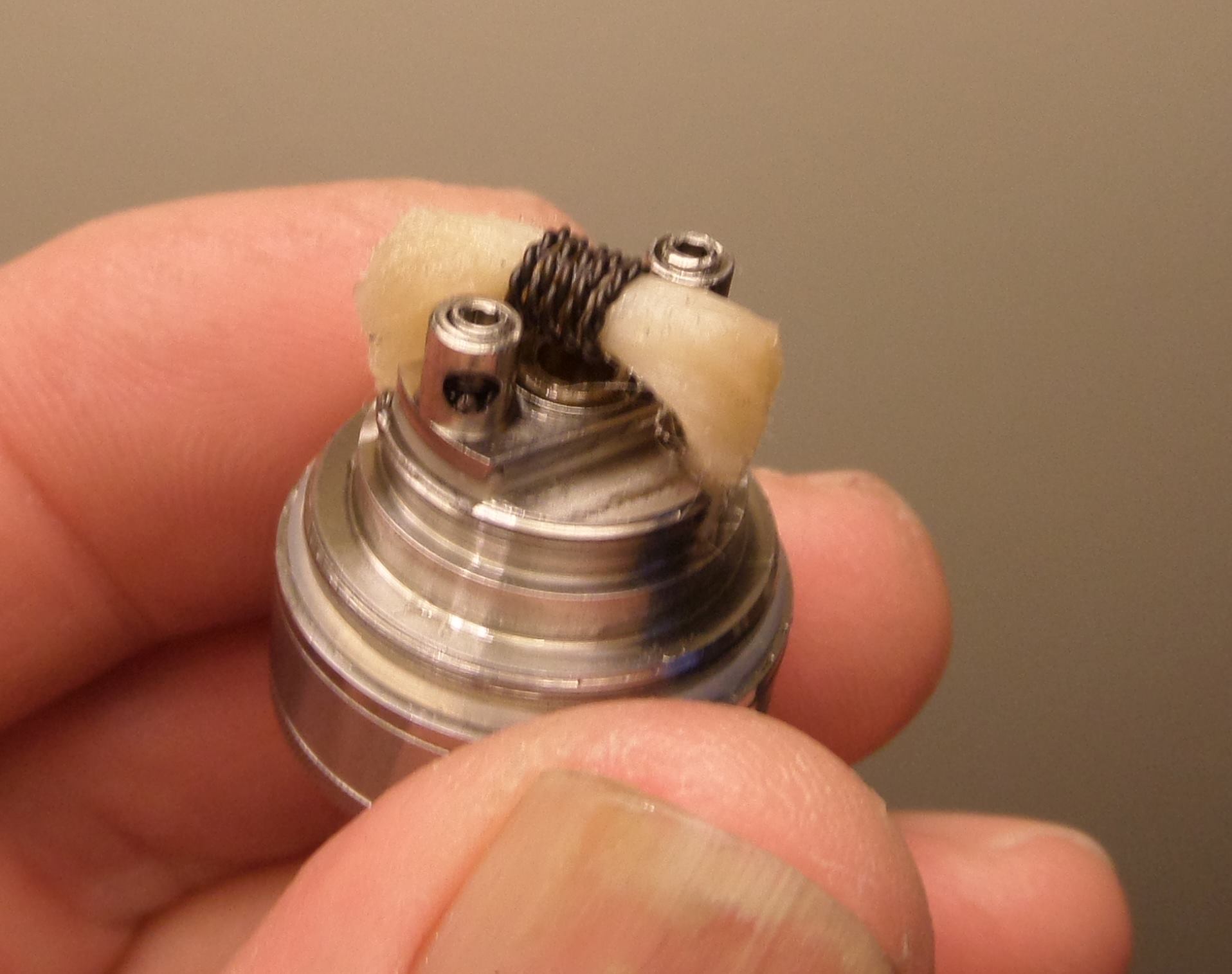

dwcraig1 Posted February 23, 2023 Report Posted February 23, 2023 Here is one of mine from 7 years ago, I twist the wire more these days but pretty much the same as I still do today.

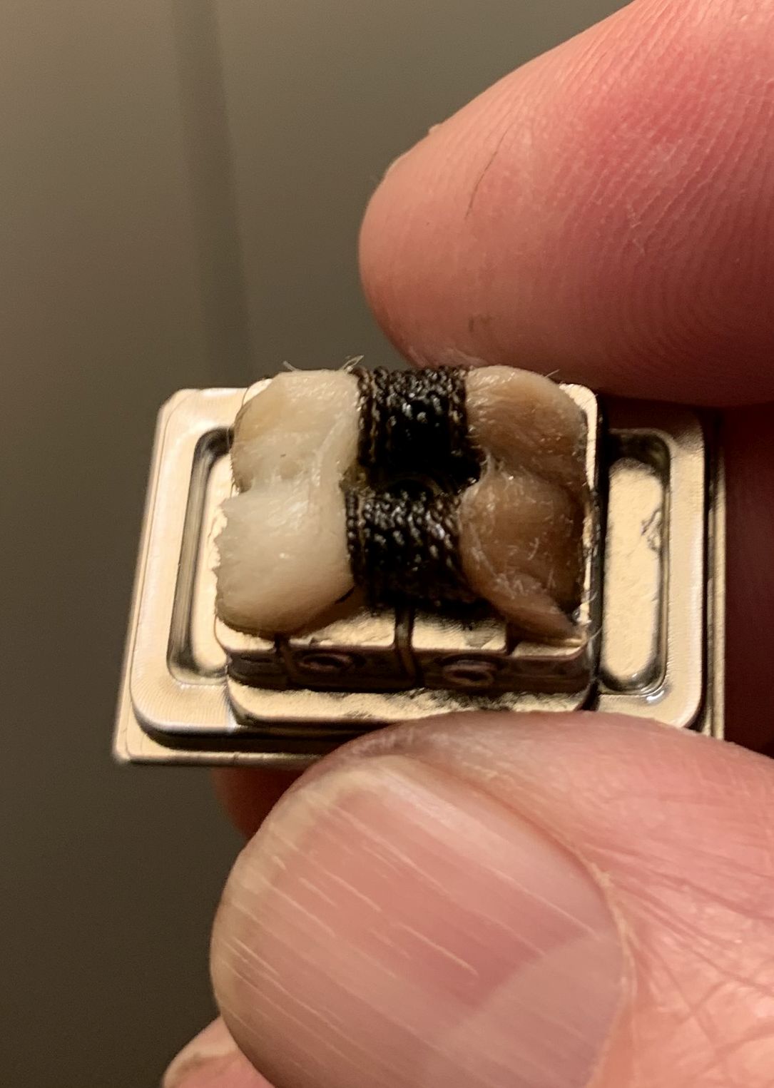

dwcraig1 Posted February 23, 2023 Report Posted February 23, 2023 Here is my first build on my Steam Crave boro, time to re-do it. 2.5mm ID,twisted 28 gauge SS430,0.224 ohms
Br114nAcc Posted February 23, 2023 Author Report Posted February 23, 2023 3 minutes ago, dwcraig1 said: Here is my first build on my Steam Crave boro, time to re-do it. 2.5mm ID,twisted 28 gauge SS430,0.224 ohms thanks for letting me see,mine looks about the same, so that is normal as long as the cotton isn't turning black? and i'll try running it at the watts u said because now i have a spaced 7/6 wrap dual coil with .75 twist pinch and same 28aug ss316L came out to .11 this time i think i might have made the cotton a bit too thin lol it's leaking like hell when i hit it, and i saw from an old reddit post that with my mod if you make the coils a bit taller it can help with flavor, and that definitely unlocked the flavor for me. thanks for the help with the coil building! cheers from texas!

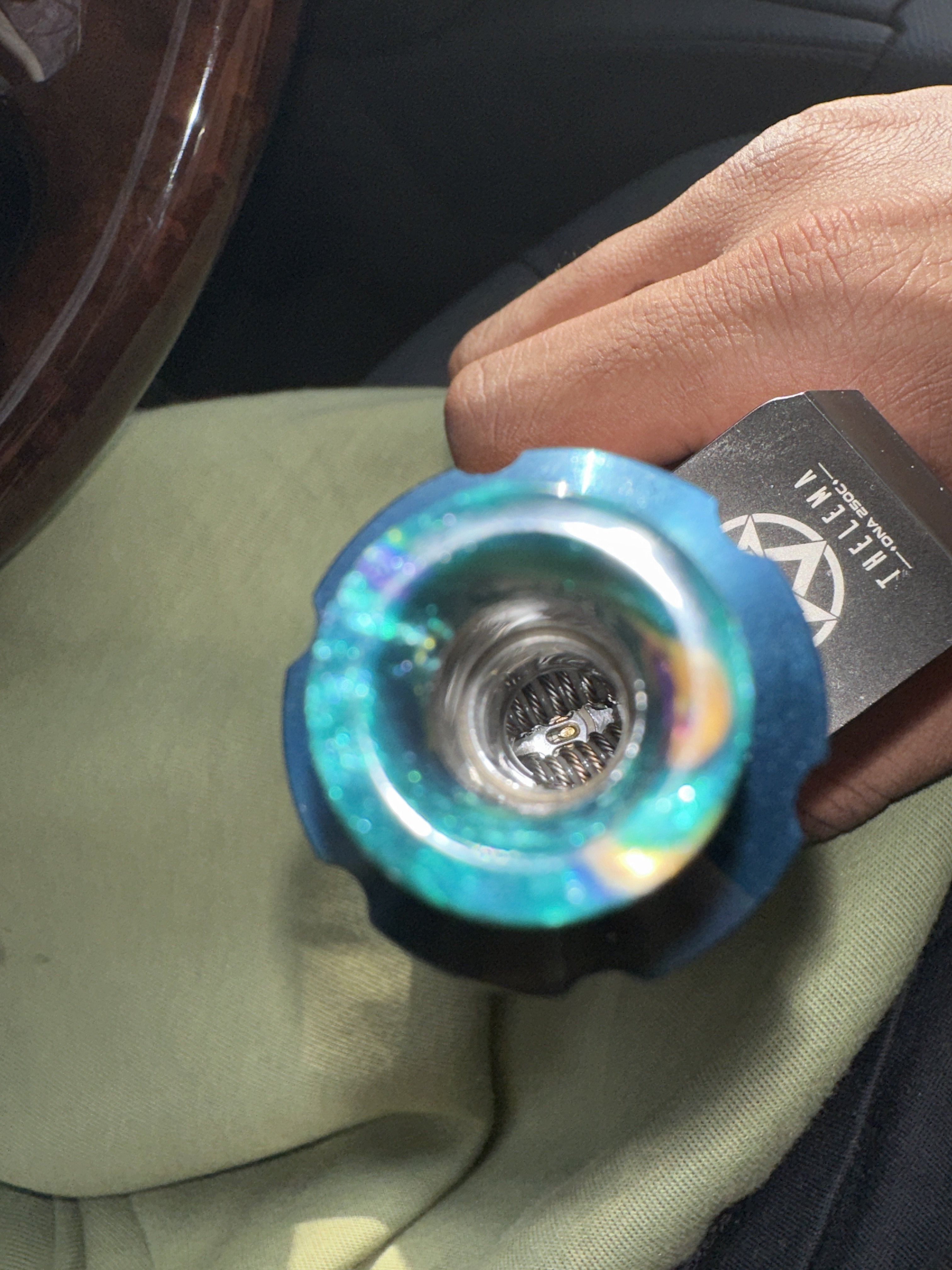

dwcraig1 Posted February 23, 2023 Report Posted February 23, 2023 Are you using two strands of 28 gauge SS316 twisted like mine, or just one strand?
Br114nAcc Posted February 23, 2023 Author Report Posted February 23, 2023 Just now, dwcraig1 said: Are you using two strands of 28 gauge SS316 twisted like mine, or just one strand? two strand twisted like yours
Br114nAcc Posted February 23, 2023 Author Report Posted February 23, 2023 Just now, Br114nAcc said: two strand twisted like yours here is a picture
