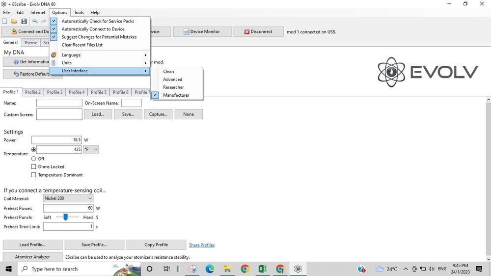

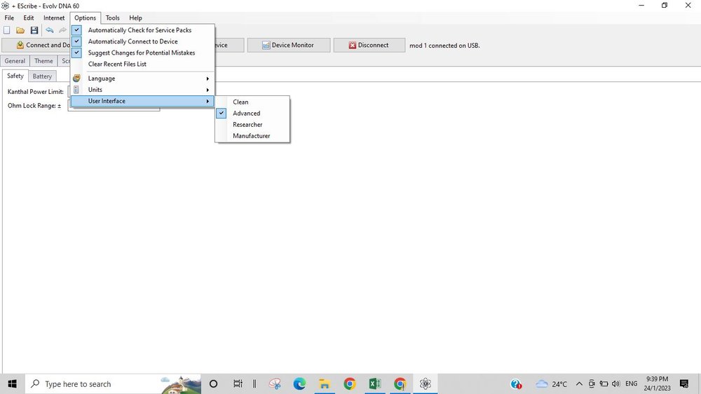

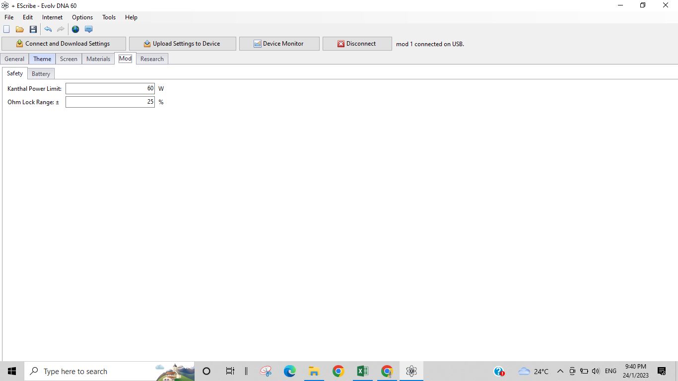

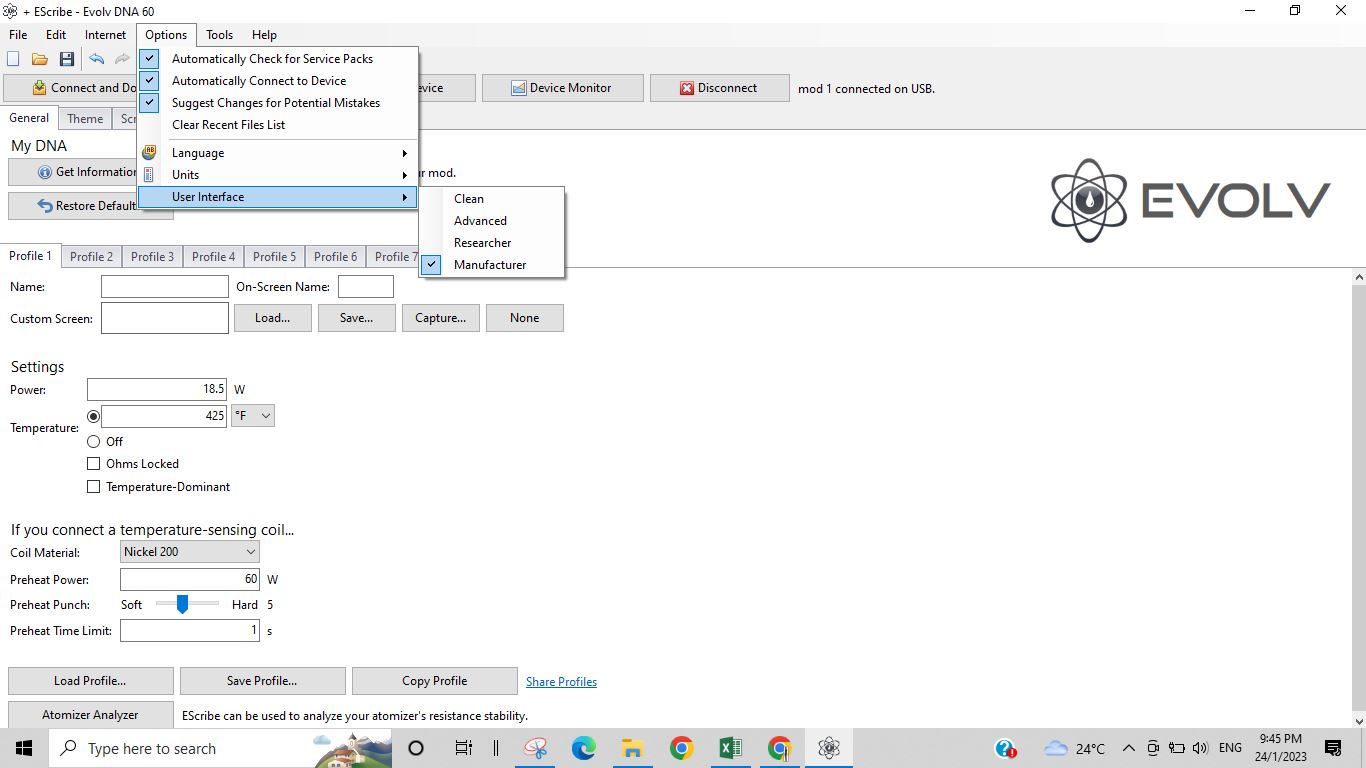

When I go to Advanced, there is no Electrical tab in Mod tab.
But, when I chose Option → User Interface  Manufacturer
i saw the Electrical tab that show Mod Resistance       0     Ω
Then, what should i do?
images attach below

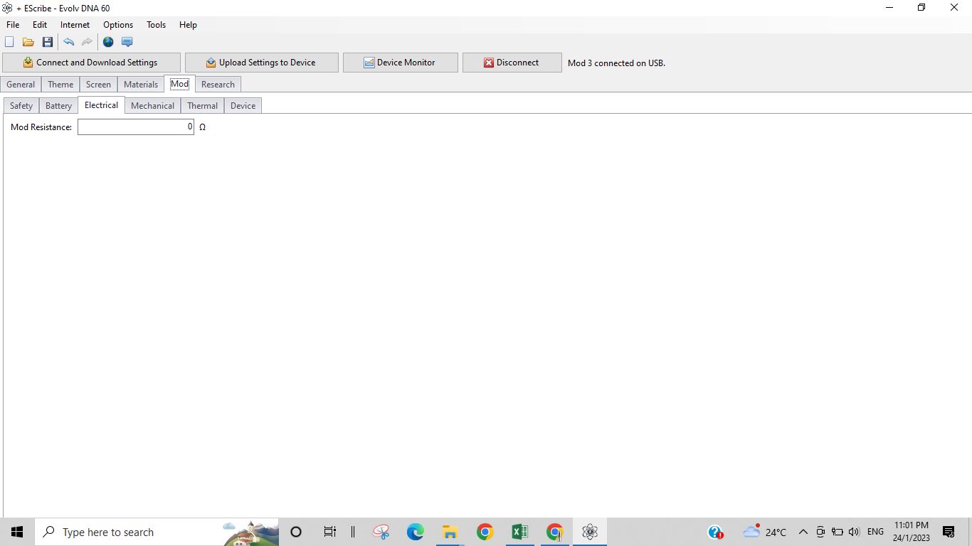

On this one the mod resistance is set to "zero", are all 5 mods set to zero?
all 5 mods show the 'Mod Resistance' zero "0Ω" on EScribe software when i connect the device.
That video explain well if your mod get HIGHER mod resistance, then u can add the offset.
In this case, our new mod with new DNA60, get LOWER resistance, and i can not simply put "negative" offset. Its doesn't work by put negative on EScribe software.

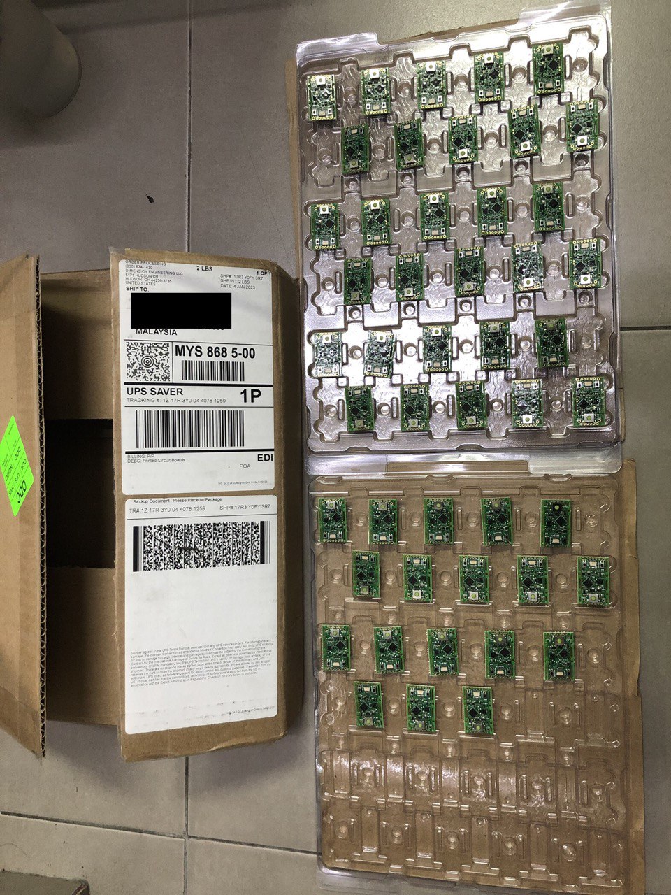

Regarding my previous order of 50units dna60, 2 of them was assembled as a mod (refer as mod 1 and mod 2), then I'm cannot do anything with that mod 1 and 2 @Wayneo? How about the balance 48units if the same situation happen? I believe this case must have a solution out there since I have no idea with that. I appreciate all of your help and cooperation. Thank you.

I'm inclined to think that the mods with the lower resistance is closer to correct. I can't remember a DNA60 reading less, only higher.
For sure zero is not the correct setting, usually 0.004 or higher.
To check the mod resistance use atomizer analizer with a shorting 510 plug with mod resistance set to zero. Screw the shorting plug into the mods 510 and put the resulting figure into the mod resistance (electrical tab) and upload to device.
I use a cartomizer that I soldered over it's 510 connection, it works great. This could be done also with a 510 to 510 adapter or an old atty with brass base/510.
