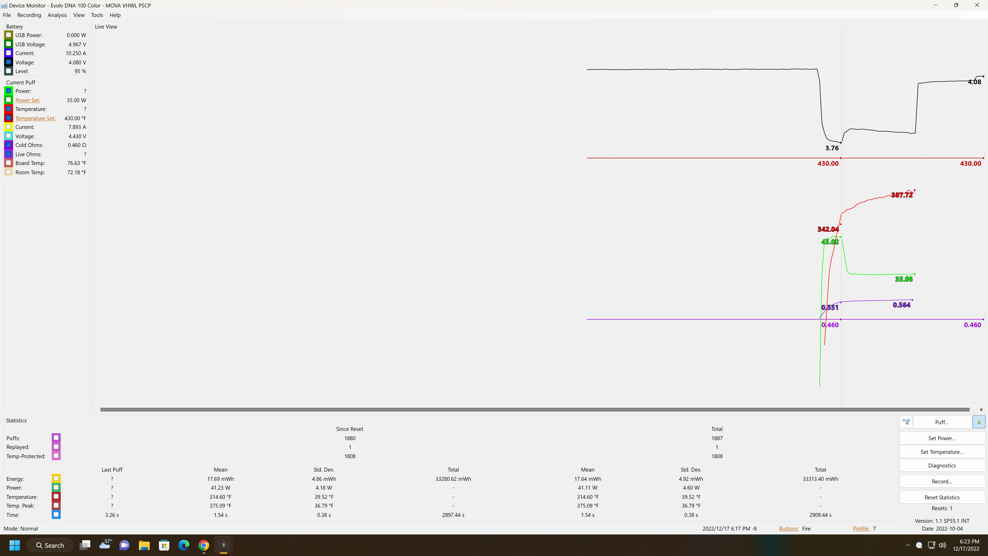

dwcraig1 Posted December 18, 2022 Report Share Posted December 18, 2022 Post a screen like this. Note the voltage drop while firing is 3.76 volts on mine. What does it drop to on yours while firing? Link to comment Share on other sites More sharing options...

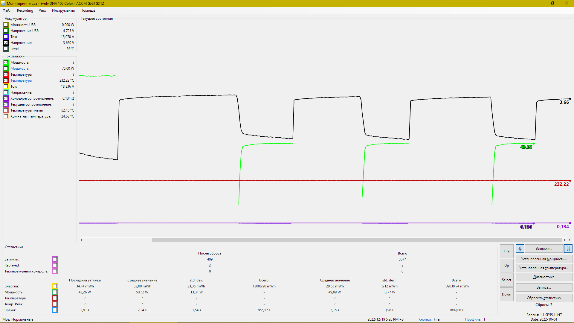

Defenix Posted December 19, 2022 Author Report Share Posted December 19, 2022 В 18.12.2022 в 05:25, dwcraig1 сказал: Post a screen like this. Note the voltage drop while firing is 3.76 volts on mine. What does it drop to on yours while firing? Link to comment Share on other sites More sharing options...

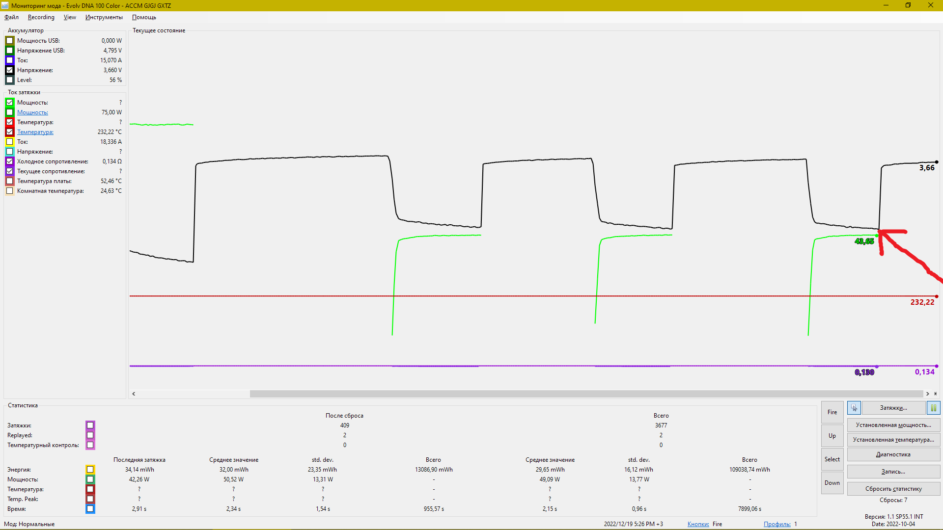

dwcraig1 Posted December 19, 2022 Report Share Posted December 19, 2022 Hover mouse curser over area indicated by red arrow and report back what the voltage reads. Also it appears that the standing voltage of your cell is 3.66 volts, with a 75 ohm load it very well is going to drop to below the 2.75 volt cutoff and do exactly what you are posting about, throttling down. Does charging the cell to full charge correct this problem? Link to comment Share on other sites More sharing options...

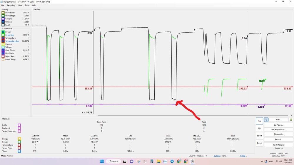

Astress23 Posted March 6 Report Share Posted March 6 Have same prob too, please help!!! Its still happen when i got a full charge for battery Link to comment Share on other sites More sharing options...
Wayneo Posted March 6 Report Share Posted March 6 RE-POSTING POST 2. On 12/17/2022 at 9:25 PM, dwcraig1 said: Post a screen like this. Note the voltage drop while firing is 3.76 volts on mine. What does it drop to on yours while firing? AND QUOTING POST #5 On 12/19/2022 at 10:13 AM, dwcraig1 said: Hover mouse curser over area indicated by red arrow and report back what the voltage reads. 1 Link to comment Share on other sites More sharing options...
Astress23 Posted March 7 Report Share Posted March 7 (edited) At the beginning I can use normally, the power still reach 75w but after 2 or 3 puffs, its drop down to 30-40w. Please Help 🆘 Edited March 7 by Astress23 1 Link to comment Share on other sites More sharing options...
dwcraig1 Posted March 7 Report Share Posted March 7 Again I will ask, what is the voltage showing at red arrow? Hoover your mouse curser over the area and it will show the value. Maybe this will help, if you feel that your battery provides enough amps most likely the battery isn't being held tight enough by the battery door. It is most likely that or battery isn't powerful enough. What battery are you using? 2 Link to comment Share on other sites More sharing options...
dwcraig1 Posted March 7 Report Share Posted March 7 If I were a betting man I'd say that it is 2.75 volts. The board is throttling down just as it should. Am I right? 2 Link to comment Share on other sites More sharing options...
