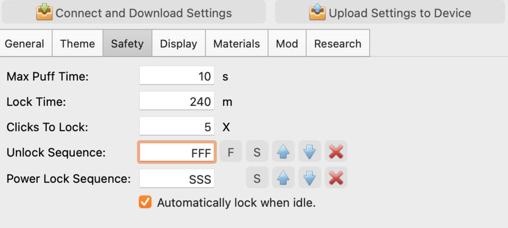

Wayneo Posted November 26, 2022 Report Posted November 26, 2022 My bad, man. I have led you astray. Normally a new feature would have been identified with the corresponding SP release. The unlock sequence is shown here in escribe And you've already seen this information/warning @James Can you please explain how to use the new 'Special Usage' screen 'Power Lock' and the relevant Theme Designer fields 1
JoshyWay Posted November 29, 2022 Author Report Posted November 29, 2022 It's all good man. Thanks for looking into it for me. And to answer your questions. Yes I have set that up in escribe even changed the lock sequence from select, select, select to up, down, select, to up, up, up, and so on. The unlock sequence does work on my power lock screen. Yes I have also seen that screen. The device the theme is going on is a DNA100C. So here's what I did thinking it would work. I made my power lock toggle on a screen with my other lock settings like auto lock and clicks to lock etc. I even added a condition to the power lock toggle of hidden if the device is not power lock capable. Then I made my power lock screen with a status at the bottom to enter the power lock sequence but did not place anything else on this screen. When I use the power lock toggle, click the toggle to turn power lock on, the toggle changes to the on check and stays on this screen. If I hit the power button the device will fire which I have this screen able to be fired on. If I try to hit any of the up, select, down buttons it then takes me to my power lock screen that I have set up where I must enter the select, select, select sequence to unlock. If I don't enter the sequence and instead hit the fire button it takes me back to the screen that I have the power lock toggle set up on and fires the device, but I cannot move from the power lock toggle with any of the buttons. So if I hit fire it fires from the toggle screen. If I hit any one of the up, select, down buttons it goes to power lock screen to enter the sequence. Then if I enter the sequence it unlocks everything and the device goes back to normal. So I think that I have it set up properly, THINK. Is this how the power lock is supposed to function on a theme? I thought it would just lock the power until you unlocked it. I didn't think it would just keep you on the toggle screen and just let you fire the device and that's it until you enter the unlock sequence. So what is the purpose of this new power lock?
