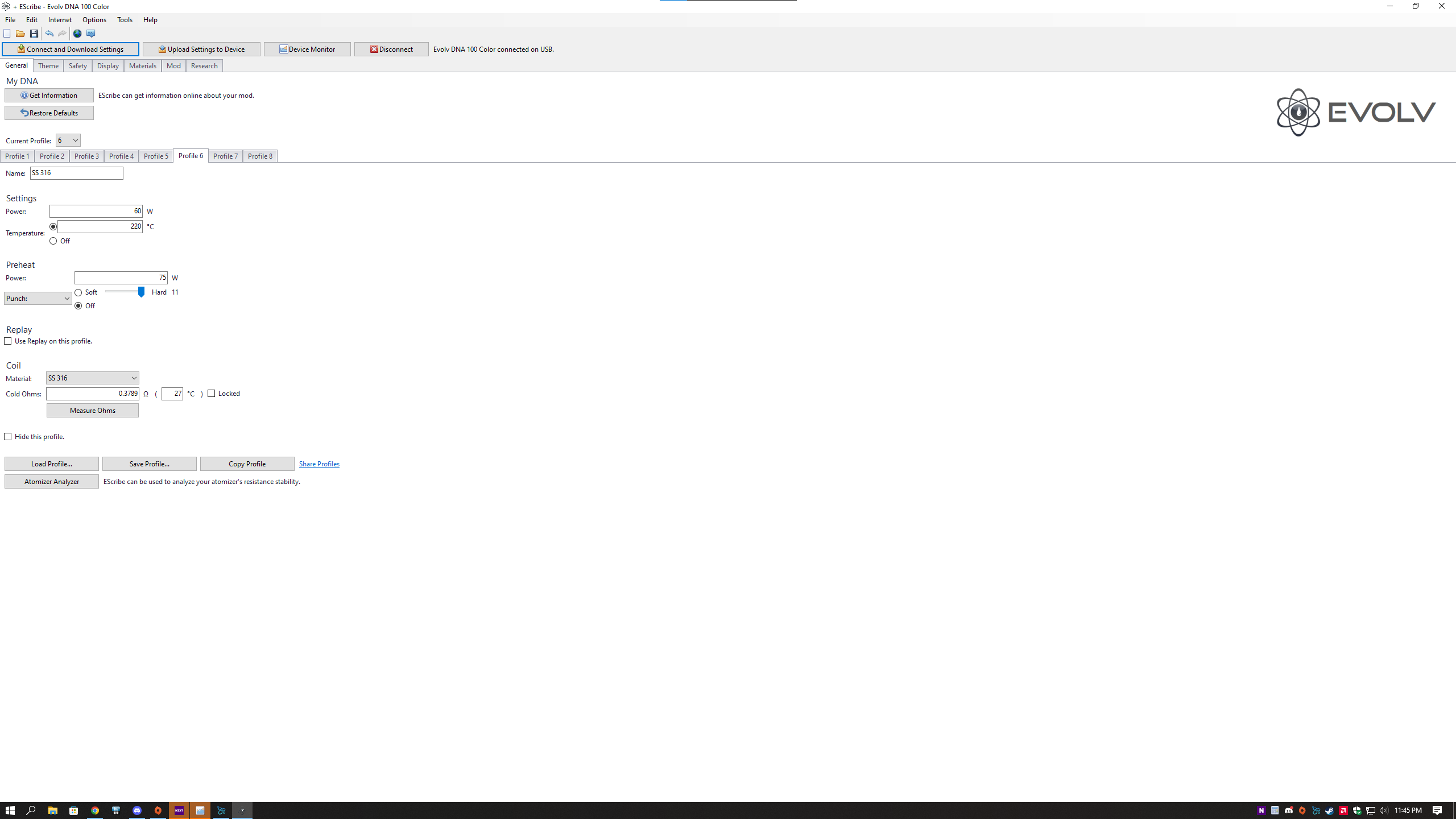

Azax Posted June 24, 2022 Report Posted June 24, 2022 Hello. i m vaping on a thelema dna 100c with evl reaper v3 0.3mm id, 5 wraps, .303 resistance,SS316 26awg. i am looking for help cause in the manual it's not settings, no instruction, nothing really besides buttons and battery safety. regarding TC 316 : i let the coil cool down at temp room, then resample it and leave it unlocked(if i lock it, set temp to 260C but won't reach more than 155C so i leave it unlocked). set wattage mode to 90W and temp mode to 260 ( this is the only reasonable settings i got but still i get 30% of flavour than a Gen S TC SS mode) disabled preheat (75W default and punch 5 default), i do not understand a bit of it. i cannot find any settings someone is vaping in TC ss mode besides (wattage from 15-100W and temp from 195-410C<which i consider unsafe) + preheat power or preheat temp simultaneously. 1. is preheat stacking with TC ss316 wattage mode+temperature ? 2. should i enable preheat power/temperature? what are the settings for temp control+preheat pwr or temp control+preheat temp? Thanks.
Wayneo Posted June 24, 2022 Report Posted June 24, 2022 This sounds like it's your first DNA device. Here's a great video tutorial on the board and Theme Designer. The video lingo, or escribe will get you familiar with DNA words DJLSB vapes - Evolv DNA 75 C Full Review with eScribe and Theme Editor Tutorial - https://youtu.be/1dvBpTm-FQM And here's the datasheet for the 75C with more explanations. https://downloads.evolvapor.com/dna75color.pdf Can you post 2 screenshots for me. The first being a Device Monitor while firing with the 'Power', 'Power Set', 'Cold Ohm' and 'Live Ohm' checkboxes enabled. The second being the Profile you're using. When you start escribe THAT profile # is shown as 'Current Profile'. When not using TC, so straight watts, how many watts are you using for an enjoyable vape?

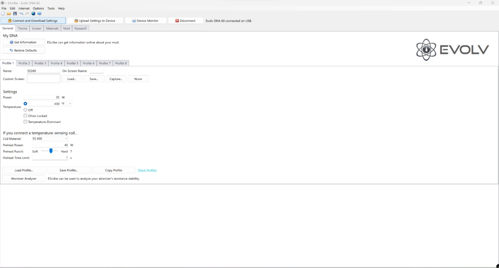

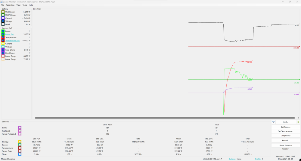

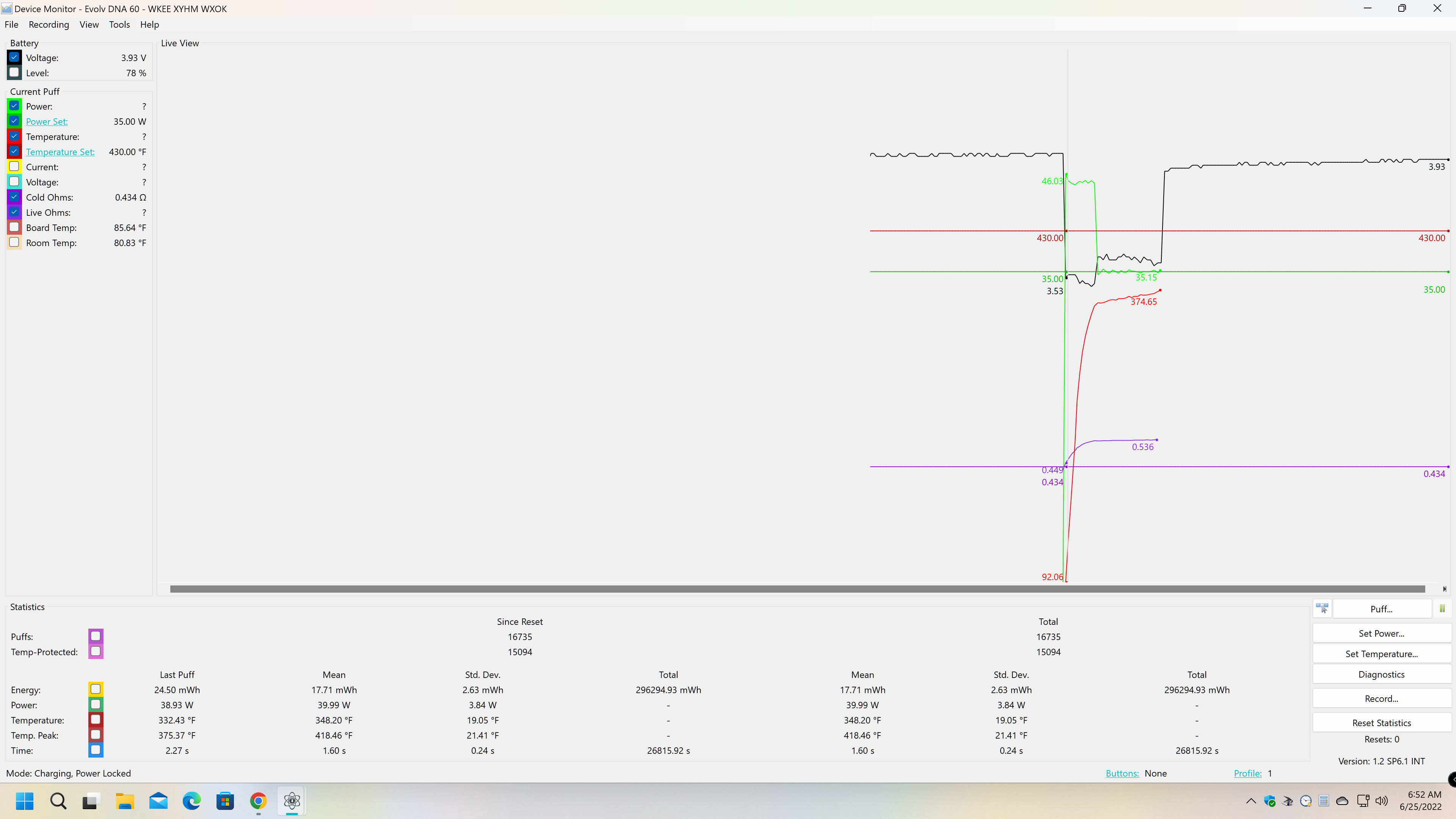

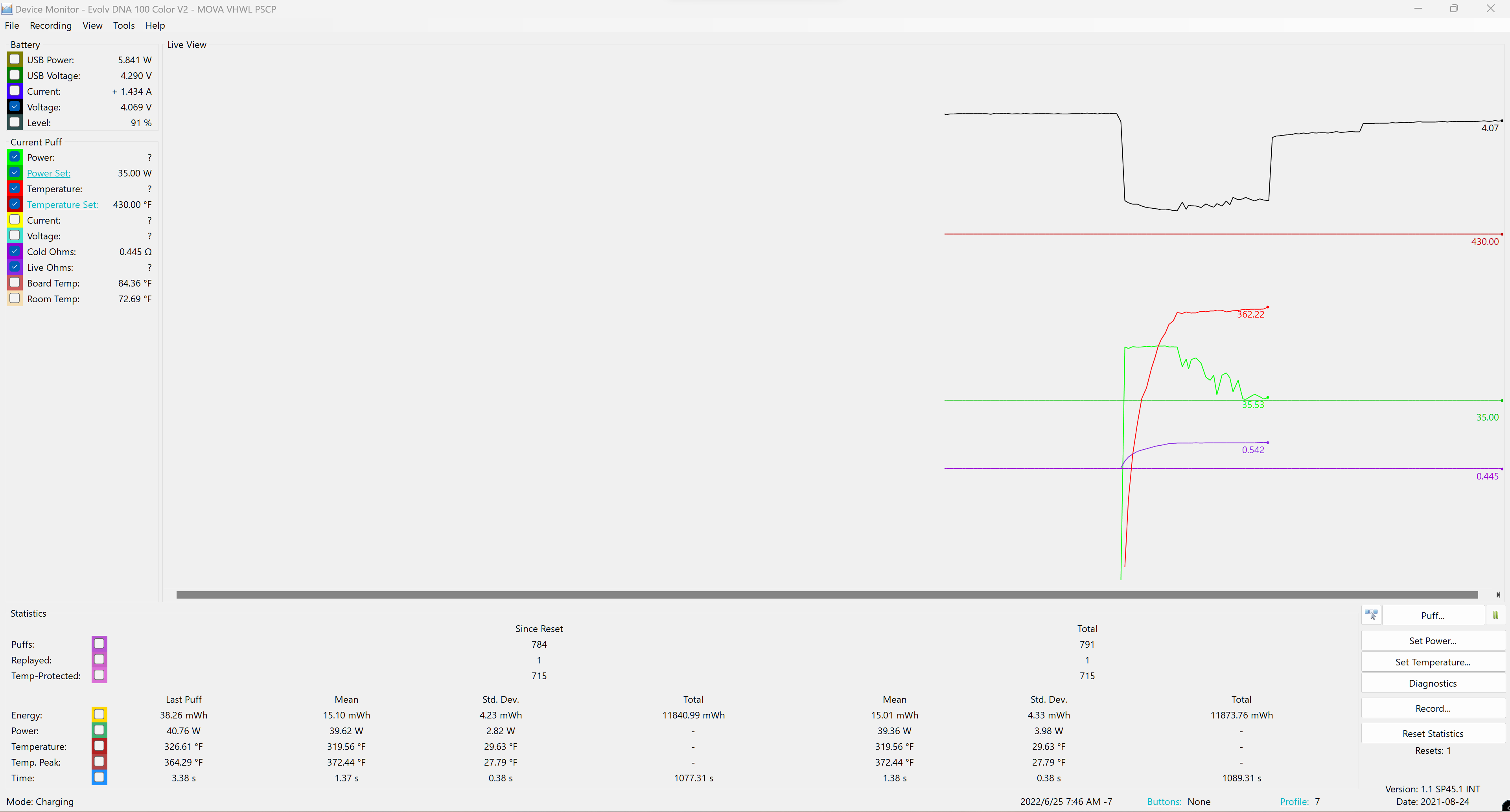

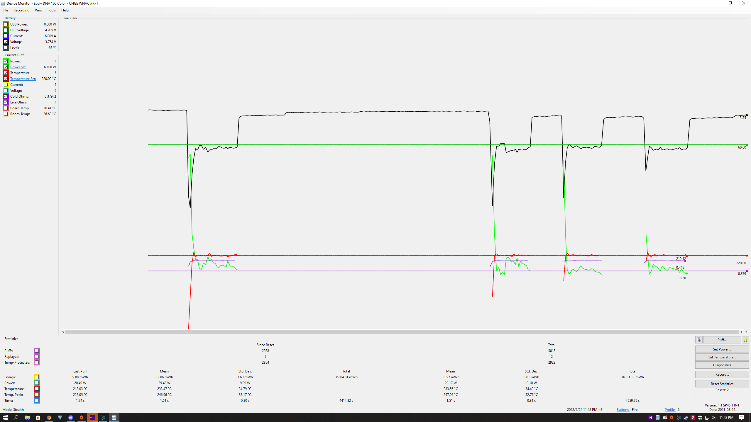

Azax Posted June 24, 2022 Author Report Posted June 24, 2022 (edited) "Can you post 2 screenshots for me. The first being a Device Monitor while firing with the 'Power', 'Power Set', 'Cold Ohm' and 'Live Ohm' checkboxes enabled. The second being the Profile you're using. When you start escribe THAT profile # is shown as 'Current Profile'." yes, it is first dna device. cold ohm you mean first vape after letting it cool down and live ohm, the next vapes after cold? "When not using TC, so straight watts, how many watts are you using for an enjoyable vape?" usually around 18-24W. Edited June 24, 2022 by Azax
Wayneo Posted June 24, 2022 Report Posted June 24, 2022 Perfect, and thank you. Well, you're certainly reaching that 220°C that you've set. Notice that solid horizontal red line, and that other red one that extends up to it (all 4 puffs). I believe you when you said 18-24W, because the final puff shows it was at 18.20W (value on the last puff, just below the squiggly green line) So I don't understand why you would set it at 60W. That is causing you to BLAST to that specific temp, and in case TC fails for some reason, you're in for a world of hurt. Depending on your juice, does it taste all right? You can easily blast through some flavors completely. IMHO you could easily drop the power to 30 watts and still reach that temp. Especially on an MTL setup, with straight wire, you shouldn't have a need for Preheat.

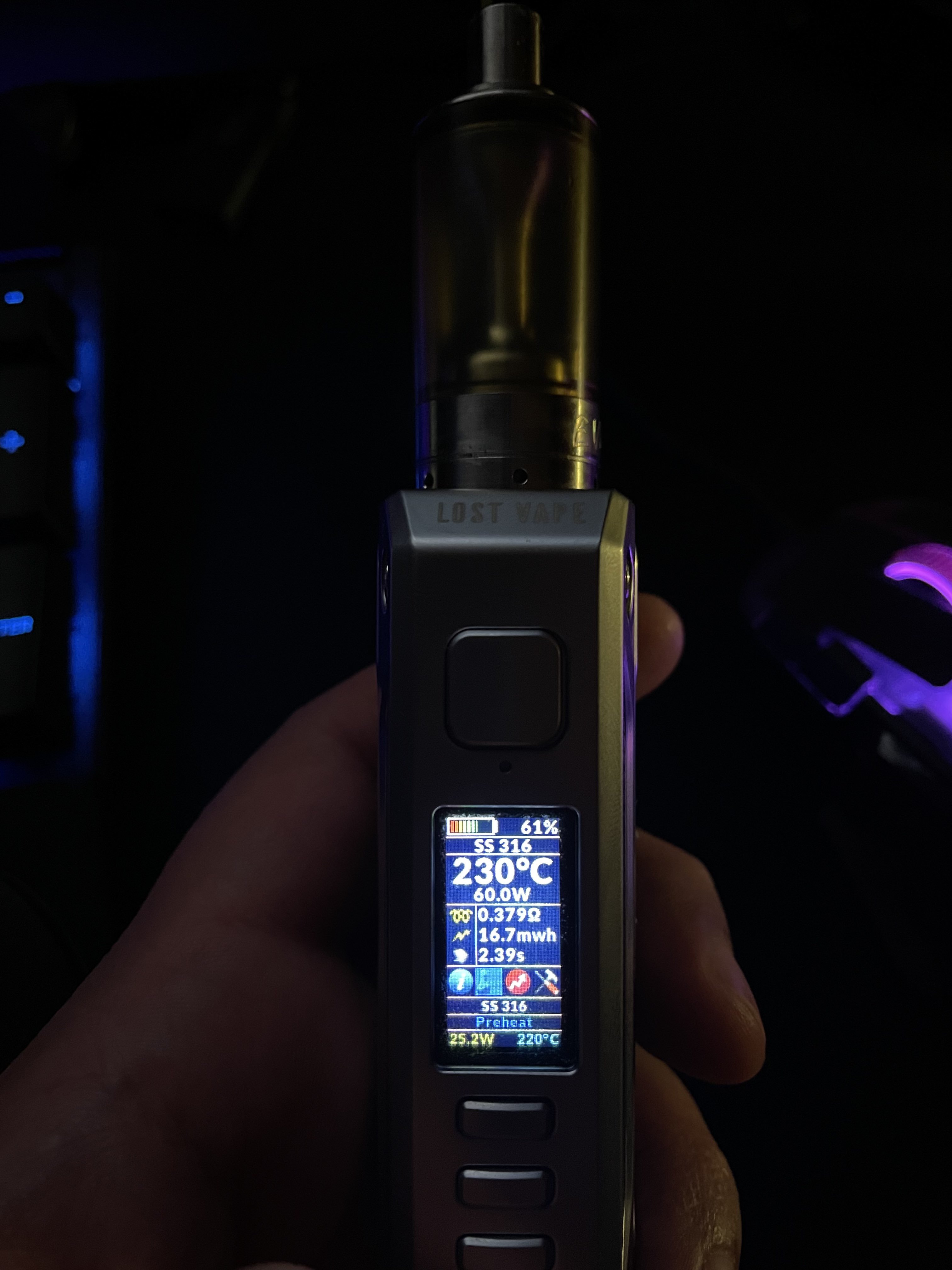

Wayneo Posted June 24, 2022 Report Posted June 24, 2022 Buddy I still don't understand, and there are so many different themes ......, escribe shows the facts. Your theme should correspond to escribe values. You might need to re-read what I've written. What I can tell you is (using your Device Monitor print), your mod never even hit the 60 watts you set before starting that power spiral of death. 11 minutes ago, Azax said: i saw 220C was safe to not get gunk/little black dots on muji cotton, usually i'd prefer it at 260C but i think it's not safe for SS at that temp. People post a lot of craziness. Both IMHO are dubious claims at best. Did you try turning the watts down to 30?
Azax Posted June 24, 2022 Author Report Posted June 24, 2022 (edited) 19 minutes ago, Wayneo said: Buddy I still don't understand, and there are so many different themes ......, escribe shows the facts. Your theme should correspond to escribe values. You might need to re-read what I've written. What I can tell you is (using your Device Monitor print), your mod never even hit the 60 watts you set before starting that power spiral of death. People post a lot of craziness. Both IMHO are dubious claims at best. Did you try turning the watts down to 30? let's say i have SS 316 profile with 220 C and under temp i have wattage which is set to 60W, then in this profile i have a preheat option, it's not a profile, it as an option > so if i enable preheat, does influence the profile? or ignores the profile with temp + wattage and just preheats. alright, i ll go 260C again. yes i did, and felt it was taking longer to heat. maybe just my imagination. also, i saw my battery sometimes ranges from 5-15mwh, what's the optimal discharge? Edited June 24, 2022 by Azax

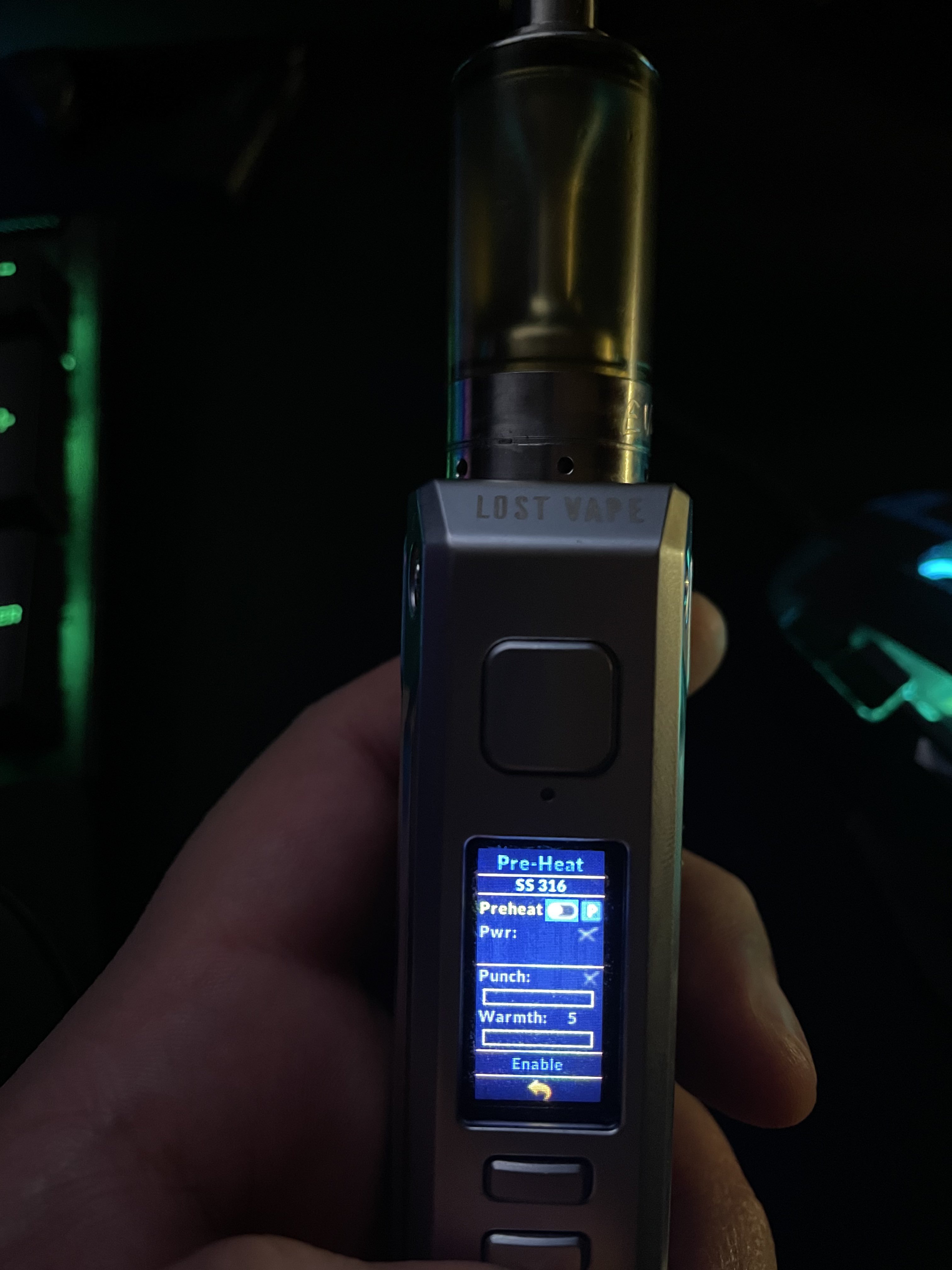

Wayneo Posted June 24, 2022 Report Posted June 24, 2022 7 minutes ago, Azax said: then in this profile i have a preheat option, it's not a profile, it as an option > so if i enable preheat, does influence the profile? Absolutely, but yours was disabled. 39 minutes ago, Wayneo said: I don't think you need preheat at all. But if you do, the 'preheat power' (75W in your case BUT disabled) should be > 'power set' (60W in your case). And it's much easier to use the slider (1-11) compared to temp unless you know the temps that your specific juice components aerosolize at. That slider says how close your coil gets to that 'Temperature set' value (220°C in your case) before ending preheat 9 minutes ago, Azax said: yes i did, and felt it was taking longer to heat. maybe just my imagination. Great so with watts at 30, turn preheat on at 40w, punch 5. Still want quicker, try 7 or until it's quick enough for you. 14 minutes ago, Azax said: also, i saw my battery sometimes ranges from 5-15mwh, what's the optimal discharge? 18.47mWh ................. You're joking right.
Azax Posted June 24, 2022 Author Report Posted June 24, 2022 14 minutes ago, Wayneo said: Absolutely, but yours was disabled. Great so with watts at 30, turn preheat on at 40w, punch 5. Still want quicker, try 7 or until it's quick enough for you. 18.47mWh ................. You're joking right. oh, thanks a lot for the preheat advice. and for the battery, i mean when i puff, should i stay in a range of 5-7mwh? press less the fire button, or anything like that? i see people praising the dna for keeping their 21700 going for days.. my 21700 goes at best 12-16hours, and 18650 x2 per day.

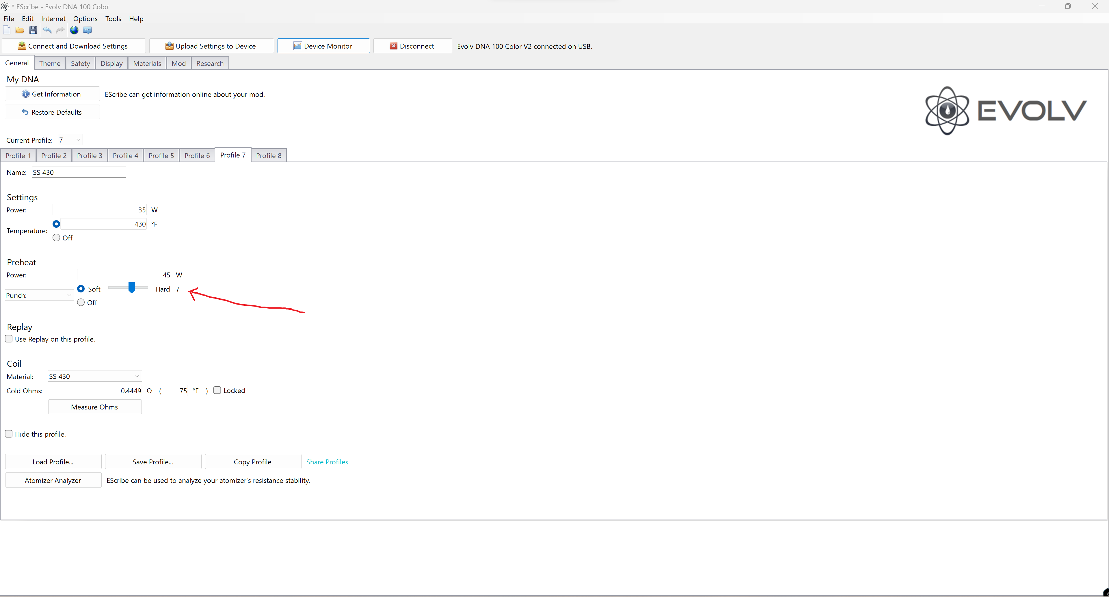

dwcraig1 Posted June 25, 2022 Report Posted June 25, 2022 This is with a DNA60. I start with building a coil for the desired wattage. Here it's 40 watt range. My only real concern is the overhead dry hit protection. Mine vapes exactly like a non temperature control device (wattage), that is till something unexpected happens like I run it out of juice. If it hits my temp setting and throttles down I'm not at all happy with it. To each their own I guess but this is how I've been doing it for a number of years. The coil here is 28 gauge SS430, two strands twisted together prior to coiling.
Azax Posted June 25, 2022 Author Report Posted June 25, 2022 35 minutes ago, dwcraig1 said: This is with a DNA60. I start with building a coil for the desired wattage. Here it's 40 watt range. My only real concern is the overhead dry hit protection. Mine vapes exactly like a non temperature control device (wattage), that is till something unexpected happens like I run it out of juice. If it hits my temp setting and throttles down I'm not at all happy with it. To each their own I guess but this is how I've been doing it for a number of years. The coil here is 28 gauge SS430, two strands twisted together prior to coiling. thank you. may i ask how do you get that preheat time limit?
dwcraig1 Posted June 25, 2022 Report Posted June 25, 2022 EScribe settings are a bit different on the non color boards. It's just part of Escribe I'd say.
dwcraig1 Posted June 25, 2022 Report Posted June 25, 2022 Here's my 100c, same coil configuration, same juice.

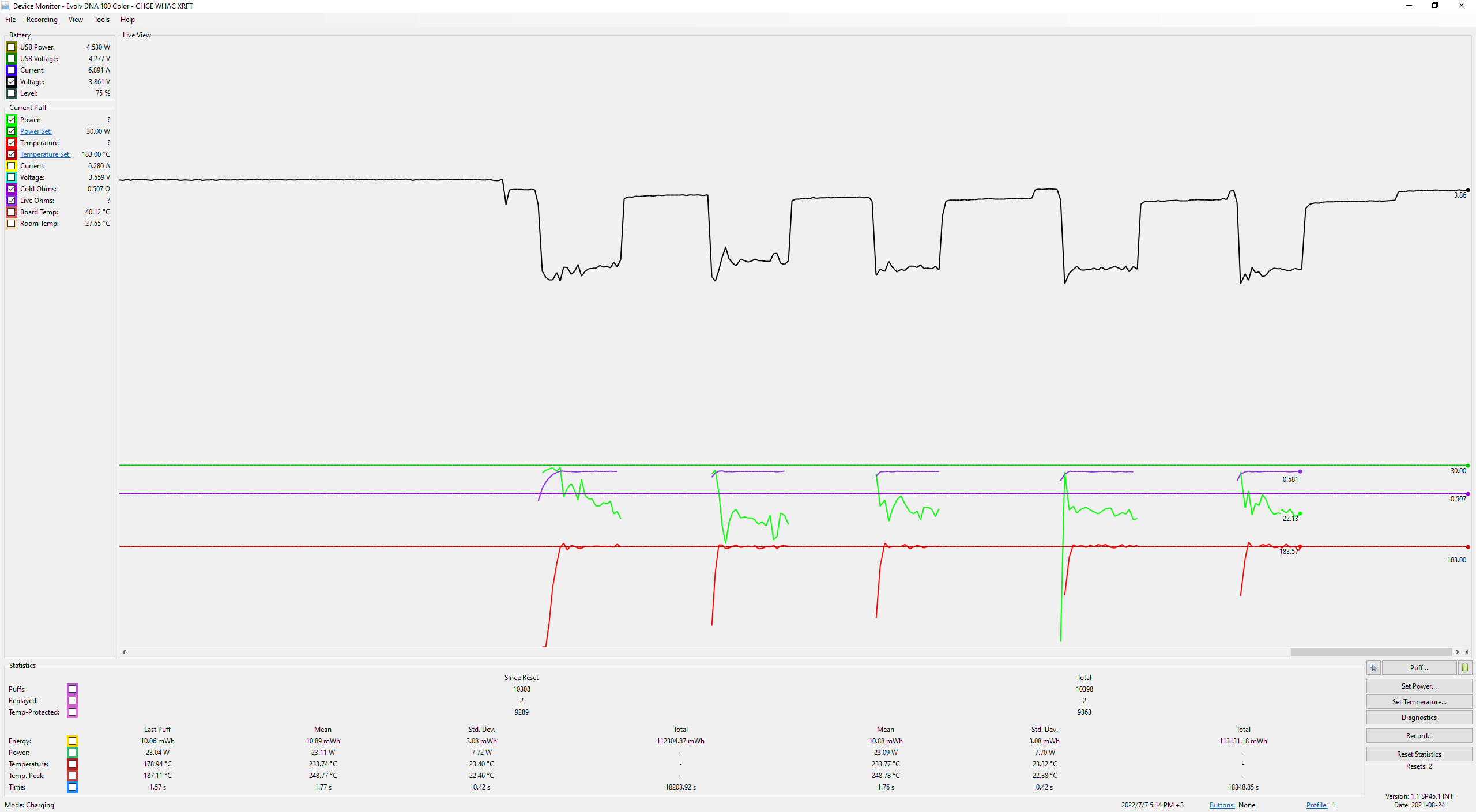

Azax Posted June 27, 2022 Author Report Posted June 27, 2022 guys, i ve encountered a problem. i ve reseted the device, installed the theme once more and i ve started vaping and found out that it's weird.. then went to device monitor, and i have the same settings as the old profile, my watts won't go beyond 13-15W.. what did i do? or what i did before?

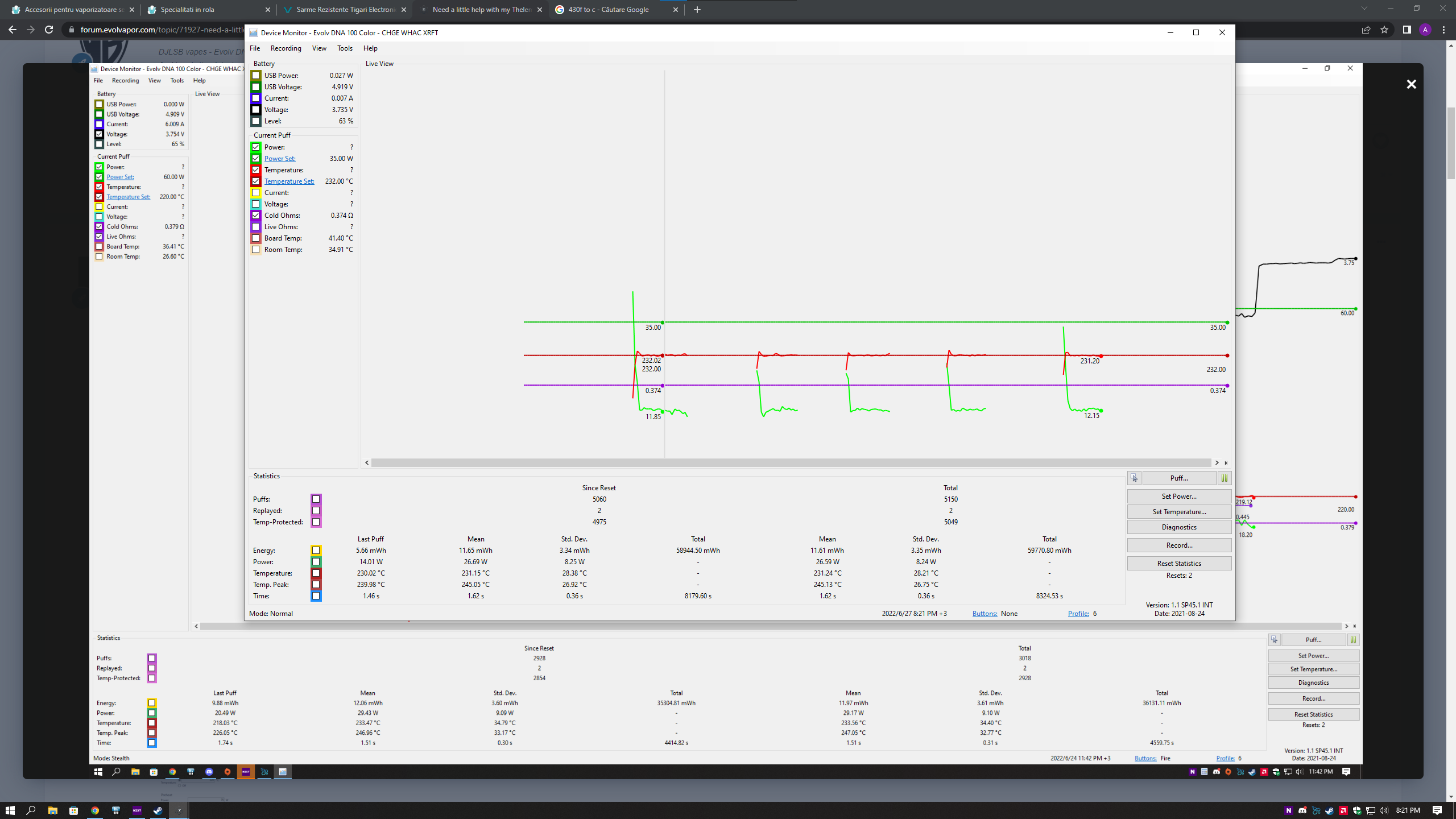

dwcraig1 Posted June 28, 2022 Report Posted June 28, 2022 The first puff shows preheat more than 35 watts. It is hitting temp setting and throttling down. Start out by figuring what wattage that your build can handle, do that in wattage mode with TC off. Start low and go by taste. Then once you get that figured go back to TC, first with no preheat and then add some as needed. Your build and wicking as well as juice thickness and air flow will all effect how many watts it can handle. Note: Make sure that your cold coil settings is in fact made with a cold coil (room temp) otherwise the hot coil temp will not be close to accurate.
Azax Posted June 28, 2022 Author Report Posted June 28, 2022 i had the same coil as before, and that was the last coil to check, now i m on wattage and clapton atm till my ss 316 arrives. i did nothing besides restarting the device to default and installing the theme again, had the same coil, same settings but somehow the Watts were not going 24W like before, was dropping to 12-15.. i ll keep you posted after the new wire arrives. Thank you for your time.
