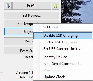

Steve.W Posted October 11, 2021 Report Posted October 11, 2021 Hi I am new to dna mods, so sorry for the noob questions. I would like to disable the usb charging on my Odin's but cannot find where to do it in either e scribe or the mod itself. Can anyone offer advice please?
Steve.W Posted October 11, 2021 Author Report Posted October 11, 2021 Thank you Bill much appreciated. 1
Wayneo Posted October 11, 2021 Report Posted October 11, 2021 What @BillW50 showed, does not survive a battery swap. 1
CMK Posted October 11, 2021 Report Posted October 11, 2021 vor 31 Minuten schrieb Wayneo: What @BillW50 showed, does not survive a battery swap. 😭

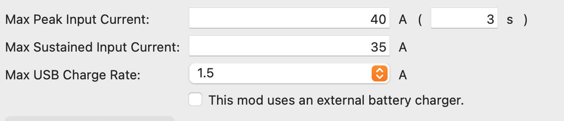

Wayneo Posted October 12, 2021 Report Posted October 12, 2021 The only boards that you can actually shut it off completely would be the 75, 75C and the 100C in the battery details, by enabling that '....... uses an external charger' 1
