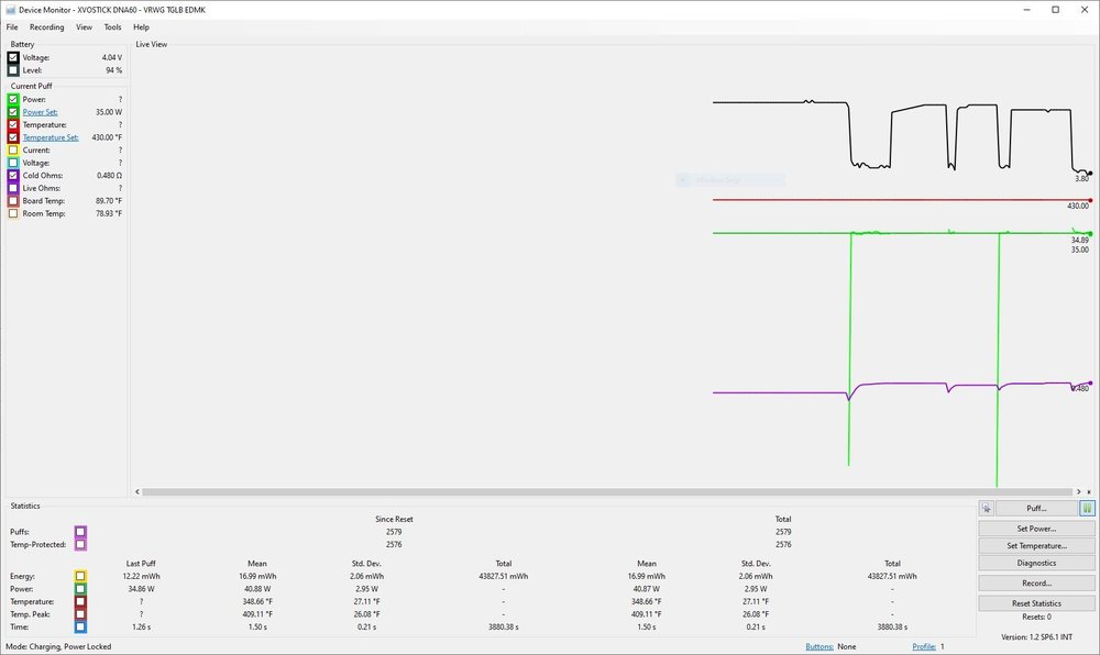

I was getting a weak battery indication, so I hooked it up to the computer and was seeing voltage drop some where around 0.6-1v (didn't get a screen shot).
So I started cleaning all of the contact points: Battery cover threads and contacts, positive contact, Ground contact, 510 pin, 510 ground contact, the screws and their holes, that connect the two half's of the mod. Best I can get is a .46 voltage drop.
I'm use to seeing a 0.2 voltage drop on my Dani 25, with the same atomizers and builds. So started investigating and tinkering. I went as far as to loosen up the two half's of the XvoStickPro, so I could use one of my Samsung INR21700-40Ts, that I run in my Dani 25. It showed similar voltage drop to the Vapecell INR26650 G53, with in a couple hundredths of a volt...
 Is a 0.5 voltage drop, the best that I'm going to get or should I be expecting to see closer to something closer to the 0.2 voltage drop, that I get on my Dani 25 or am I comparing apples to oranges?..
Best I've I can get, after cleaning all contacts and threads on my XvoStickPro running a Vapcell INR26650 G53:
Originally it came with a DNA 40, back in 2018 I converted it to a DNA 60 for SSTC.

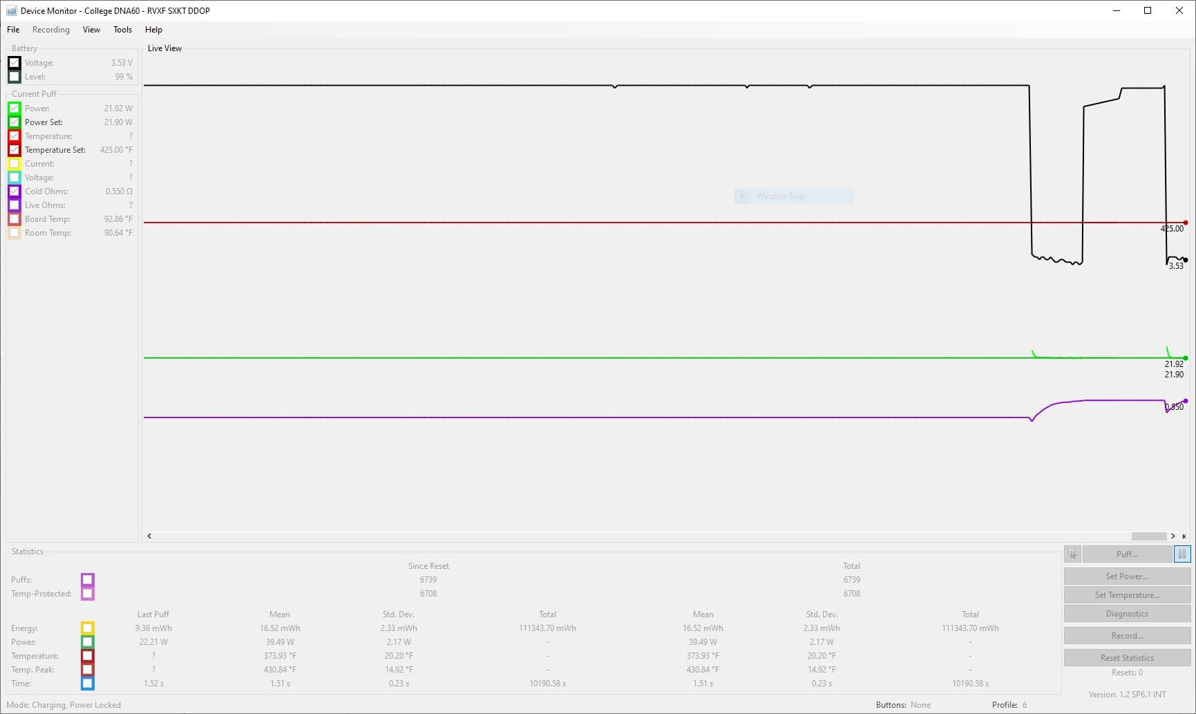

The battery was fully charged, firing at 22 watts on a 1.6 ohm coil. I was getting about 0.8-1.0 of voltage drop, before cleaning the contact points.
After cleaning:
Imgur link, incase the uploaded photo breaks: https://i.imgur.com/5VQ9Udf.png
When I re did the mod with the DNA 60 Board, I used all new wire following the specs in the evolve DNA 60 data sheet. The wire used, was the Ölflex Silicone wire sold by modmaker.
1 hour ago, dwcraig1 said:

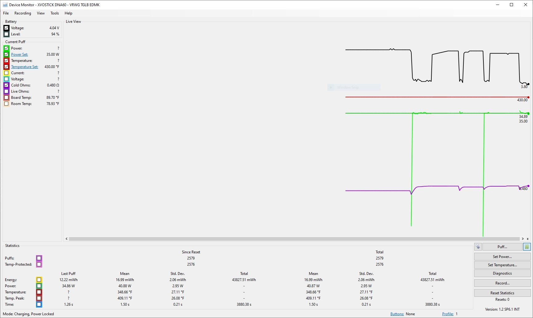

Here is my XvoStick with Samsung 20S firing at 35 watts.
That's about half of what I'm getting. What type of wire are you running for your coil. I'm using 3mm, 8 wrap, 28awg Kanthal A1 coil at 1.6 ohms. I've tried the same coil in both my Kayfun Prime and my Cthulhu 1928.
Also, is your DNA 60, one of the new ones or did you convert one of the older DNA 40 models to a DNA 60?

You are getting a weak battery with a fully charged battery? Ouch! I thought the battery was something less than 40% charged before you get a weak battery message.
dwcraig1 has the same XvoStick DNA60 that I have. It is the newer one piece one that comes with a DNA60.

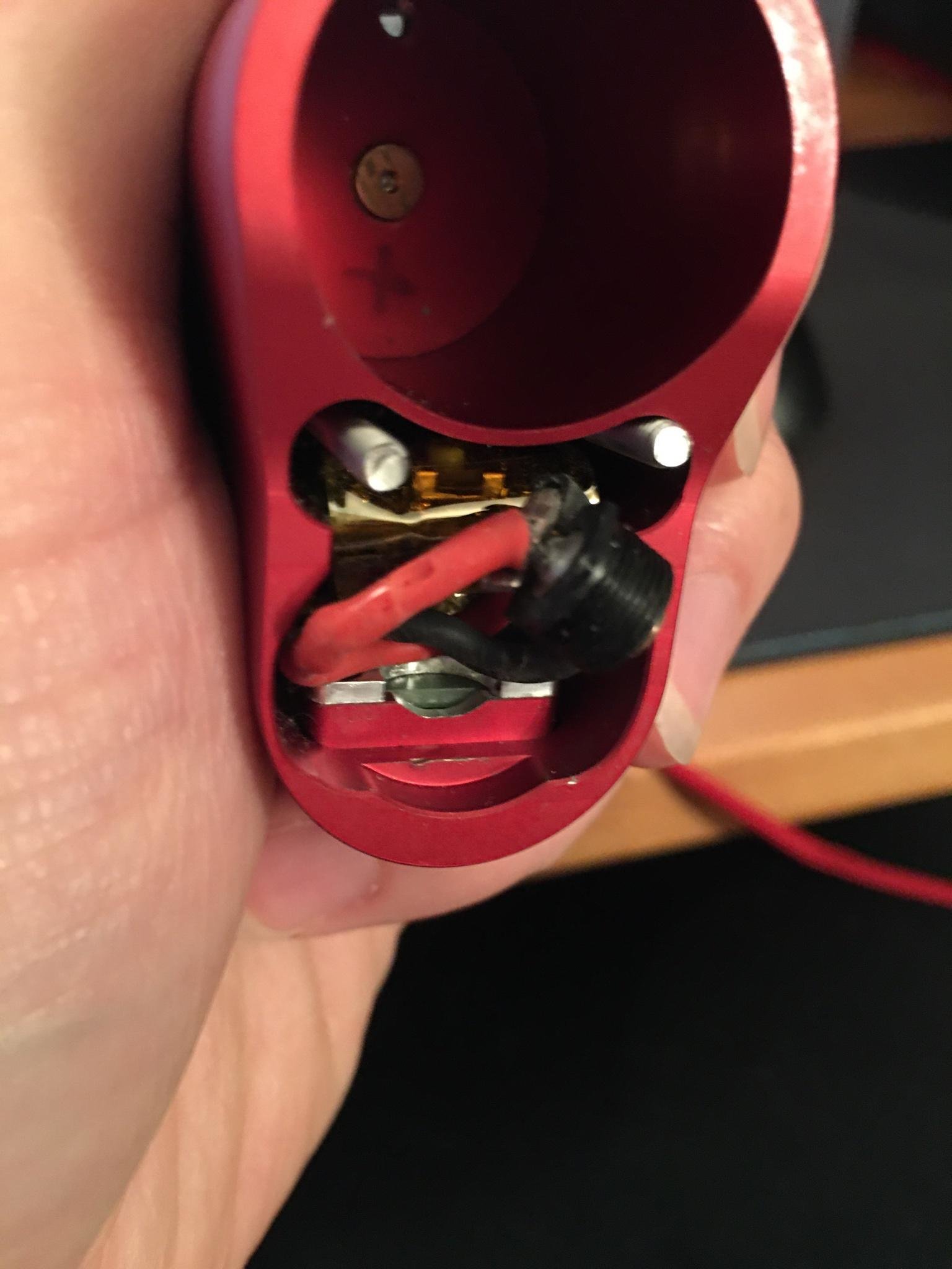

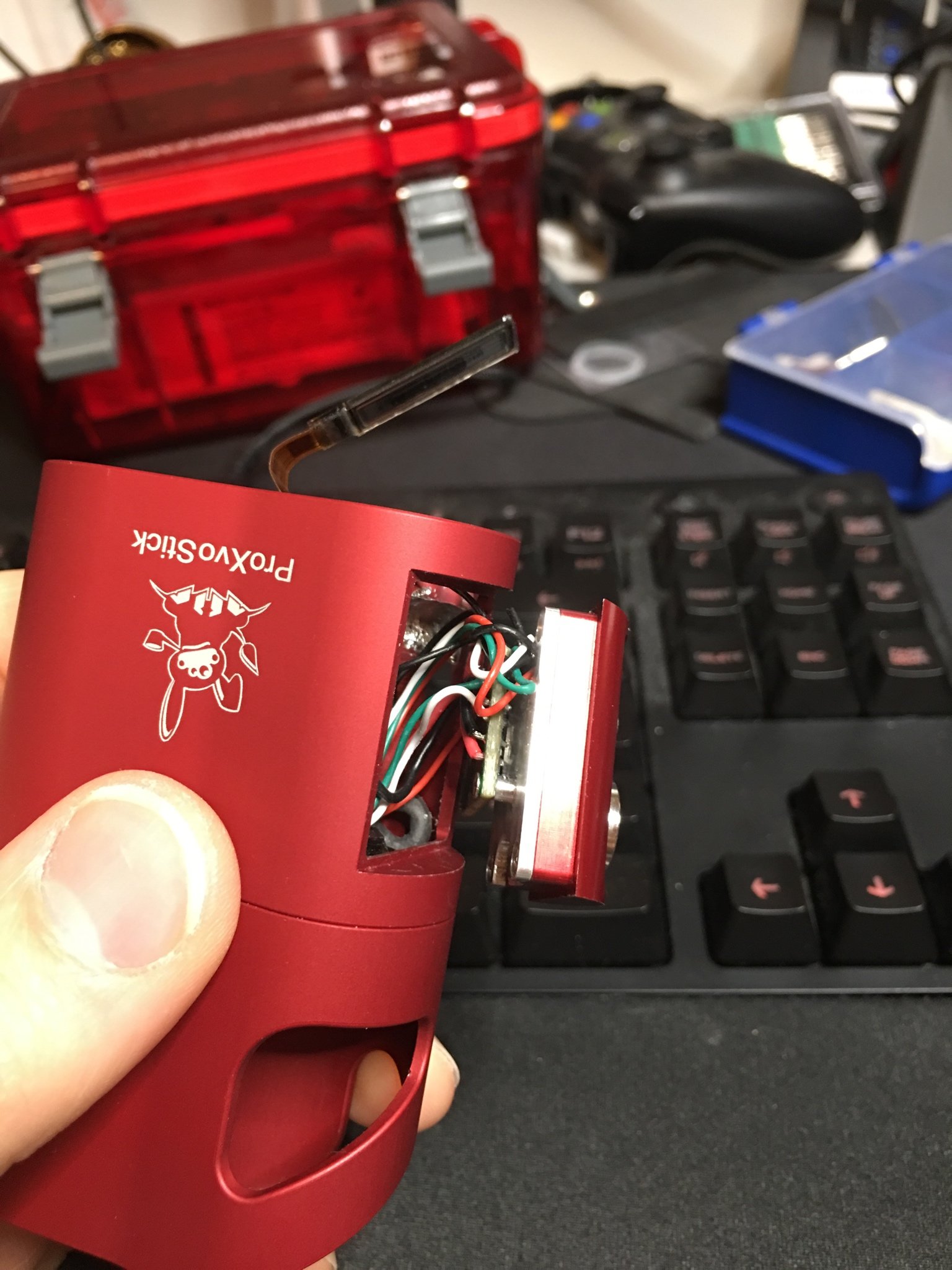

Well I think I found the problem. The positive wires on the 510 appear to be breaking. Think this one is going to get shelved, until I get my soldering gear back.

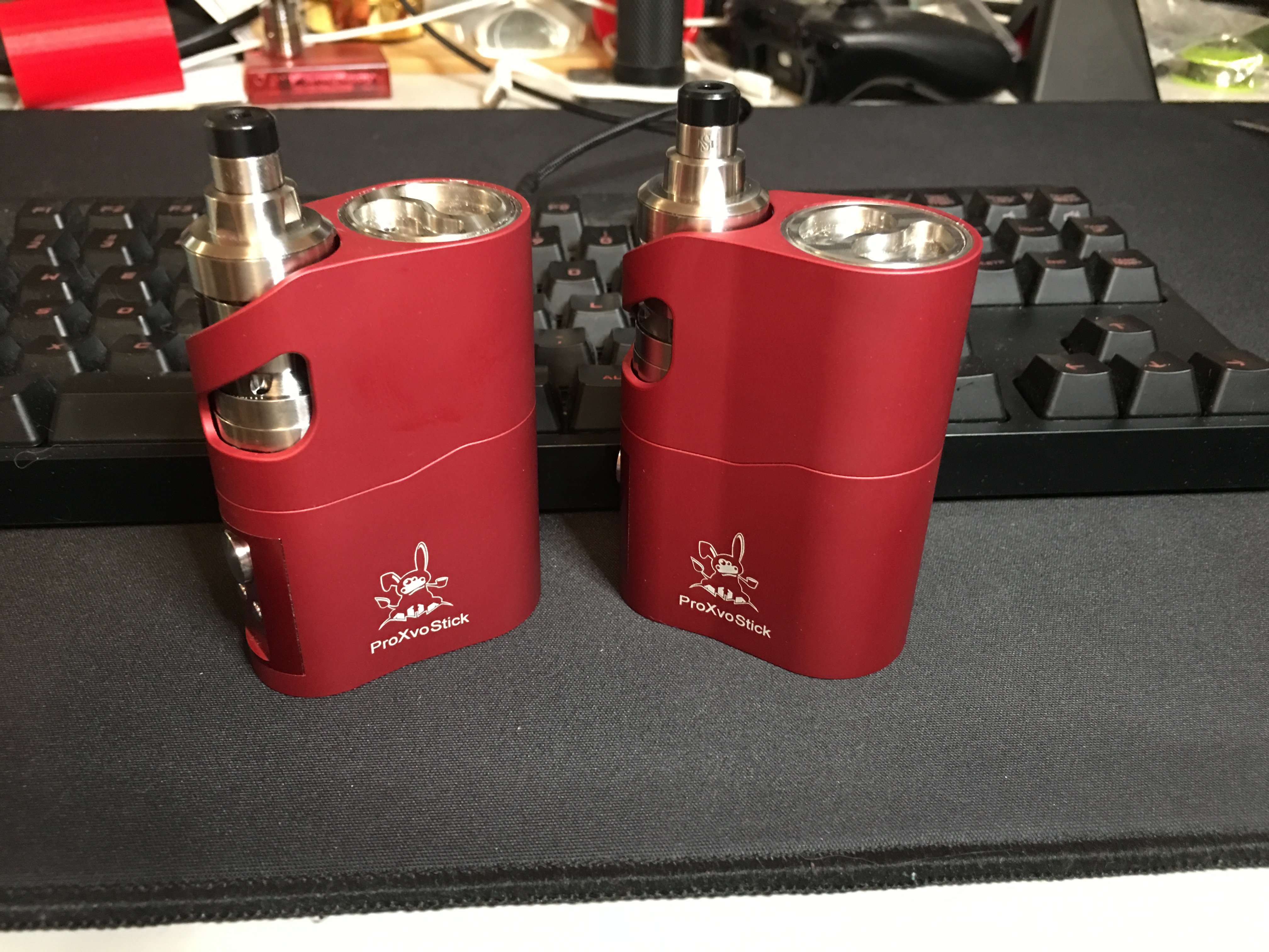

I was able to run the mod after cleaning the contacts, with out getting a low battery warning, but I was raising an eyebrow at the .5 volt drop, which lead me to investigating. I also did some more scrubbing on my other one, and I was able to get the other one's voltage drop down to 0.36, with the same cell. They are both wired the same. After looking at both of these as in-depth as I have, I think I could probably get the Voltage drop lower, by Adding a ground point between the 510 and the upper case, and re routing the battery negative to directly attach to the upper half. Both mods that I will do when I get access to my tools again.
704036967_2021-07-2121_52_24-InquisitorTabitha-Discord.png.26447ffac7da9a1008b7b3d59be26d52.png

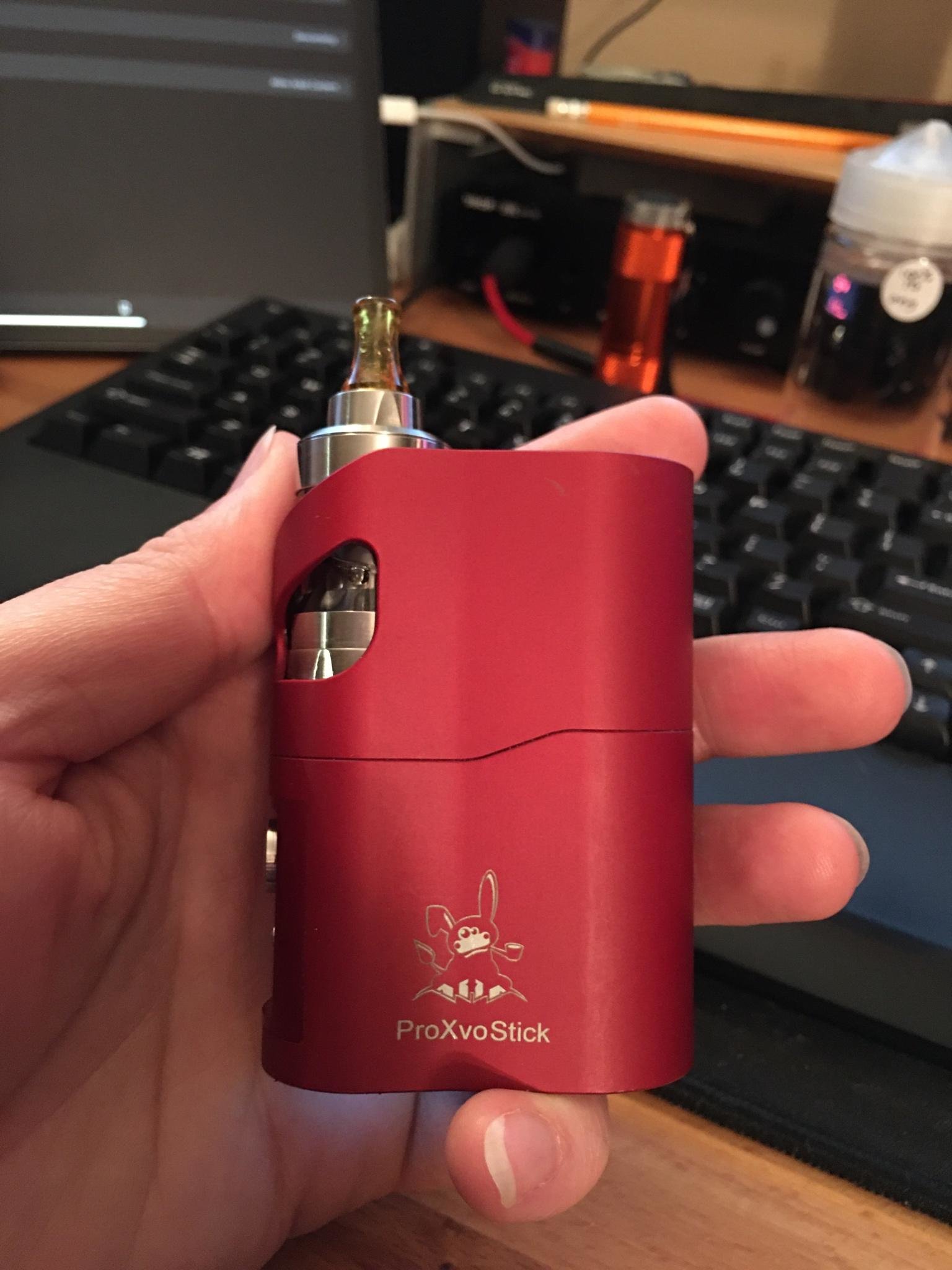

Here is a couple more beauty shots, from when I converted them to DNA 60's for ya. ;)

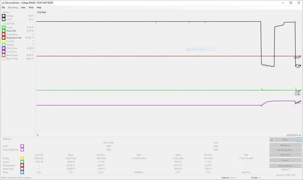

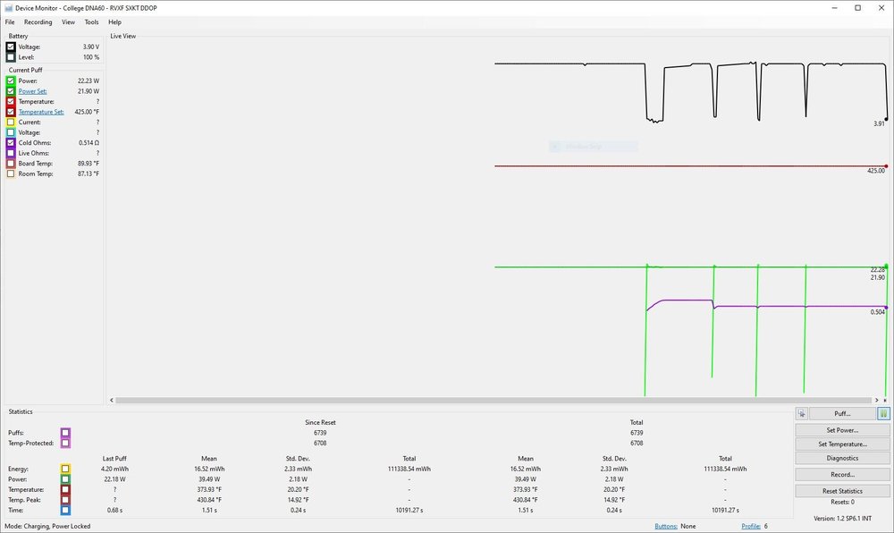

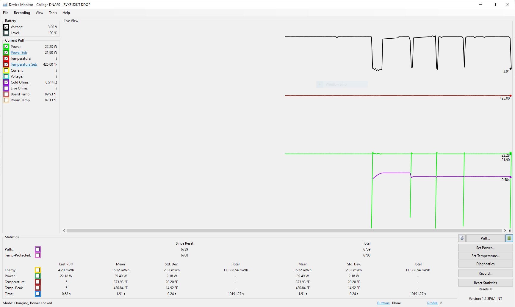

Here is a couple of screens of my Dovpo College DNA60. Of all my 60's it has the most voltage drop which I contribute to the limited contact between battery cap and case.
The 1st screen is with a good Samsung 20S 30 amp cell.
The 2nd screen is with a LG HD2 25 amp cell that is weak from age and no longer used.
Your results should be better than my best results here, IMO.
Both cells were 4.19 volts at start.

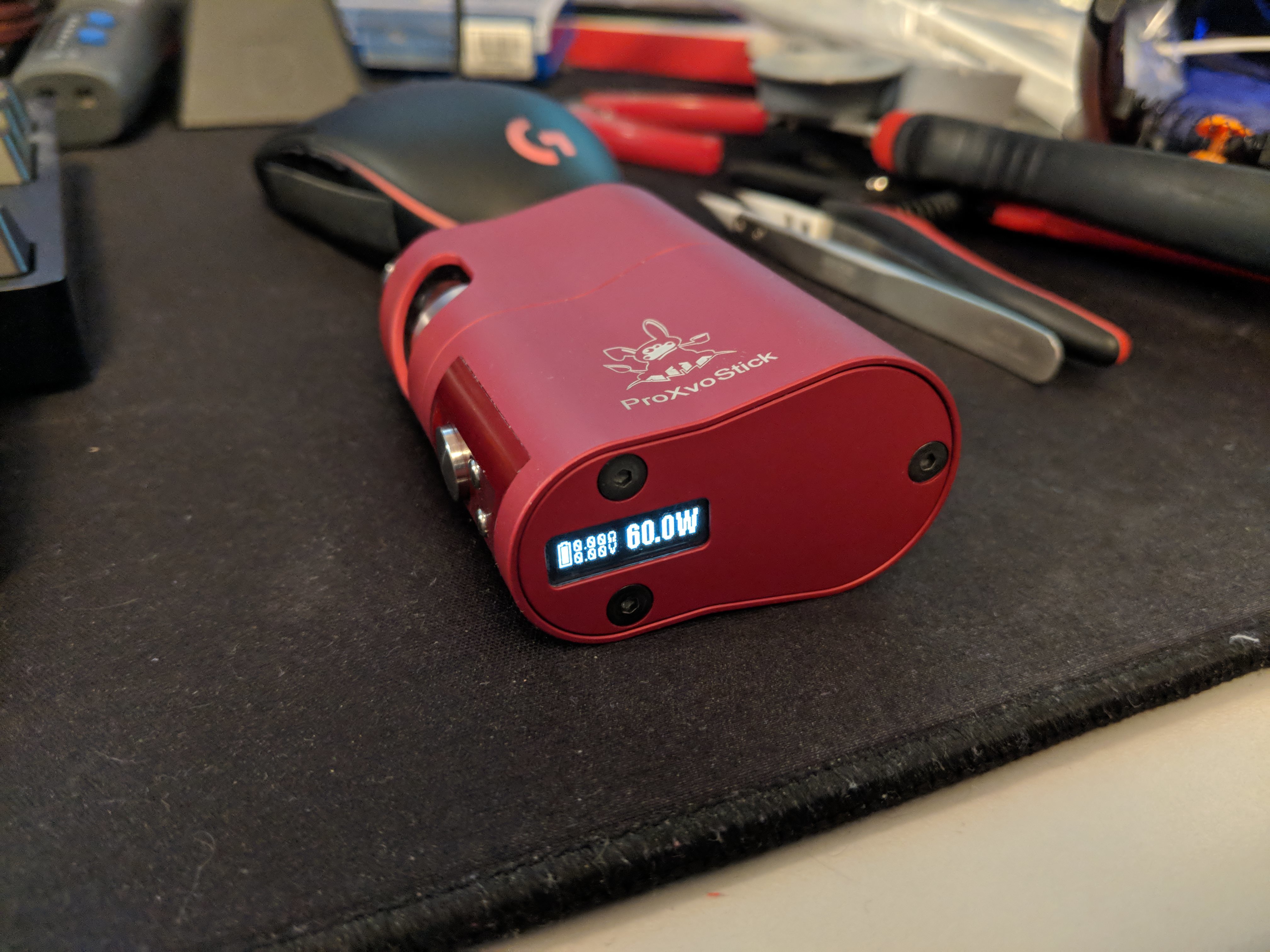

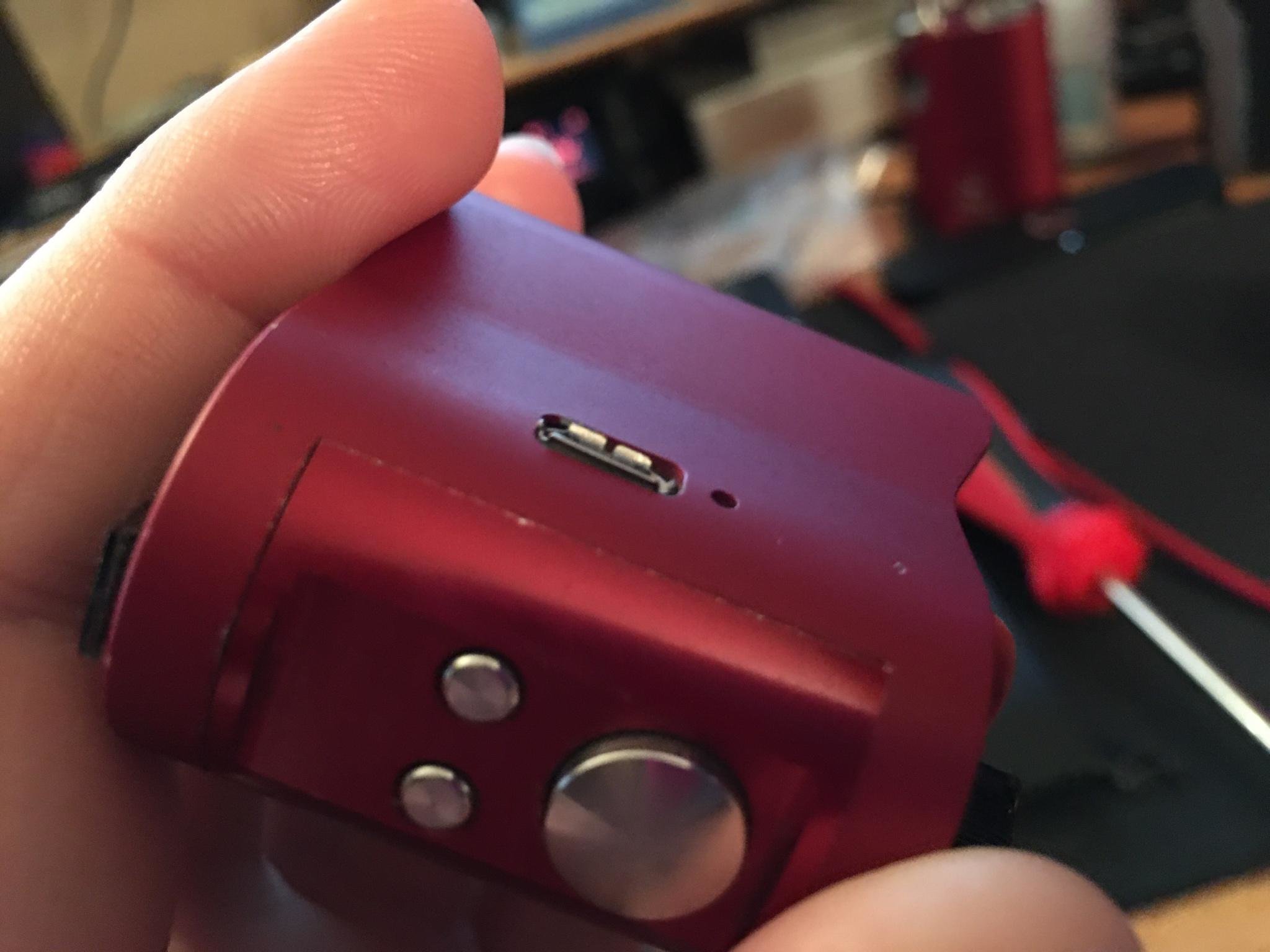

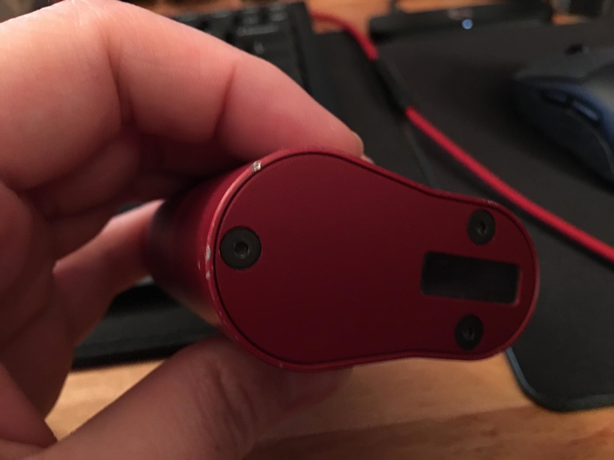

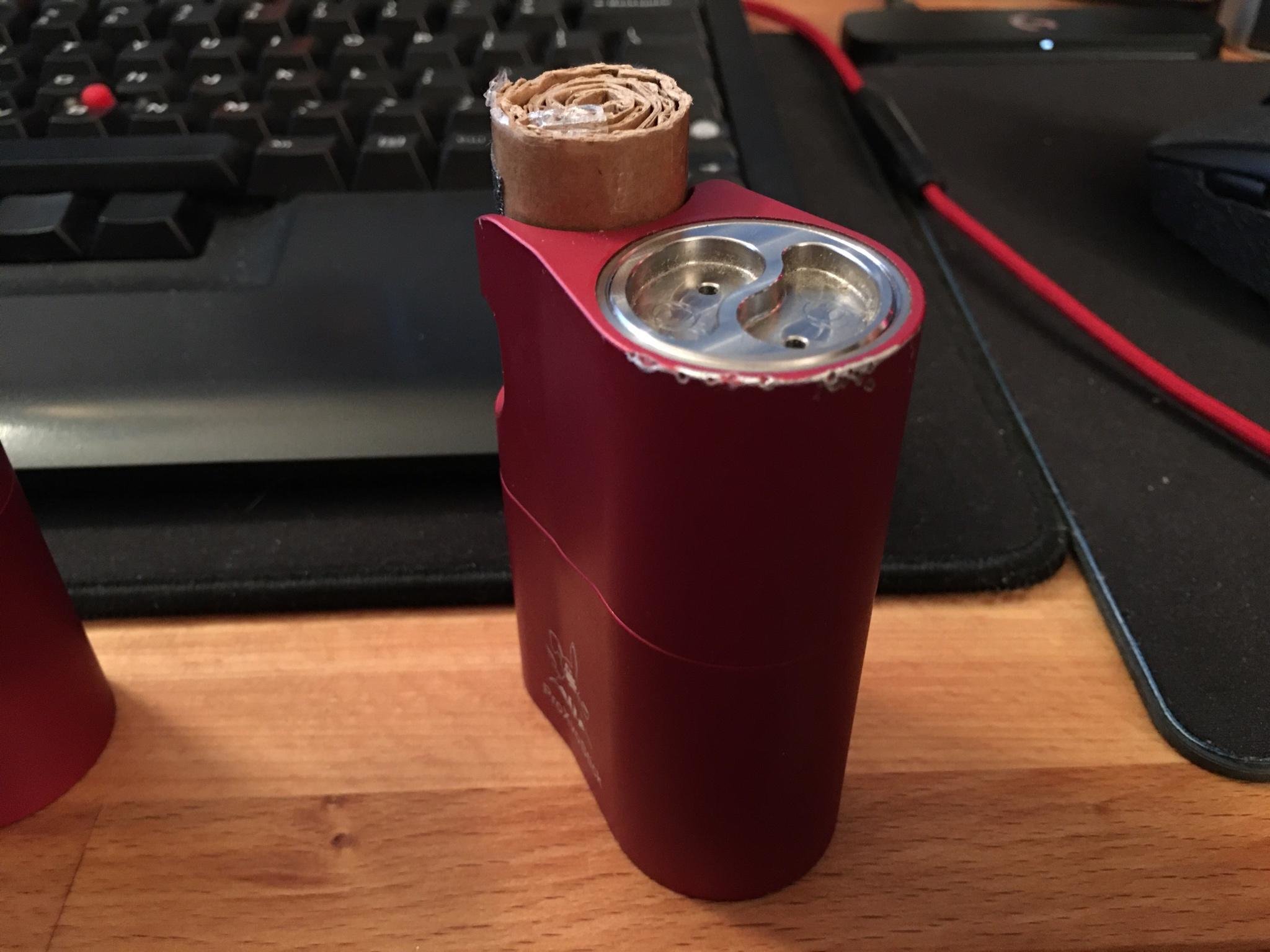

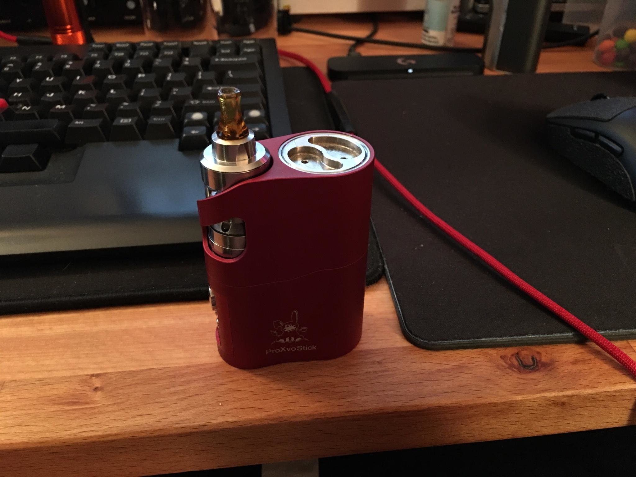

Couple of new pics:
The other one, tooks some fall damage, but it's still in pretty good shape, for being my DD, for about 2-3 years.
  • Like 1

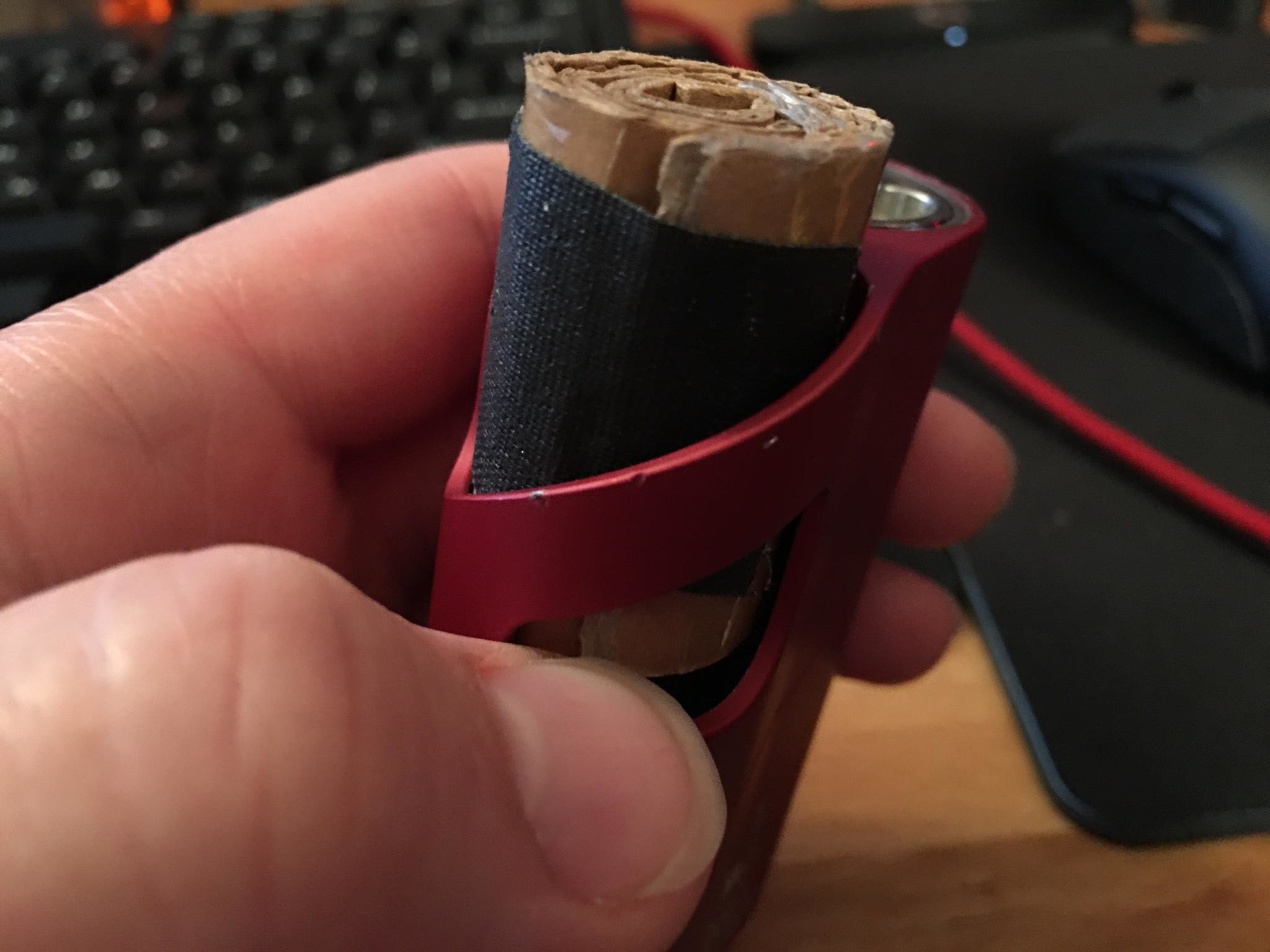

Posted
1 minute ago, dwcraig1 said:
Was there much trouble fitting in the larger charging/data board?
I had to remove the bottom mounting standoff that the old board screwed into. So the new charging board is only attached with one screw, but it is held in place by the micro USB port. so it doesn't go any where.
Old pictures, but they show the screw stand of that is still there. I'd try to get a better picture, but every time remove the button housing, it's like flipping a coin. I had to resoled those little wires a couple times, and repair some traces on the button PCB, due to pads lifting. I wish the PCB was the same quality as the coating on the mod housing. Sadly, it is on the cheaper end of PCB's, that I have dealt with. Also, the cable that they used for the stock button wiring, was a PITA, It was very plasticky and it was a ribbon cable, so I replaced it with wires scavenged form a USB cable, that matched it's gauge.
Micro USB protrudes a little bit, but IIRC, it's about the same as the stock one did.
I also had to modify the button housing, to add extra room for the spring loaded 510, since it sat down a little bit lower.
